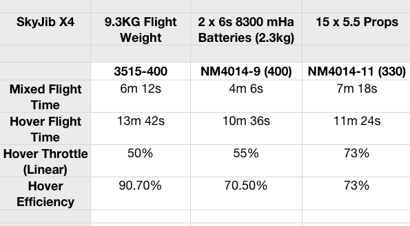

The T-Motor 3515 + the T-Motor 15x5.5 carbon props work great. The Props are much better than the wooden Xoar's. The NM4014 come in 2 flavours: MN4014-9 (400kv) & MN4014-11 (330kv) so I would only consider the MN4014-9. According to ecalc the MN4014-9 are less efficient than the 3515's when I did my calculations... But there's not much in it
The MN4014's do have the option of fixing the props direct to the motor without a prop adaptor... Which is a plus in my book...
I would always build big - better to have the system running at cooler temps for longevity and have power in reserve for if/when you have a problem...

This is what I based mine on... the NM4014-11 would be hovering at 73% throttle - Not good

Thanks i will drop him a line see where i can get. i see your X4 is coming in at 9.3KG (wow a bruiser) what sort of Flight time do you see on a pair of 8300 mAh 6's ?
baja-king
Here for the ride :)
I'm getting 9-10mins running the packs down to 25%
