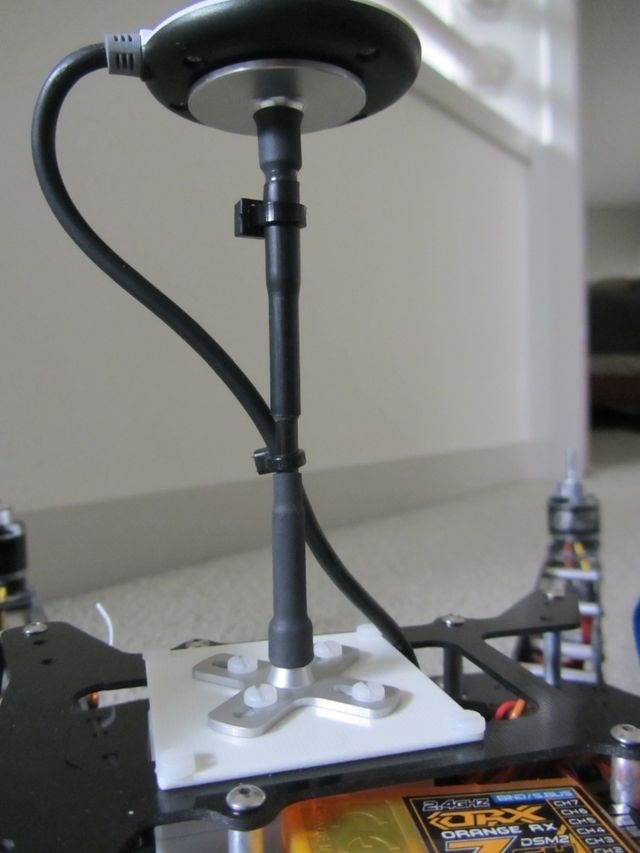

assembling the sensor mount and positioning
So first questions first:
How are you supposed to assemble the GPS/Compass mount? Epoxy glue the rod to the two supports and then use double sided tape to attach it to the frame ? which side of the mount goes where?
Also, pictures of the mount already assembled on the frame would be very helpful.
Thx
xtrmtrk
Heat shrink tubes are your friends. The holes in the supplied mounts are filled with foam. In a crash it will just bend over, not break.
Only problem is my GPS doesn't work. But has a great mount job!
