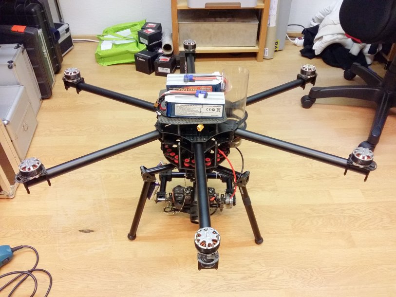

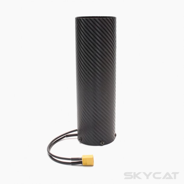

Parachute systems are not extremely heavy and don't create a ton of drag, whatever you mean by that. I'm building a new 85cm hexa with Skycat.pro parachute launcher and 4 square meter Opale parachute. The whole parachute system weights 400g (o,9 lbs) including the launcher, parachute and trigger. Flying weight will be around 8kg. I could use 6m2 parachute to achieve optimal descend speed, but even 4m2 will decrease the impact energy of the helicopter dramatically compared to free fall speed.. Doesn't require any explosives, gases etc. and parachute package shoots away from the airframe to avoid entanglement. Have tested it at low altitudes and it works even at 5-10 meters. My friend is using two 4m2 launchers on his 12kg Gryphon X8 and they already saved the heli once, when the FC decided to go crazy..
I personally think that parachutes are really needed for all multis, even the small ones, and it seems like people who are against parachutes have never seen anything fail (yet). I've been flying for 10 years and seen so many devices fail that it's just nice to have some extra security onboard :)
