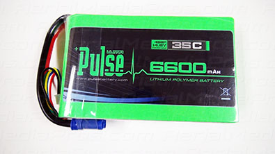

My first big concern occurred to me today. I think the battery I received is too big and heavy. Not power-wise. I think it's weight and dimensions are over the top. It will be okay if I mount it to the bottom plate underneath the craft. But then I believe I won't be able to also mount a GoPro underneath the craft. I've decided to get the batwings landing gear. But just to clarify, I'm not even going to start researching camera mounts before the craft is flying reliably after many test flights. If I mount the battery on top, I think it will make the craft too top heavy and cause too much strain on the motors. Solution would be to get smaller and lighter batteries to mount on the top. I don't know as yet. The battery is so wide that it covers most of the top plate beyond the slots for the battery straps. The battery is too heavy to mount underneath without fears of it coming loose from its own weight.
Any thoughts? It's my first thread-starting question.
Rob
RobertsUp
which lipos do you have rob? and when doing my first 550 build i found the videos at Aerial Media Pros super valuable. You will find they will help with 450 too.
bottom of the page- http://aerialmediapros.com/store/support.php?osCsid=5bb62k2toleldk6vtphp059r77
Hi, hjls3,
I bought my LiPo's from Aerial Media Pros. (AMP)
They're the 4S 6600 mAh.
The batt is shorter and wider than others. Its almost as wide as the top plate. So the battery strap would have to go around the whole top plate.
Doesn't matter if I ought not continue with them. I can just keep them for a future build. I've seen every video made by AMP.
Edit: I checked again and now realize the battery is too big to be carried on the top. There would be no room to affix the gps base. So I guess my first question has changed. With that big battery velcroed and strapped to the bottom plate, is it still possible to mount a GoPro somehow?
- Rob

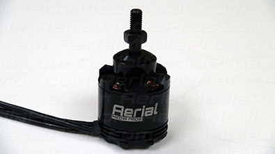

The motors are 2814's 770KV They weigh about 139 grams. 560 grams for four motors.

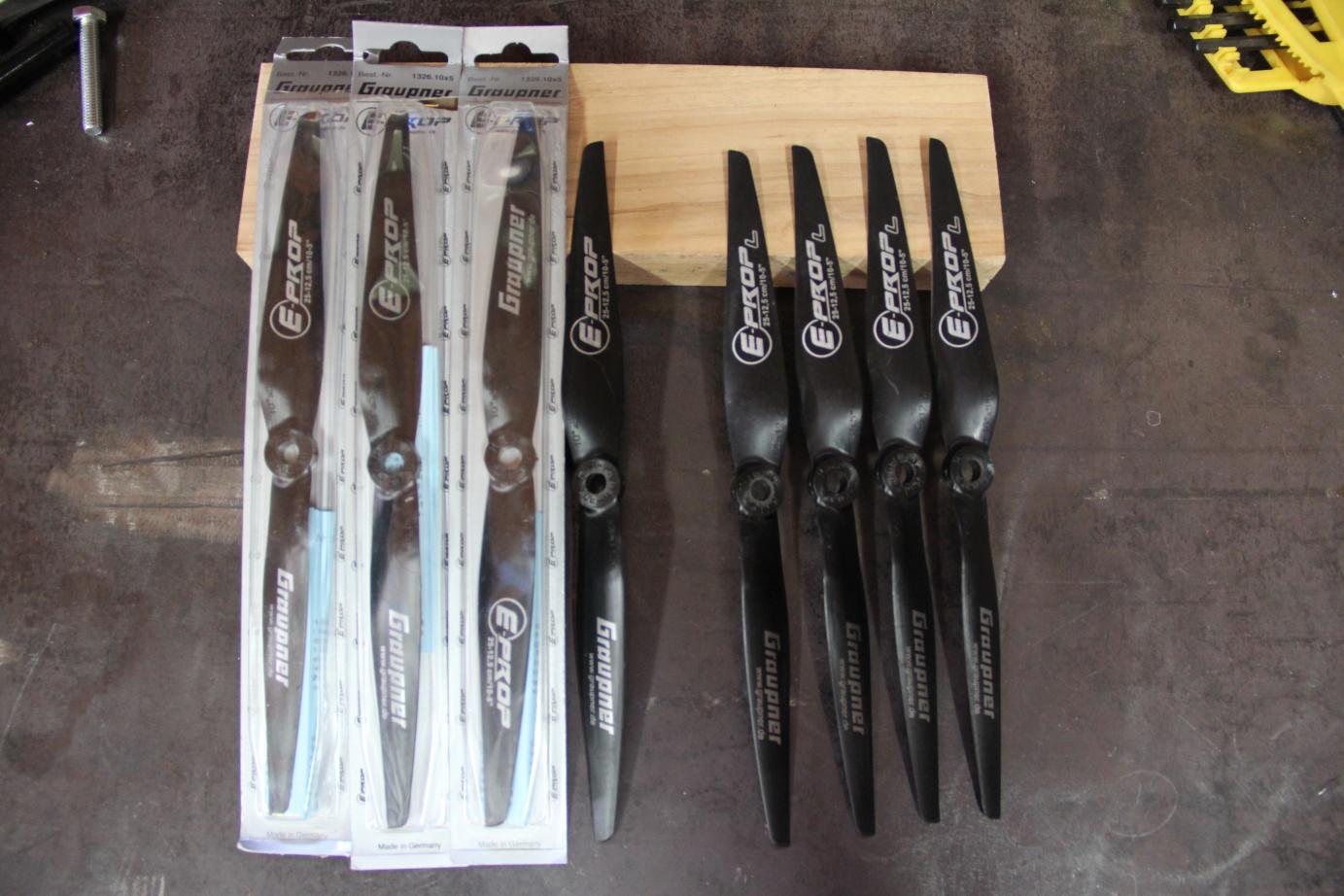

I aleady have Graupner 11 inch propellors. The arms will have the extension plates to accommodate them.
