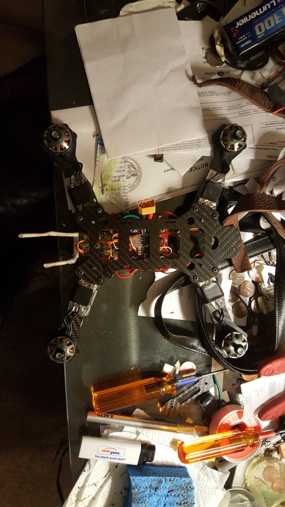

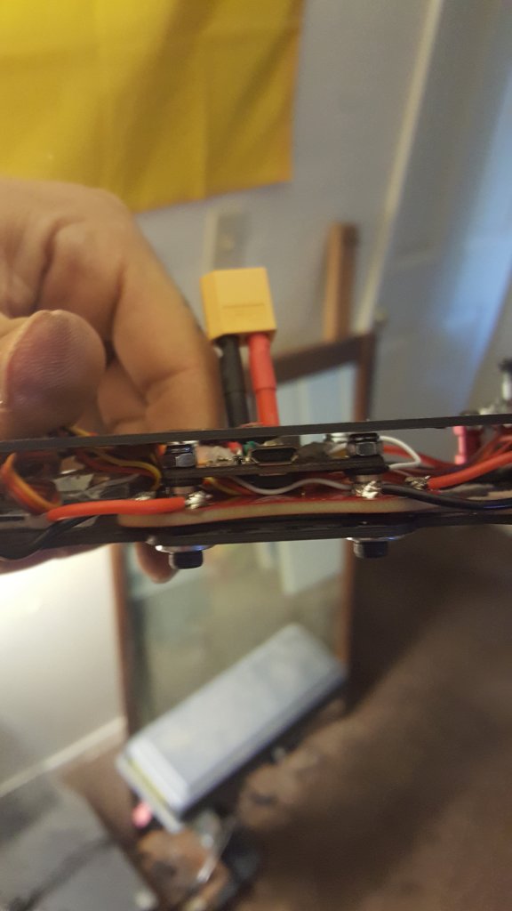

Some of the pictures I got
I mean it may be a hardware issue inside the flight controller, but I think that is a great idea to switch to that frame. A friend of mine has one of those falcon 250's and it is a pain to work on, and generally sucks.
