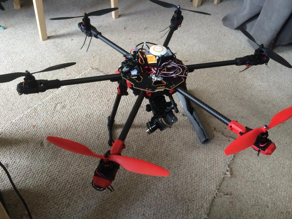

I've just built something pretty similar, but I'm finding myself disappointed by a couple of things. I've been flying with a 3S 11.1V 5000mAh battery and I don't seem to get three minutes in the air before the Naza insists I land and replace it, which seems pretty weak.
Under my drone I've got the battery holder* and a DJI H2D2 gimbal / Go-Pro, so it's not light.

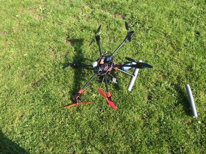

I have had a couple of surprise crashes though; first in pretty normal flight some distance above a pebbled beach (Brighton UK), ever since which it has flown pretty erratically, leading to crashes. It just keeps spinning right and drifting as if it wasn't calibrated, but re-calibration didn't fix it.
I'm guessing it's also been vibrating a bit as one of the motors came unscrewed in flight and it plummeted, so I figure balancing the props might be a good move – I'll order a balancer – but I don't think that's what was causing the rotation. Any thoughts?
Here it is after my latest repairs and before.
View attachment 18423View attachment 18424

I think you'll have to take a look at balance for both props and motors. Once you get your prop balancer - make it a point to never install an unbalanced prop. Everything will be smoother because of it, and it helps narrow down causes without pulling your hair out. What props are those??? Are they plastic? You really are going to want some decent props - for easier balancing and so they don't come apart in the air (happens, I've seen the photos!).
If you had a pretty serious crash (pebble beach can't be soft!), check the level of the motors in relation to the flight controller, to ensure the motors/FC don't have to fight to keep the craft level. The booms or motor mounts could have turned a bit in the crash.
Im assuming since you have a H3-2D that you have a DJI controller? Make sure the GPS arrow is pointed straight ahead.
Also, I think for a heavy MR like this you'll probably want to head up to 4S batteries - or if your ESCs can handle it, 6S.
Good luck.

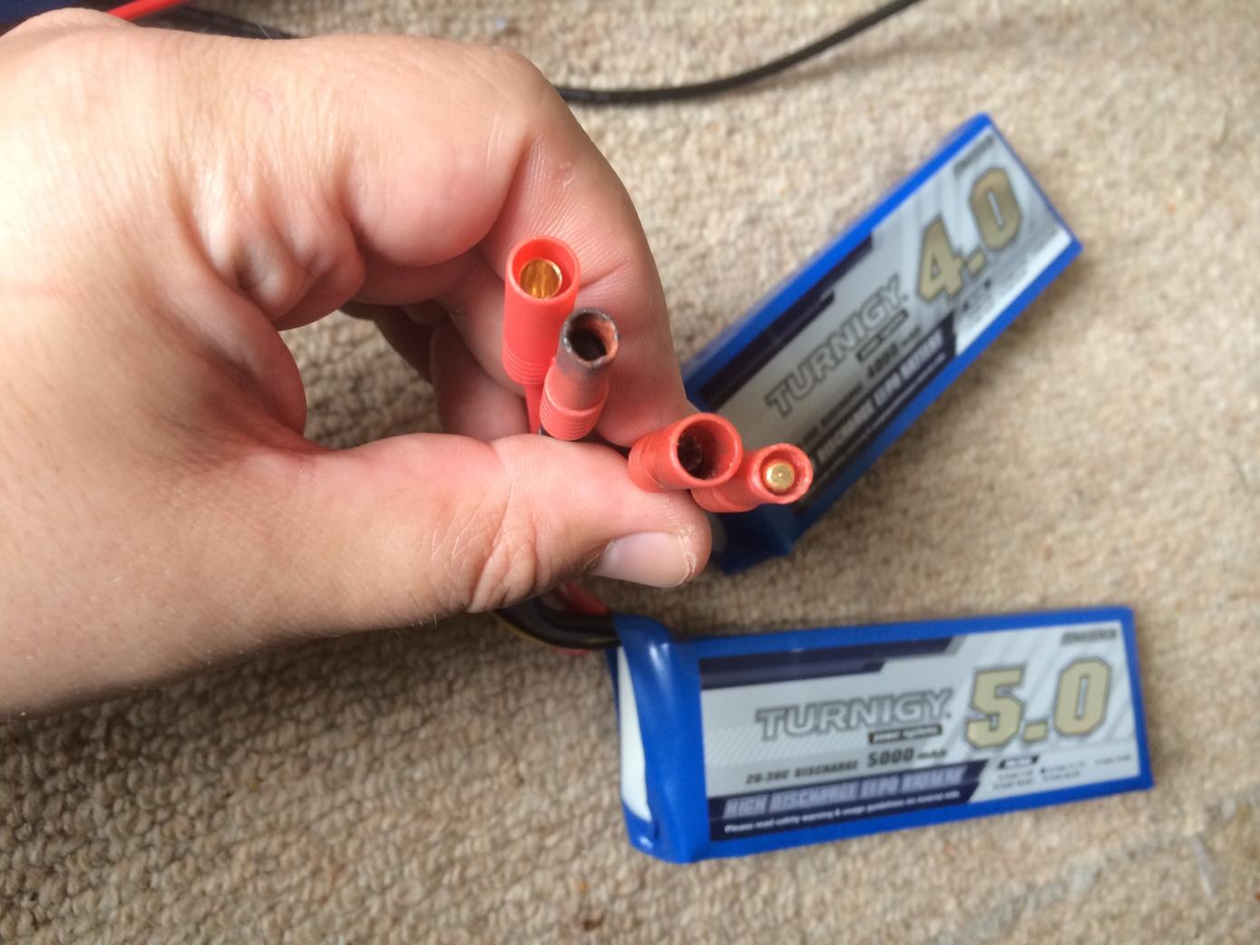

OK, well I was already to go test and I thought I'd quickly connect to the computer to make sure the calibration was still good, and [Flash-BANG] horrid electric smell – short circuit(?). A further look at my crash battery and lo-and-behold it too has a melted connector.
I can't immediately see why, though there are a lot of wires hidden inside the arms. I'd like to test one by one.
Any way I can easily test for this issue before connecting my last battery? I don't want to melt it's connector too!
Arrgh - it's all so frustrating - it was flying so well a couple of weeks ago!
Oh, props are 10" 4.5s. Thinking that I was sold the wrong motors; what'd be the best I could add without swapping the ESCs?

I don't think there's an easy way to test the continuity of the full run (PDB to motor) of wire in the boom unless you can get a multimeter lead into where the motor wires connect to the motor. But you can test the ESC wires though. Put the multimeter on ohms and connect to each end.
Is the battery puffed? Probably safest not to use it, even with fresh connector. Try to take a look inside the power area (between plates) and see if anything is touching?
You our have plenty of options with the motors. Lots of people running the lower Kv SS on these hex's - like 7xx and lower. Not sure about the 3S compatibility though. You'll have to check the specs.
