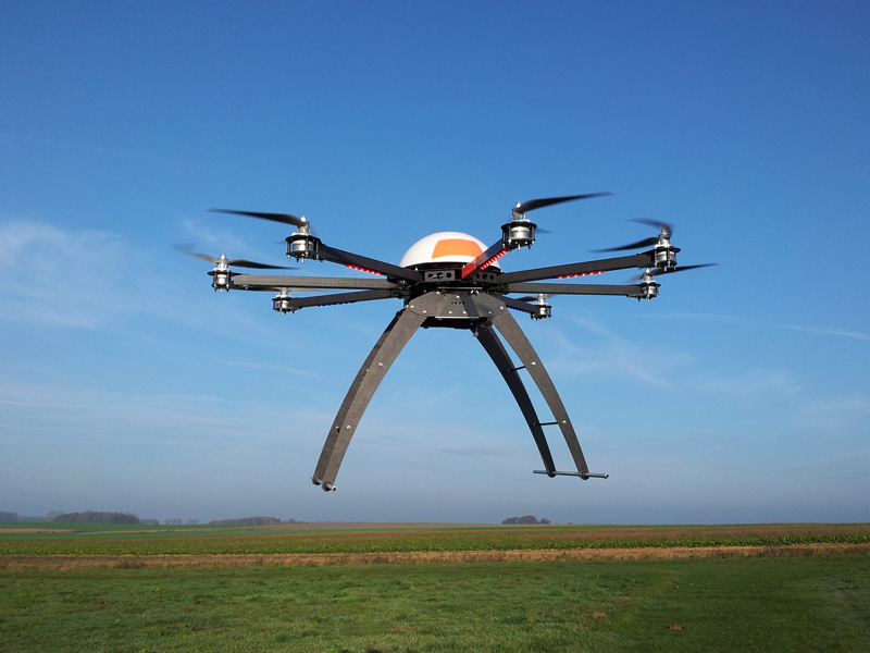

Just got my new Octo (allmost) in the air today.
This is my equipment:
8 x MK3638
8 x Detrum 30A ESC
Wookong M
And a frame from altigator, wich is not at their site yet.
My problem is that it is very unstable, and will tilt to one side or another when I try to get it in the air.
I´ve tried to set the roll and pitch gain from 80 % to 400%, but it seems like there i no improvement at all. I even managed to flip the entire octo on its top, and destroyed a motor,AND the ESC when tested after the crash (luckely nothing happened to the frame or gps sitting on its carbon rod (Its strong!!))
I have tried with and without expo, but same problem..
Can anyone tell me what I´m doing wrong?

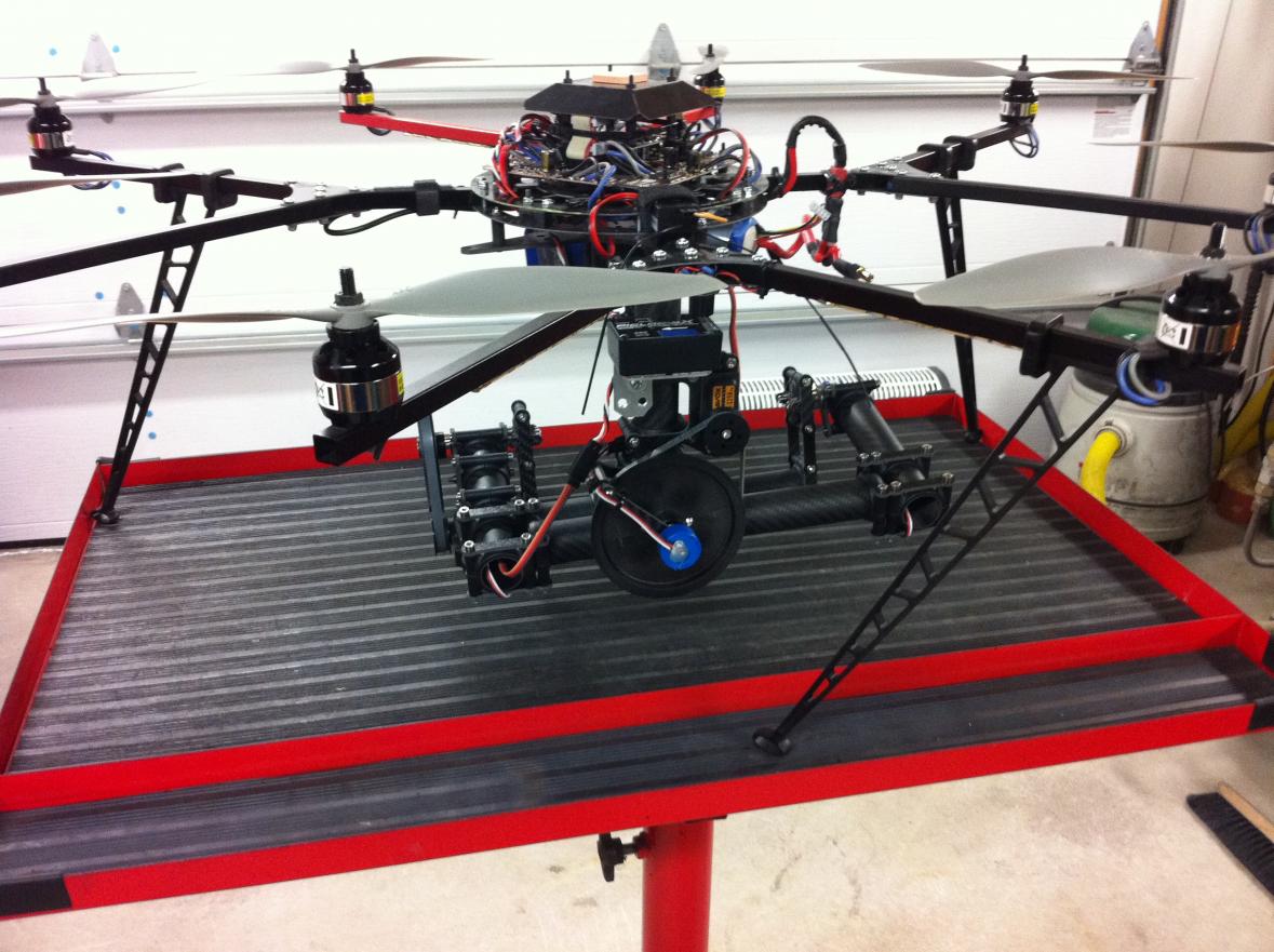

It must be said, that I can control both RC planes and helicopter normally without problems - the octo in the picture is not mine, but from altigator.

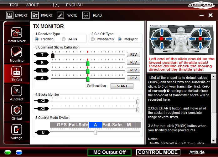

The COG wont really make it want to tip over . Maybe post a video of your set up inc the TX calibration screen and move the sticks so we can see everything is moving as it should be .
You also need all the TX channels to be green and in the centre . Apart from throttle which should be at the far left .

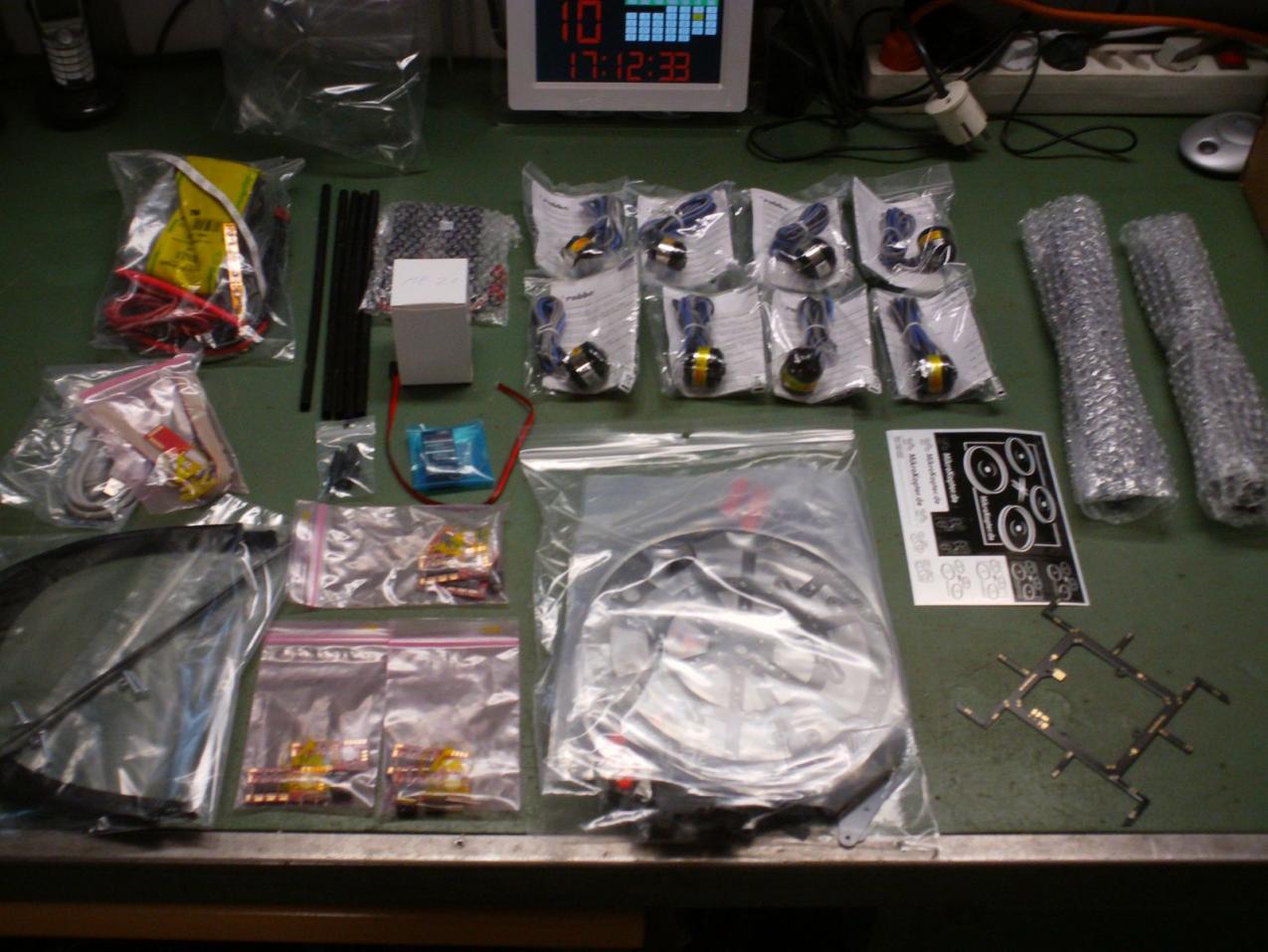

munk just post everything you can give us.

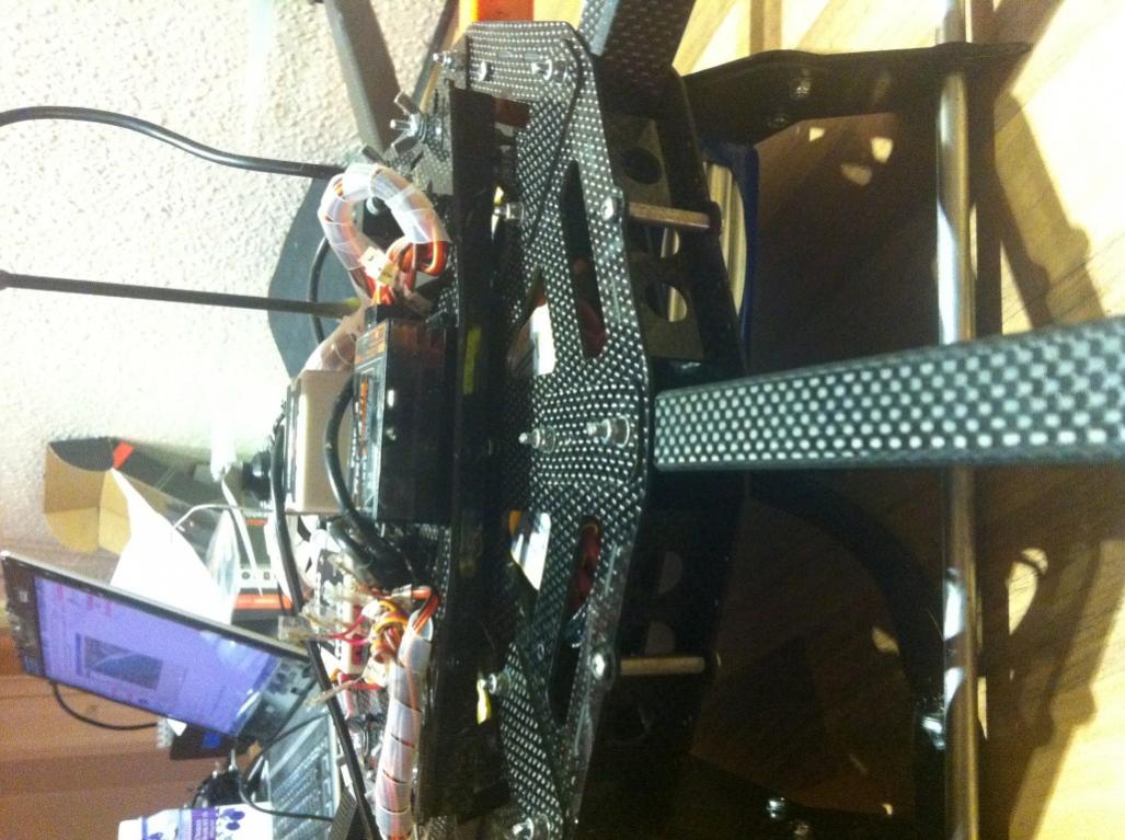

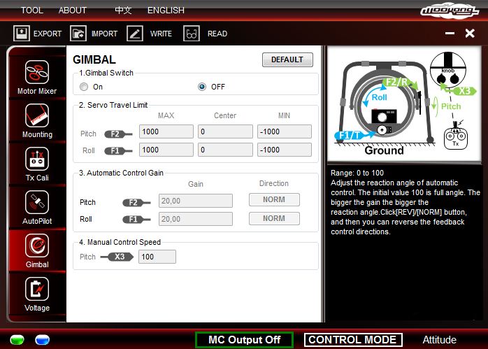

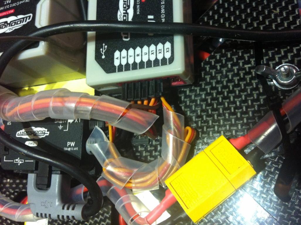

Pcis on the components places on the centerplate !
Screen shots of your configs at the moment.
Otherwise all tried to help you will continue to be a guessing game !
Boris

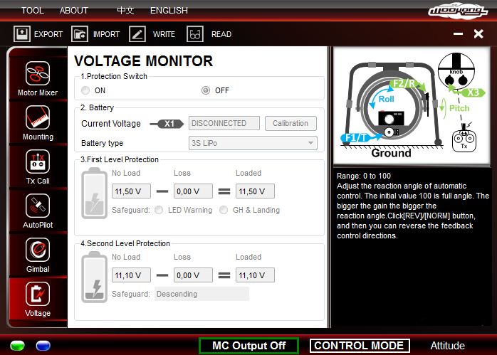

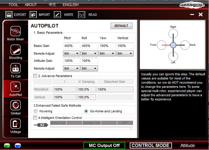

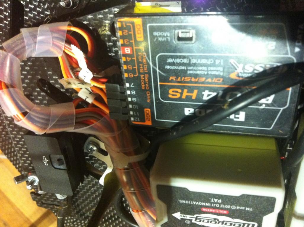

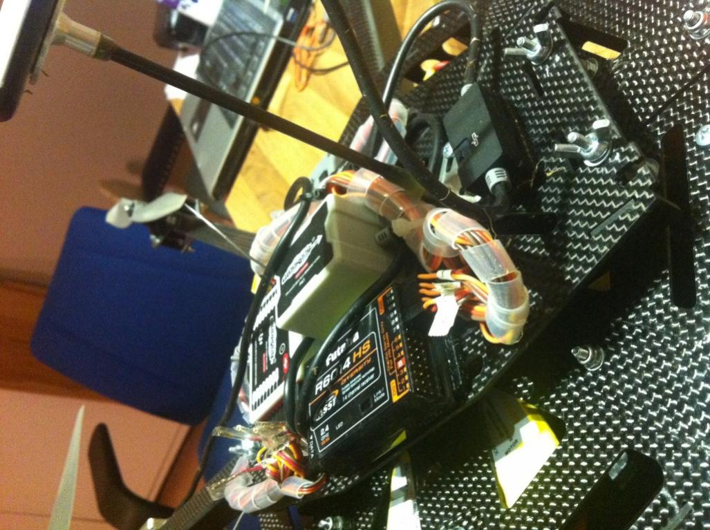

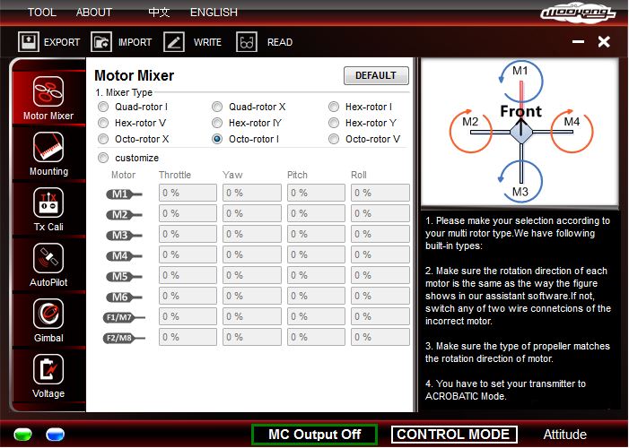

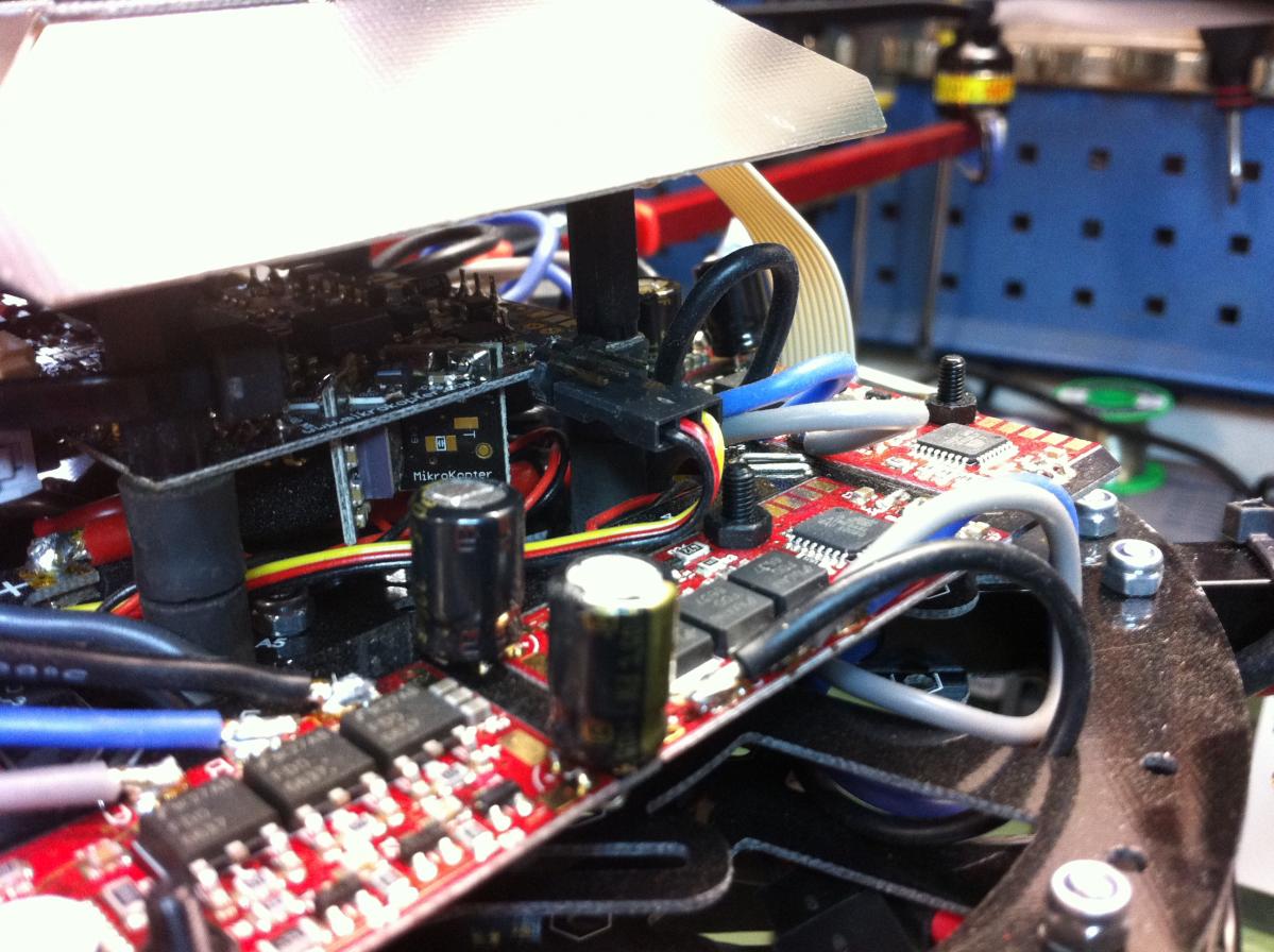

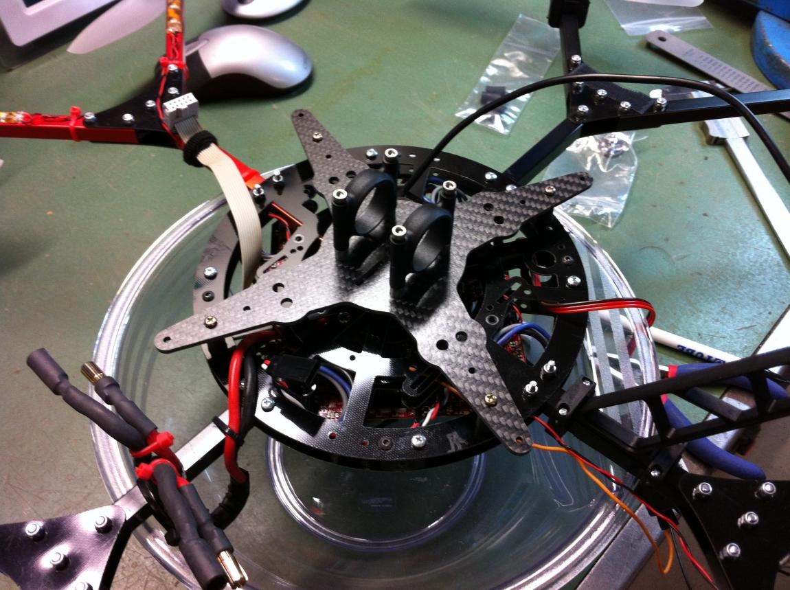

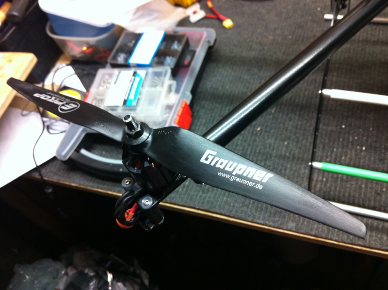

Muunk
Stevey
Do you think maybe the GPS antenna is mounted to close to the main electronics & is picking up interference it would be better mounted out on one of the arms, I did have the same problem with flipping myself, moving the antenna sorted it.
Just a thought.
