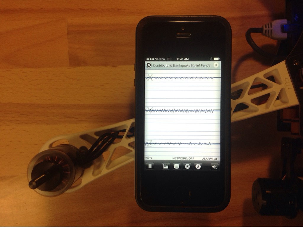

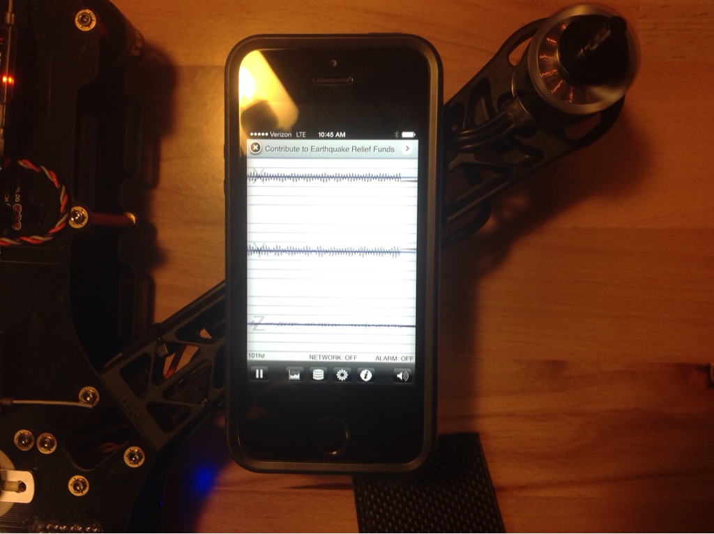

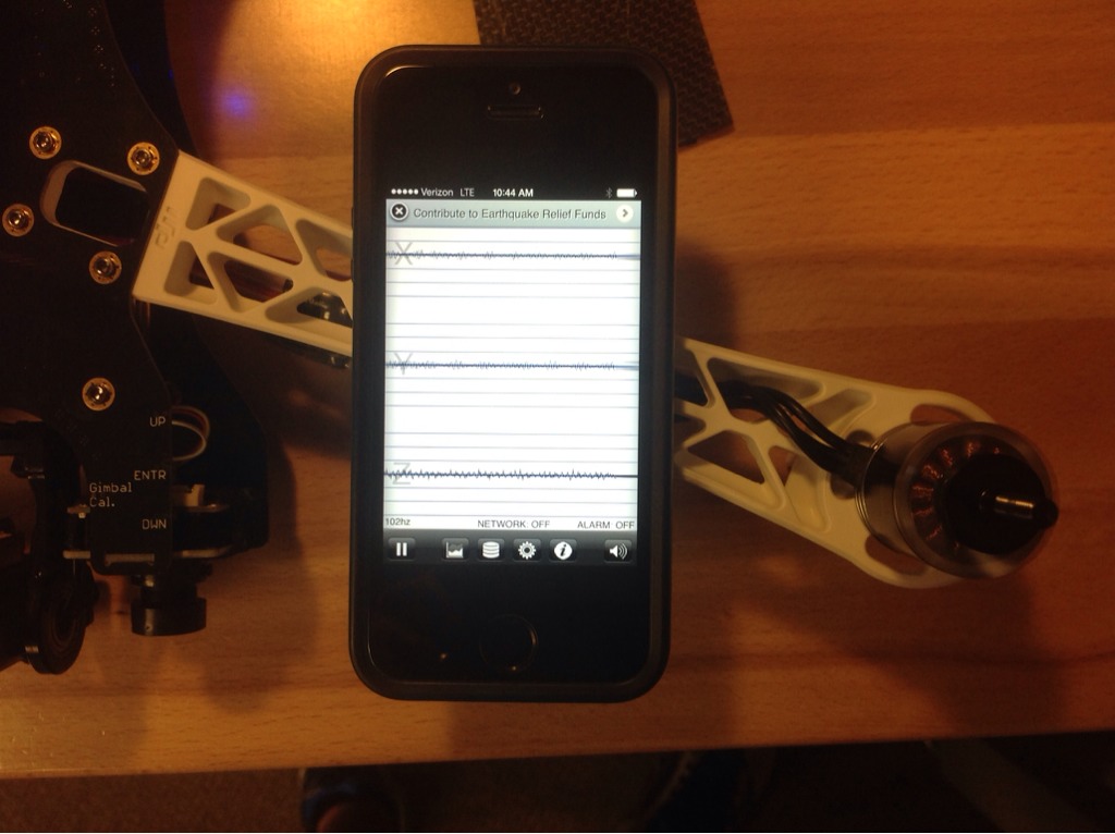

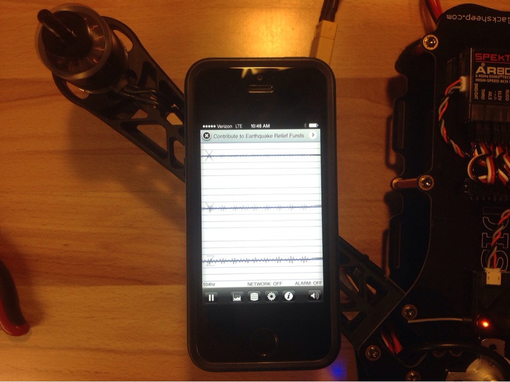

Just did a few tests and nothing seems unusual. If I really try had to feel something, arm #2 may possibly have a a slight amount more that others but it would really be stretching it... So much so I'm not sure I'm not grasping at something that isn't there. Here are a few pics from the seismometer on my phone... Apparently the angle of the phone. May effect the axis reading

are you catching the part about revving the throttle up and down and feeling the full range of throttle for vibes in each one..... that's pretty big deal to feel anything there. if your showing a static picture it leads me to believe that's all your looking at, a certain rpm...
