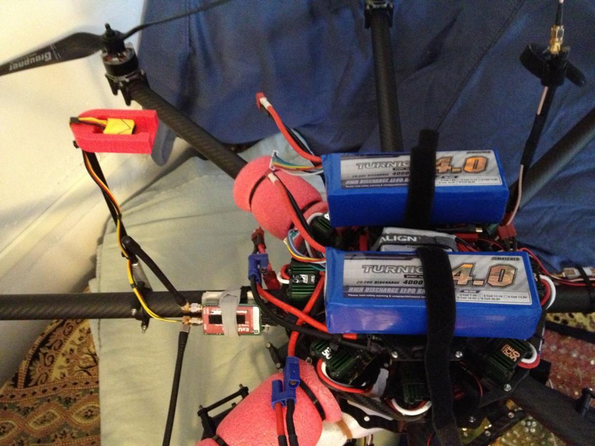

I re-calibrated with a friend helping and I'm still seeing the compass go crazy like before. It basically lags the reading then jumps to it. On a fast ascent and FFF it spun from 15 to 153 with no heading change of the copter. Not sure if it's really applicable to this topic and I have a support ticket too. Here's my setup-

If possible I would move the video transmitter to the other side. Also make sure all SMA connectors to antennas are tight. The external magetometer wires going under the video transmitter is probably not a good idea. Just a few suggestions.
yeehaanow
My Vid Tx is on the other side. You can just see the antenna on the far right of frame. What you see there is the RC rx. (EzUHF) it doesn't transmit, only receive so I thought it was ok.
workshop
The EzUHF 8 channel receiver can also be configured to transmit although the designers have not implemented this feature:
From the v1.18 Manual:
"8 channel, bi-directional, with Antenna Diversity
This is our high-end receiver, which has the hardware support for a bi-directional link (NOTE: Firmware support for this will be added during the Summer of 2010)"
I've had better luck with the 8ch. Lite version of this receiver on crowded multicopters.
The 8ch. Is great for long range > 1-2 miles. I see that you have it set up for polar diversity but you may be flying too close to yourself to take advantage of that feature.
