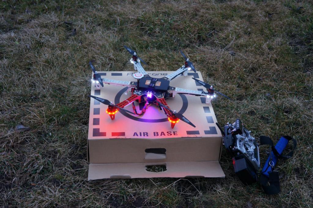

I finished this weekend a F550 with WKM in there and had a few test rounds last two days.
stable unit by now, only in GPS mode the Hexa does gear all times some 10-15 degrees left. Calibration of Kompass done several time, any idea how to solve?
Greetz Topper

BorisS
Hi Topper,
its looking like your GPS modul is point backwards and not forward could that be. There is a little red arrow on the gpd modul that has to point foward.
Boris
Topper
Hi Boris,
i decided to have red arms on backwards so my LED's are like card lights... white front red back. the GPS module does face forward and 95% straight to front with the red arrow. Kind of hard to make it 100%. GPS at it self is very solid, only issue is the Hexa does on its own move every time 10-15 degrees counter clockwise for whatever reason.
