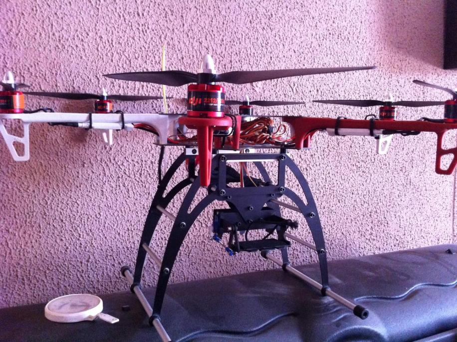

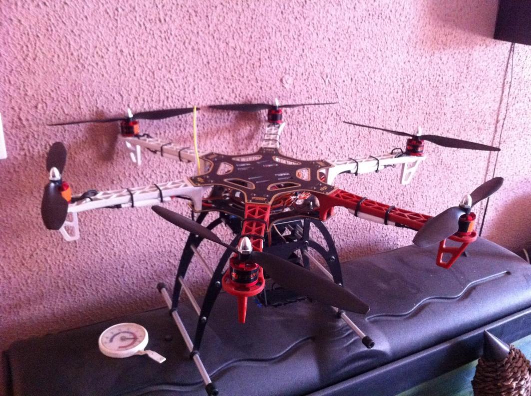

DJI NAZA F550 test in configuration of origins (propeller 10x4.5) with
GoPro Gimbal V.2 http://quadframe.com/collections/cm/products/g01k
Landing Leg http://quadframe.com/collections/fro...oducts/155mmll
2x 5000mAh 3S
bad servos for the GoPro Gimbal (it's there for his tremors) which will be replaced by digital was just a test

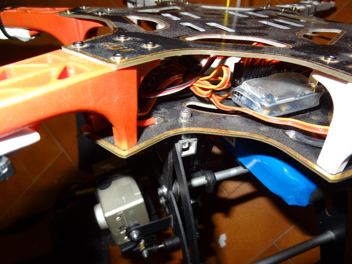

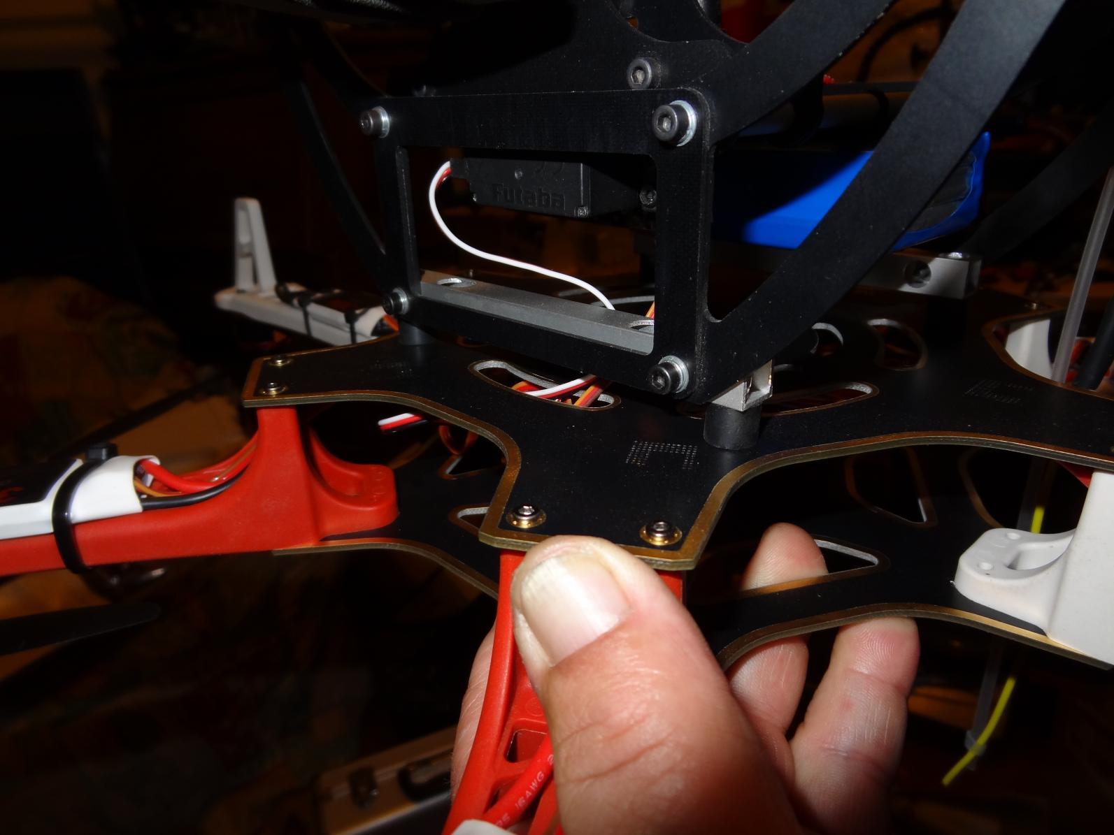

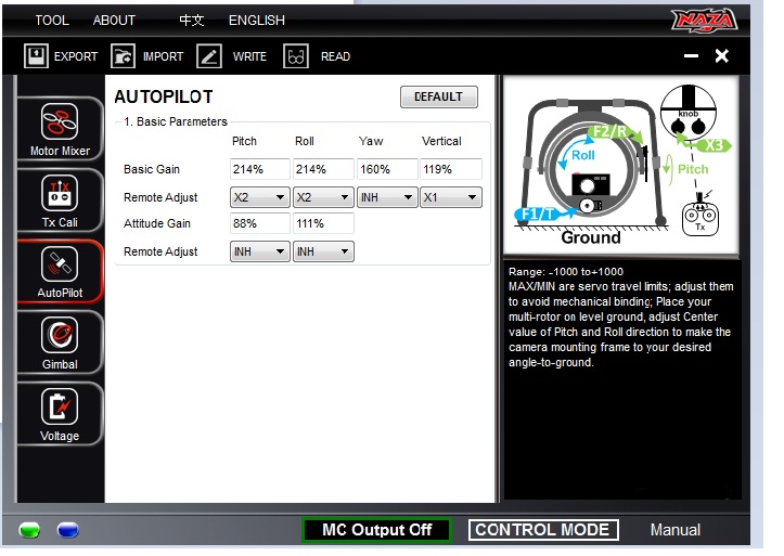

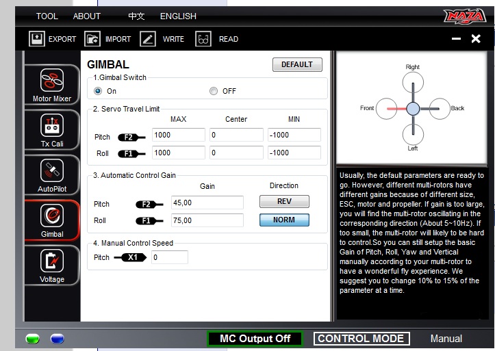

Drilling of the chassis to fix the train with four anti-vibration spacers M3x8 diameter: 10 http://mikrokopter.altigator.com/entretoises-antivibrations-m3x8-diam-10-p-40359.html

I made some modification on the gimbal
look at the pictures at the end of the video

Can you show where you have drilled the Bottom Plate, difficult to see on the video. Wich mods did you on the Gimbal?

Hi 9nene, i think your video is good, about anti-vibration spacer are you sure thay can support that wheight?
About gimbal can you better describe what kind of shocks you used?
Thanks a lot

Here aresomepictures
View attachment 3526View attachment 3527View attachment 3528
