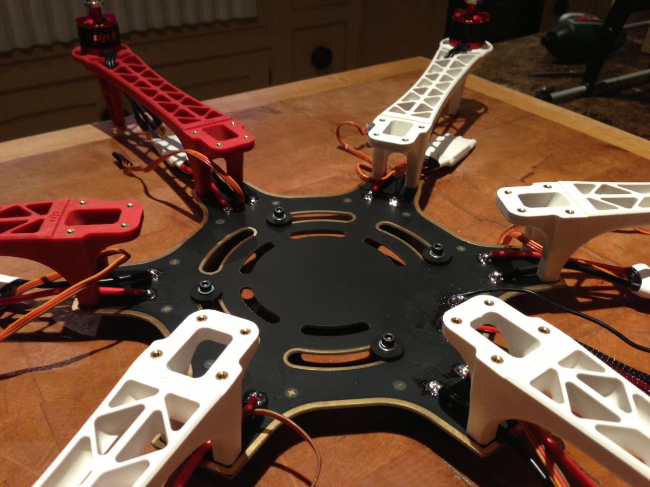

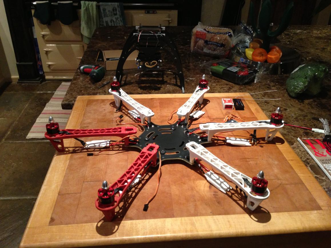

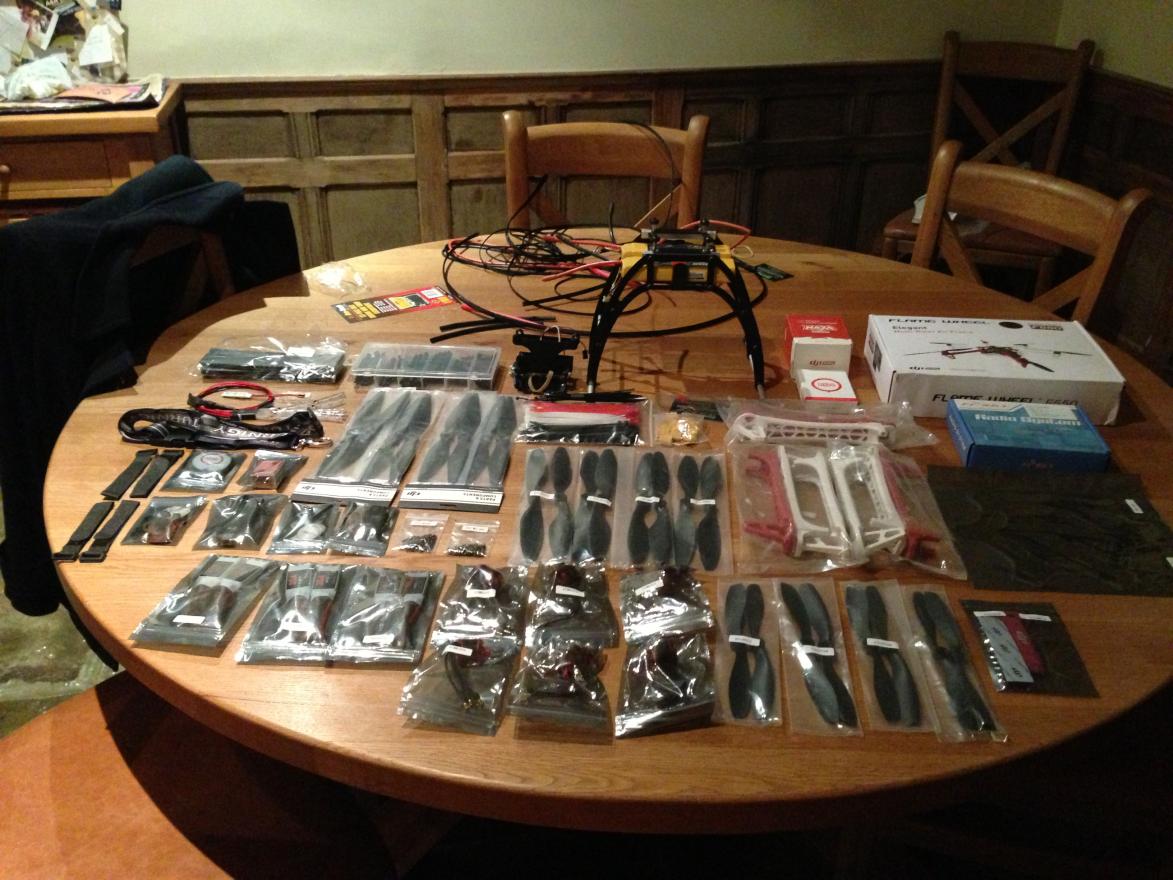

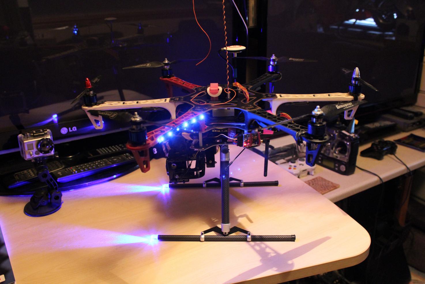

All of the parts for my first multicopter have arrived! All except for my Turnigy 9XR from HobbyKing :upset:
I have attached some pics of all the parts, and will post some more when I get around to building and flying it which will probably be next weekend (if my 9XR turns up!)
Here is my parts list:
F550 ARTF kit
(Stock Motors and ESCs)
NAZA Flight Controller
NAZA GPS
Turnigy Accucell-6 Charger
9XR Transmitter
2x 5000mAh 3S LiPo
FrSky Two Way Telemetry
9XR 2200mAH LiPo
155mm Landing Legs
GoPro gimbal
8x DJI NEW 10x38 Props
Lighting kit from here
Hope you like it :)
View attachment 9367View attachment 9368View attachment 9369

SMP
I like the combo landing gear battery tray! Nice!! Where did you find that if I might ask?

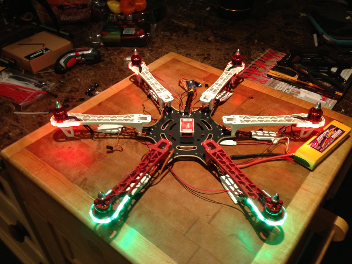

Edit: I would also recommend getting some of the led lights like I have on mine. Not only do they look AWESOME but they are meant to help with the orientation of the quad/hexacopter which is good for beginners like us! I will put a video up of them soon.
if you want some just search "DJI LED" on eBay!

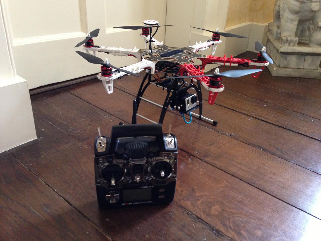

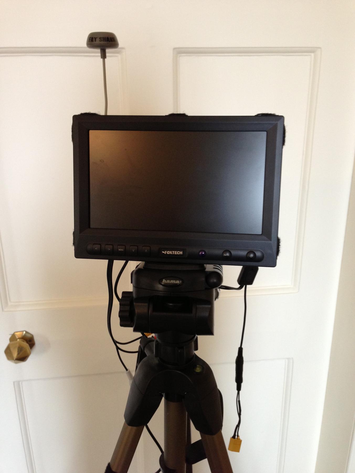

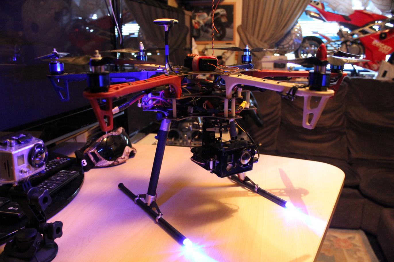

Thought I would give a quick update almost 2 months since the last!
The hexacopter is now fully assembled and I have flown it a handful of times (the weather here in the UK is terrible at the moment!)
Here are some pics:
View attachment 10534View attachment 10535View attachment 10536View attachment 10537View attachment 10538
Does anyone know where I should mount my video tx? It's not mounted yet and I think it needs to be as far away from the GPS as possible. Does the orientation of the antenna matter (can it be mounted upside down?)

I have the same setup as you do, and I mounted my 600mW 5.8 TX up on top, on the opposite side of my battery than the GPS unit is. So both on the top, just separated by the battery. No issues with interference and the balance is nice.
Good luck, looks good!
Charlie.
Thanks globalwad!
My flight battery goes behind the camera gimba on the landing legs so there won't be anything in between except the small 2S LiPo for my video Tx. Should that still be ok? I have plenty of space up there because of having my battery on the landing gear so it can go pretty much anywhere on the top plate :) The weather here in the UK is terrible at the moment and so haven't flown it FPV yet! Had 5 days of rain and 20mph winds!
Thanks,
Charlie
globalwad
It will be fine, yeah. The battery on mine is not providing anything with regard to help with interference between the two, just using it as a reference point to visualize the distance between. I was thinking mine might be too close originally also, but no, all good.
Charlie.
Oh and does the receiver antenna interfere with it in anyway, because my receiver antenna is sticking out of the top plate opposite the GPS module so the video tx would be right next to that.
Charlie.
My radio (and receiver) are 2.4ghz and my Vtx is 5.8Ghz like yours. My receiver has 2 antennae coming out of it. I think one's for telemetry (which I don't use) and one's for the main 8 channels). One of them I have sticking out of the top plate and one is running down an arm. I don't know which antenna is which though!
