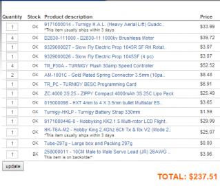

I checked all the parts from the Oddcopter blog on HK and it came out to $237. The frames are within a few dollars of each other so Im not real worried about that. All the parts i looked up from HK came from their US warehouse so shipping shouldnt be a huge issue. If you guys have another site you like to shop that you could direct me to i wouldnt be opposed to looking there also. Basically the Oddcopter blog rig comes out within $10 of the HK kit build and i think you get better stuff if you piece it together your self (i would swap out the props for the nicer ones that were suggested above). I think i would go with the f450 frame and then use my 3d printer to print some tall legs for it when i put my Gopro on there. I guess my real question is does this list look ok? Will everything work ok with the rest of it? what kind of flight time can i expect(I looked at ecalc but im lost on some of that). I guess if you guys would just look the list over and say "that should work" then im good. I just didnt want to buy a bunch of stuff and then figure out after much frustration that im not going to be anywhere near where i wanted to be. Attached below is a screen snip of the HK cart for parts (I would still change out the props and frame). Thanks guys...I know how it is with a new guy and all kinds of questions. But I really do appreciate the help before i jump in here.

That seems like it should work.

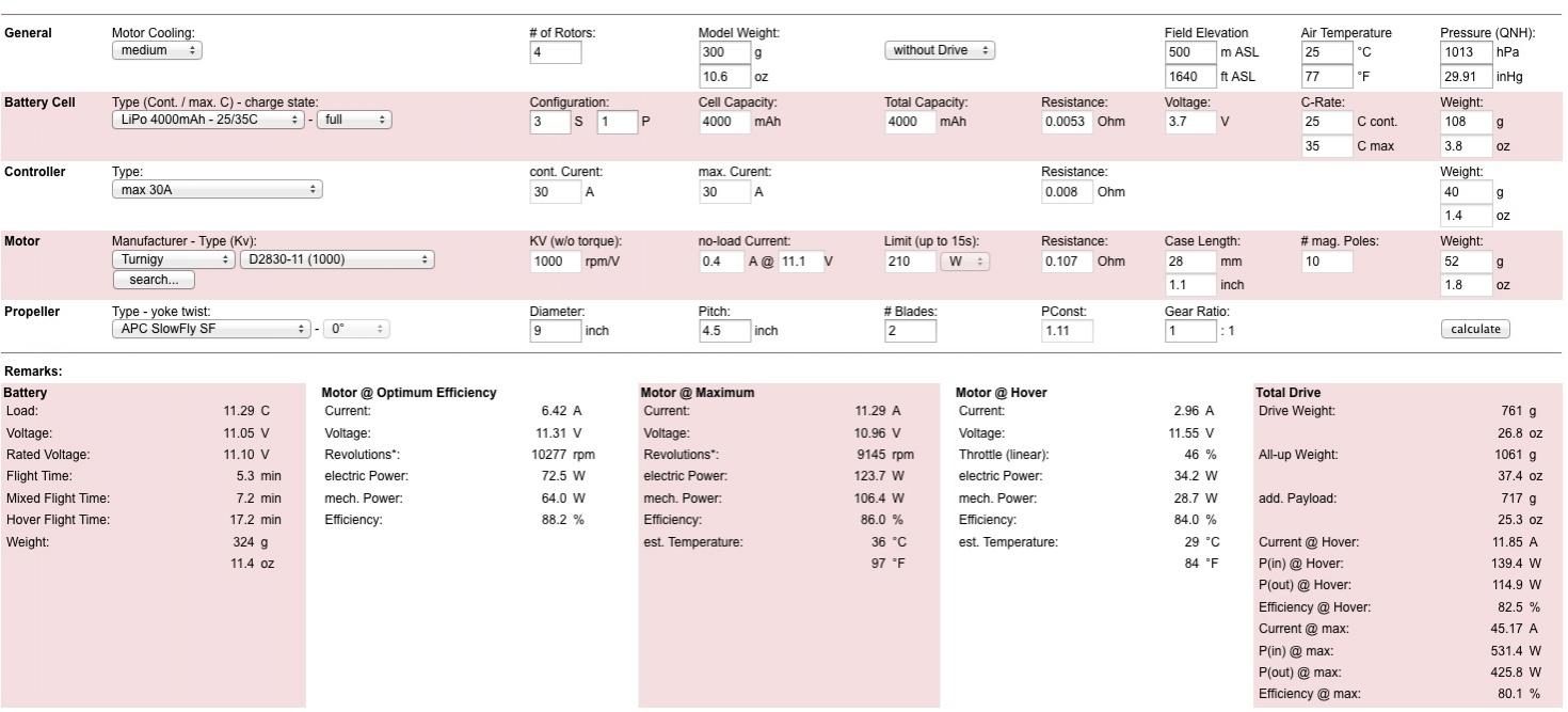

You may be better off running 9" props - since with 10" ecalc says you will be hovering at 35%. That's if you are using the lighter f450 frame. Of course if you load it up with more weight, then it offsets it a bit. The eCalc gives you low flight/mixed flight times - other than hover. But at 18 minutes estimated hover - you will probably be ok for just starting out and earning to fly.
You also might want to see about choosing the nano-tech batteries if you are going to be shopping at HK already. Decent for the money - and most people around here agree they are best bang for the buck.
