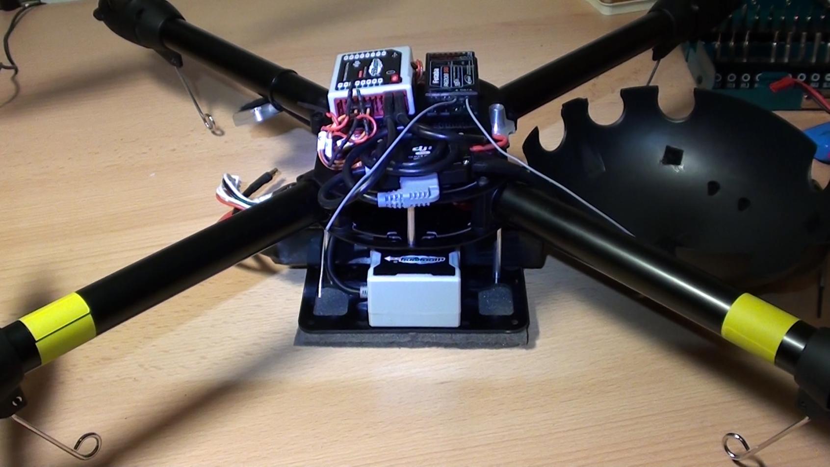

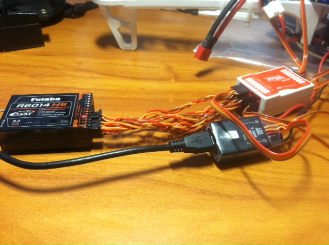

Hi Tom. Checked as you advice and notice that motor 3 is not align with the boom (have 3 hard landings) so tune and screwing back. Now all 4 engines have default gradient (Fig. 1). IMU arrow is pointed to the right and GPS also (Fig.2,3). Also tested by your direction and yes working fine in my hands with sticks commands. Will try tomorrow just hovering to see what is going on. So again: If I advance just the throttle stick quad must lift up and hover, without moving right, left, etc, right. I imagine this is the purpose of throttle stick.
Fig 1 Fig 2 Fig3 Wiring
View attachment 2921View attachment 2922View attachment 2923View attachment 2924

Tomstoy2
Yes, increase throttle to raise altitude. Decrease throttle slowly to lower.
The motor was deffinately leaning, glad you found that.
You will have to check this with all your motors as part of your pre-flight checklist as I have seen several posts about this happening to others with the Gaui 500. I would suggest placing a scrib mark on the motor mount and boom to easily identify this if one does not already exhist. Also do this where the boom clamps to the frame.

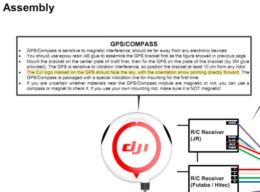

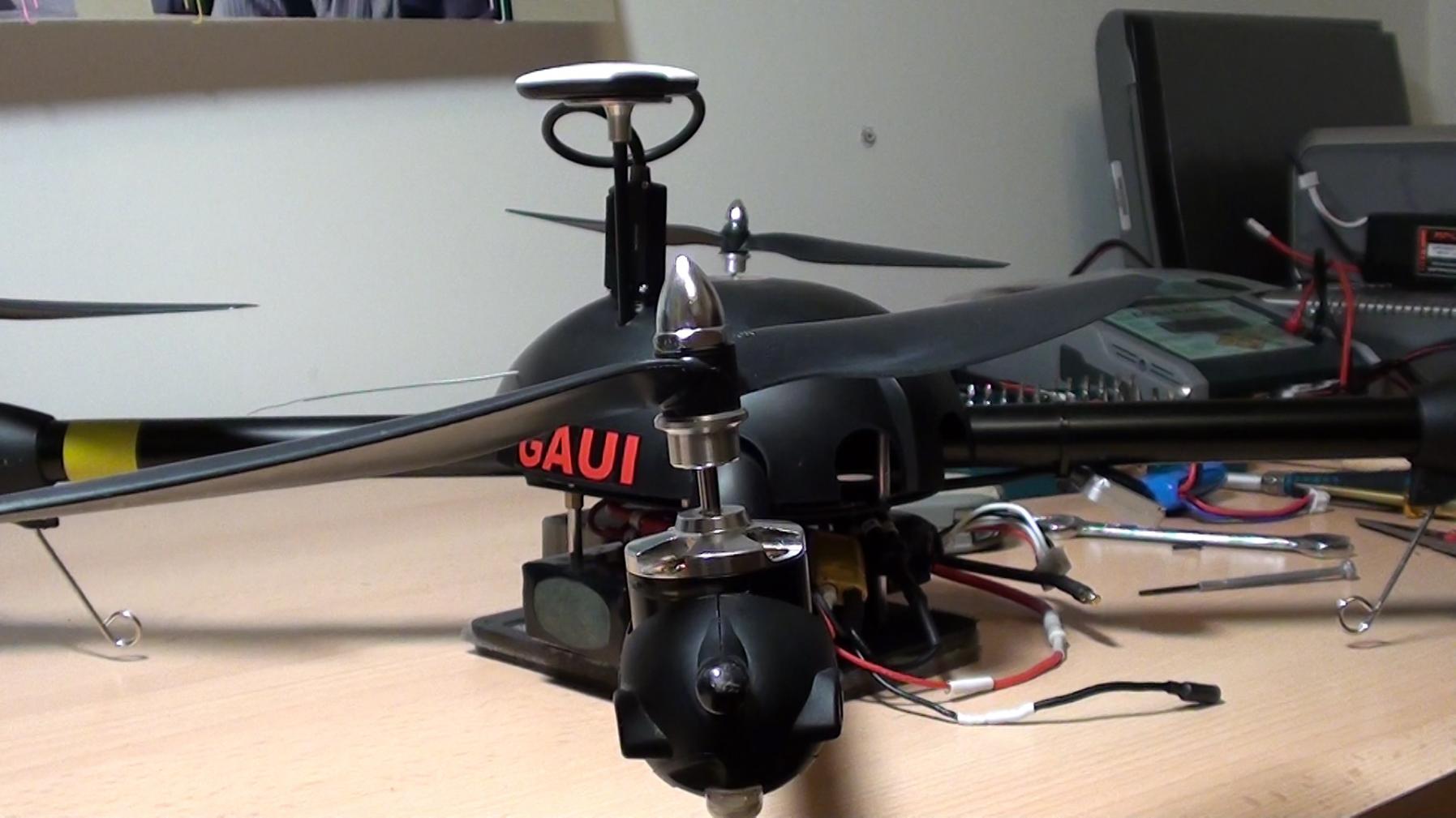

One thing still concerns me. I see in the picture you have the IMU and the GPS pointed to the right side.
As long as you have the IMU identified in the assistant as mounted to the right and written to the wkm that is fine, but I could find no such mention in the manual about the gps?
Did you try to fly this in gps like this and was it ok?
Vojec

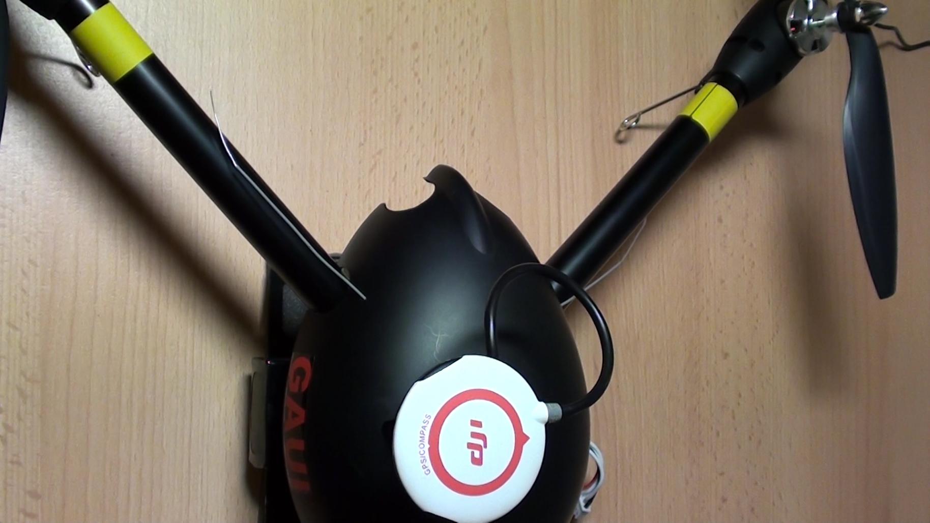

Check DJI WKM manual again and yes, you are right about GPS (FIG. 1). Turn to front direction and recalibrate compass, place scrib mark on booms then hold fingers cross to make my first born flight. YES I DID IT YAHOOOO. I'm so happy like child, you know that awesome feeling in childhood that you wait for christmas present. That feeling I've seen today. Thank you for all support that you gave me. I also recorder my historical moment. That is completely different fight and navigate is so easy when you setup quad perfectly :).

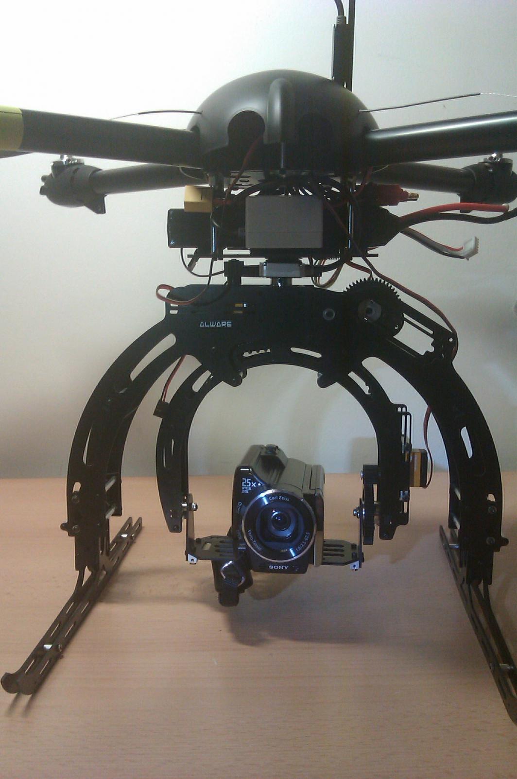

Now I'm confident with my little quad and put also cam mount from Alware. It is ok for a start. All weight with my cam is 2.100g huh a lot and with your battery formula I can fly for 5 min. Have 4S 3300 25C battery. Not bad.
Must tell that I have accident hard landing and I didn' t know what cause it. Search over big dady google and found it. It is video transmitter, because is on the same Ghz with my Futaba 2.4Ghz. I really didn't know that. I was lucky, coz my camcorder is ok and working also did not fly on high altitude.
Now I'm really enjoy with my new toy. Thanks Tomstoy2 for all support and help.
