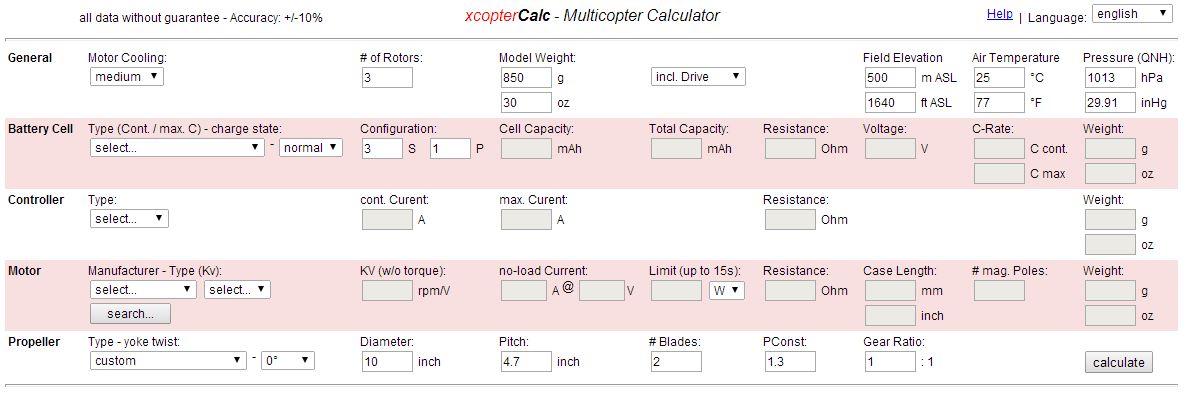

Incidentally...... when using eCalc for Multirotors and working with custom components such as the thin carbon fiber paddle props, you need to adjust the P.Const factor on the last line down from 1.3 closer to 1.0.
All other factors being equal, the thin props will give you a bit better flight time as you will see from actual flights. View attachment 16528
