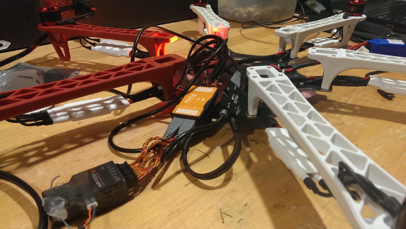

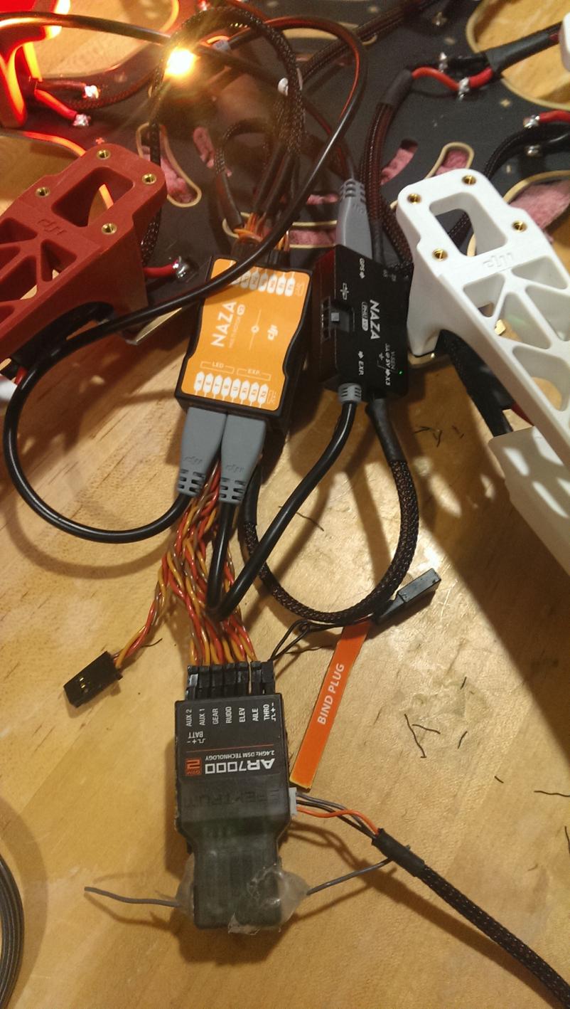

Getting my first quad set up and I'm having a problem getting power to the Spektrum AR7000 receiver. Based on what I've read it sounds like Naza M V2 should provide power for the receiver but I'm not getting any lights on the receiver when the Naza is on. Any ideas?
do you have power going into the PMU or VU depending on the version you're using?
at what stage are you with the assembly? if the VU or PMU is powered and powering the NAZA then the receiver should have power.
a picture would be helpful
myaces
I've got power to the Naza and able to view it in the assistant. I've got the 7 receiver wires connected from the naza, the only space left out on the receiver is the lower batt connection. Maybe I have the connections wrong, just put it together based on the info I found on another site.
myaces
I might have found the problem, I checked another receiver and i'm getting power to it so I believe this receiver has gone bad. Glad it happened on the bench and not in the air! :)
