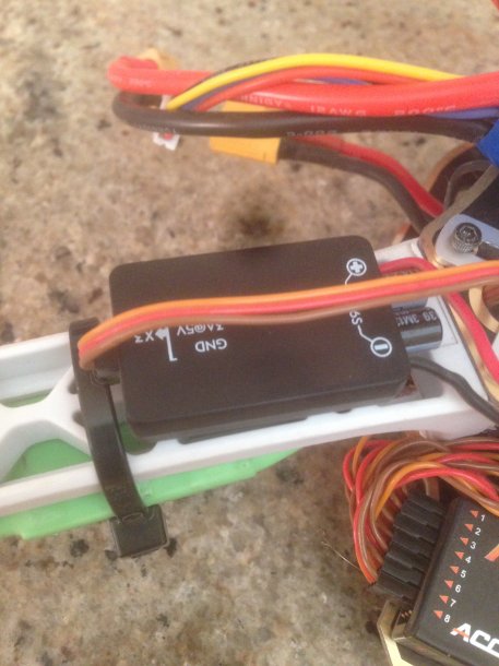

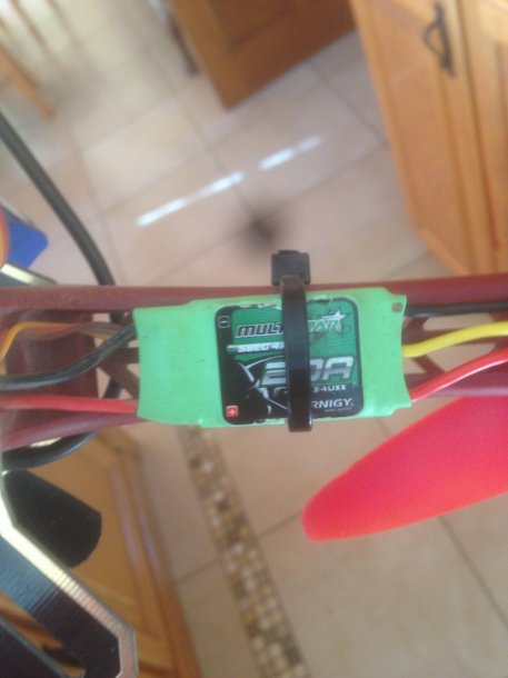

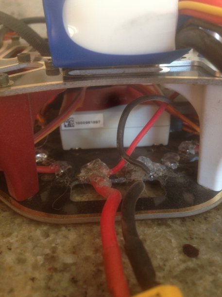

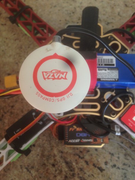

sorry I do not know why the first one sent a lot of times. this is my setup. I hope you can see where the problem is. I will post a video soon of how it flies
econfly
I don't see anything obviously wrong in your build. I can't quite tell in the video what your LED color is -- what flight mode are you in (ATTI, GPS, or Manual?). Assuming you are in ATTI or GPS, your gains may be too low. What are your gain settings?
