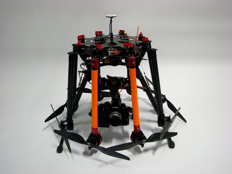

I've just spent the last three months building my Turnigy HAL Quadcopter with NAZA-M Lite MC using a Taranis X9D Plus transmitter and Taranix X8R receiver.
My first attempt at flying it failed miserably. The problem is I have no roll control to speak of. If I move you stick left or right the motors speed up and slow down as they should.
I made a little video of it that may or may not give you some clues.
I was slowly bringing the power up and it suddenly rolled to the left. I discovered that the front left prop came loose and that's what cause the flip. I tightened all props and tried again.
I gradually applied power and I tried liftoff but it started to roll to the right. I checked the props again and they were OK. It tried again while adding more and more left stick. I tried it in Manual, ATTI and GPS modes to no avail.
One thing I did notice was the LED started flashing red as I got up to speed.
Here's a video from my FPV camera hoping you might find a clue.

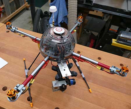

Here's a picture of my quad:

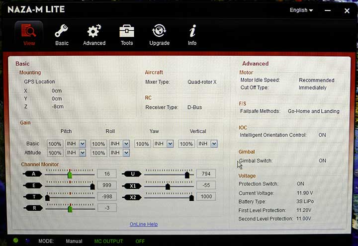

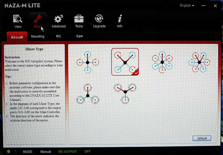

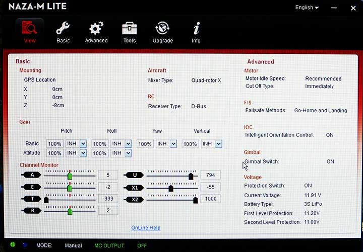

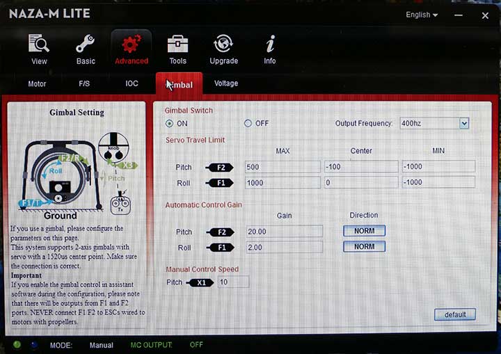

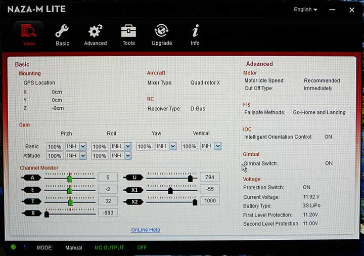

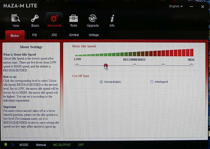

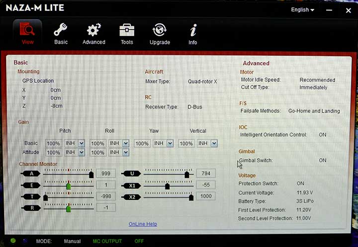

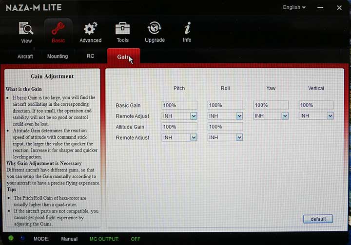

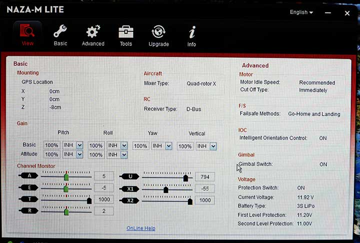

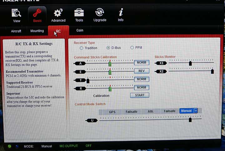

Thank you all for the comments. I have checked everything. I unplugged and plugged everything in. I recalibrated my ESC's. I recalibrated the sticks on my transmitter. I recalibrated my MC. I did the" NAZA Dance".
This video is the result of all that effort!
I'm attaching all the screen shots from NAZA Assistant from when I recalibrated it.
I hope someone sees something wrong because something surly isn't right!
View attachment 22260 View attachment 22261 View attachment 22262 View attachment 22263 View attachment 22264 View attachment 22265 View attachment 22266 View attachment 22267 View attachment 22268 View attachment 22269 View attachment 22270 View attachment 22271 View attachment 22272 View attachment 22273 View attachment 22274 View attachment 22275 View attachment 22276 View attachment 22277 View attachment 22278

SleepyC
www.AirHeadMedia.com
If you are 100% sure everything is spinning in the right direction and the props are on right.
TRY...
1st, your GPS puck is no way 8cm from the CG. It's probably 15cm - 20. The CG of your craft is where all the weight centers. Try putting that at around -15cm.
2) Your gains are all set to 100.
Try this: Basic Gains= Pitch 150%, Roll 150%, Yaw 100%, Vertical 105%, Attitude Gains= Pitch 150%, Roll 150%

Do a quick 2 tests for me...
1. Push both sticks on your controller up and right - all the pointers in Naza should go to the right hand side if so is well.
2. Go to the screen where you select it as a quadcopter and do a 'motor test'. Watch that each motor in turn moves in the number pattern and direction of my previous post.

One thing I noticed, looking at your pics, I'd turn off the gimble and the voltage protection, and IOC, for now. I don't know how these would cause the problem you're having, but you need to keep it simple, until you get her flying right. You also have to get that "U" channel on your radio set to at least a 2 way switch (3 way better) and calibrated so you can see the blue light up when you switch from GPS to ATT to manual. I wouldn't mess with the GPS either, for now, especially when trying to lift off. The REAL butt kicker is when all at once everything starts working perfectly, and you can't remember what you did to fix it !!!!! Happens to me all the time. Part of the fun!
