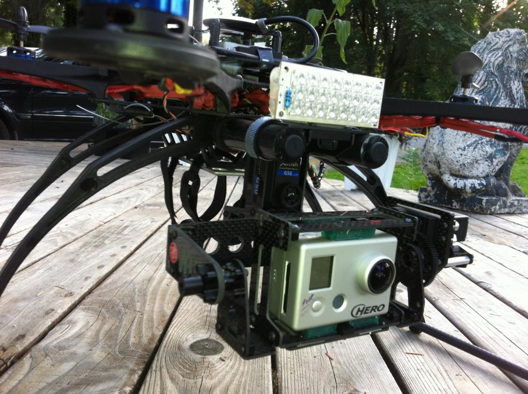

Thanks, will keep added to my favorites. I managed to get everything working after though, I had been out doing some tweeking. Everything appears to be pretty good, but some serious counter-closewise Yaw in Attit mode. Gonna have to do some reading up on that one as the trimming doesn't seem to cut it out completely. That being said, there was a pretty good breeze going.
Brookdain: your video is pretty helpful I have to say.
kloner & quadcopter: thanks for the replies, they helped me.
Thanks for all you're help.

put your trims back to neutral and turn up the rud gain. like 130, if it still turns uncommanded, bum it up 10 at a time till it stops
