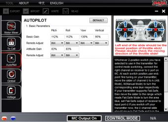

So last night i had a revelation, wanted to go do some light graffiti, just for giggles and to lighten it up i took off the gopro, then since was just sitting there took off the A/V tx, hopped it up and it had zero drift, felt like a whole different quad. when i got done, came in and redid everything inside the frames, looking forward to trying it out today. Moved the naza up into the middle of the frame and moved everything else that was there to the tab the naza was sitting. When i'd land, you could hear the motors rev from that shelf vibrating right when it touched down before, always. Also added alot of servo wire loom, heat shrink, try and get it to last a little longer than raw wires rubbing on stuff
Got 2 weeks till my first solo fpv flights across the deserts of So Cal.
