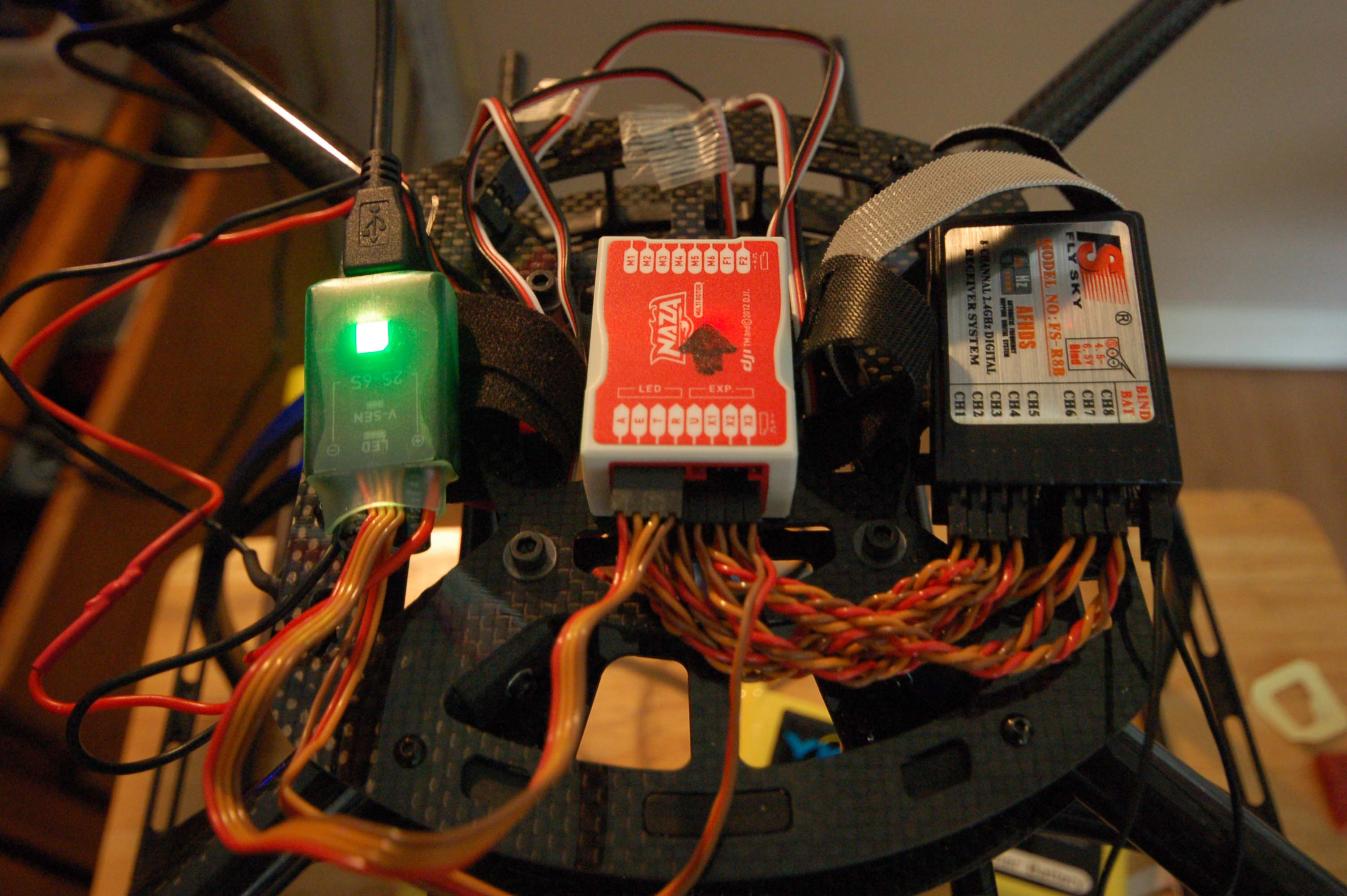

Here are pics of hardware connected and powered and the screen on the Tx monitor page.
View attachment 8718View attachment 8719
I also tried connecting the motor/esc leads now that software appears to be working and even though the assistant software says MC Output is OFF, the motors spin up full speed and don't stop...left on for over 5 seconds...

this is somewhere between the rc receiver and naza, but i wouldn't count out the vu
when you hook up each channel toa channel on a controller it is called pcm. it has that channels pulse in it. that is as naza calls traditional. your radio tx should be set to pwm unless there is none then i guess it'd be ppm, that is all the channels in a single wire, but it has 8 humps, each hump being a channels pwm width...... kinda like an EQ looks....... if the receiver was set to ppm that'd be one wire from receiver to naza x2 input. it is the prefered way, but i never understood how this frsky stuff works. i'm futaba
it seems like the VU isn't working right.... not showing stick movement, not shutting off the motors

Pic was not very clear but, are you sure that the polarity of channels wires is right? May you try to invert only TH, just to check if link works on Assistant monitor?

Sorry, I notice right now that ATTI mode is enable, so cabling polarity seems right, also notice bind plug inserted...
