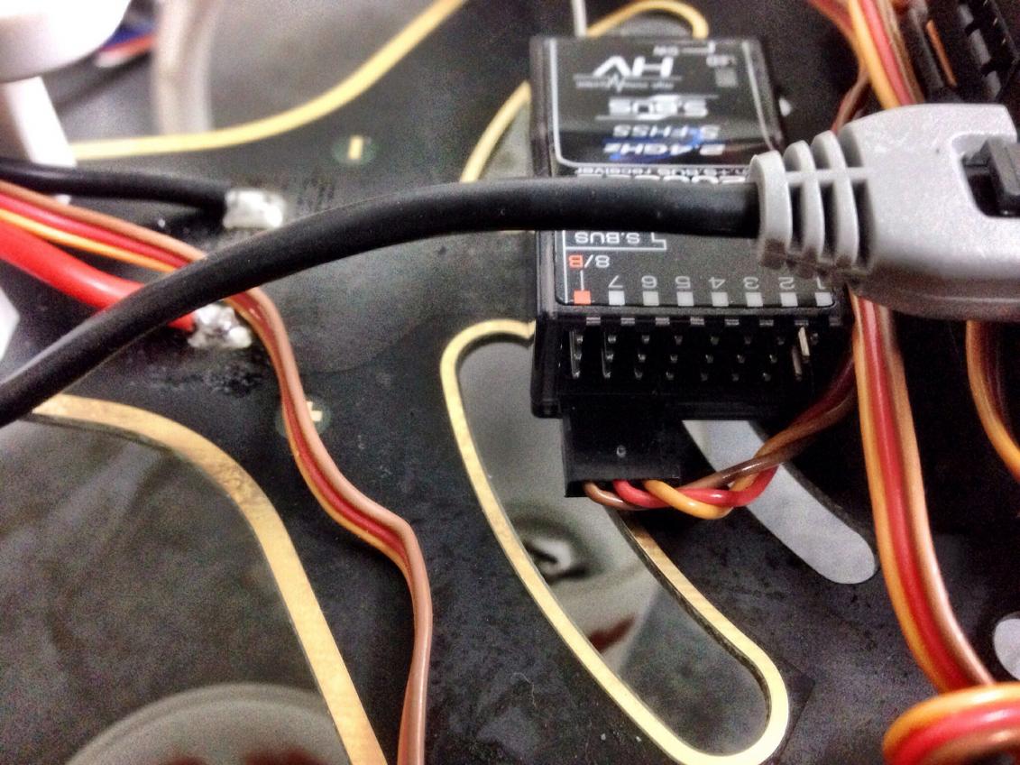

Im using a Futuba 8J transmitter and what i mean by bus to x2 and nasa to x1:
the transmitter inputs:
xxxxxxxx
xxxxxxxx
xxxxxxxx
xxx
where xxx(bottom row)=cbus
so xxx is connected to x2 on the nasa(I'm thinking this could be the problem )
x5 x4 x3 x2 x1
x x x x x
x x x x x =nasa inputs
x x x x x
should I connect the transmitter differently to the nasa? Strangely the software picks up my stick movement.... I dont know what the problem is.

Zachsparw, it looks like you do have it connected up correctly, both from your description, and the photo. And, as you said, your stick movement is showing in the software assistant. So the next question that comes to mind is if you see all the Naza channels responding in the assistant software? Again, I am simply keying off the fact you stated you only see fast flashing yellow. (If it was red/yellow I'd say to look I to compass issues.). On my Naza it will flash yellow when my transmitter is setup for a different configuration that doesn't have all the channels setup properly. That's why I'm suggesting confirming that all 7 channels are coming in fine and displayed in the Assist. SW.
