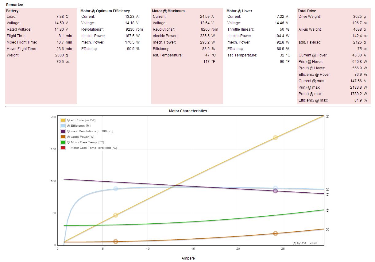

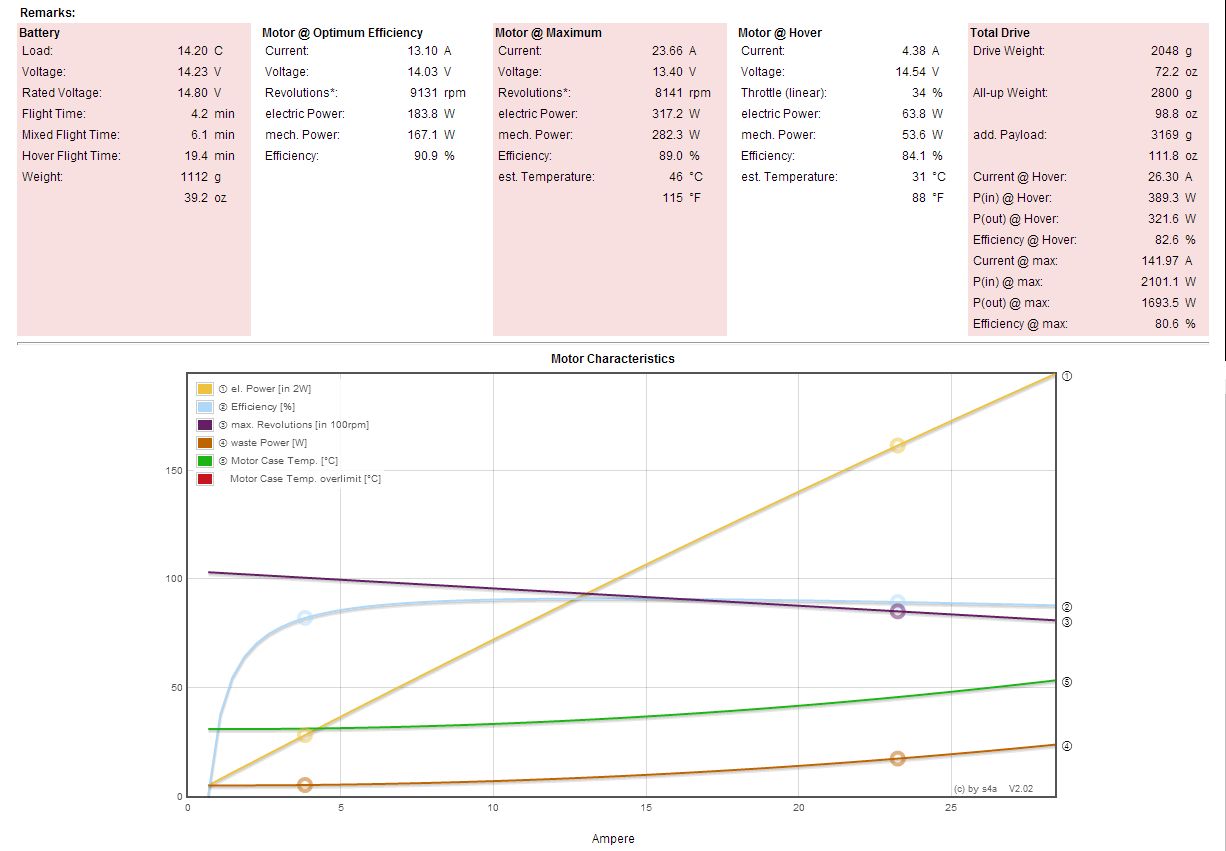

Hello out there, I will be building a new F550 as soon as my tax refund comes in and I thought I would run it by you guys to see what you think. Here is the list of parts:
DJI Flame Wheel F550 Central 2 Piece Platform
Six Extended Aluminum Arms From ReadyMadeRC
Six Tiger Motors U3 700kv
Six Castle Creations Multirotor 35 ESC's
Three Graupner eProps 12x6 CW
Three Graupner eProps 12x6 CCW
DJI Naza-M V2
DJI iOSD Mk 2
Boscam TS832 5.8Ghz Tx
Futaba R6208SB Rx
DJI Zenmuse H3-3D Gimbal
GoPro Black Edition HERO 3+
Airy Mini Camera (Rear View)
Two MaxAmps LiPo 12000XL 4-cell 14.8v Battery Packs
Futaba 8FG Super Tx
Boscam RX-LCD5802 5.8Ghz HD
Here is the results from eCALC Multirotor:
Toxifera
I changed the LiPo size for more flight time.
In the above thumbnails the first one is with two 5450mah LiPos, and the second is with two 10000mah LiPos. I will go with the latter.

I added up the weight of all the components again and ran the figures on eCALC Multirotor with the U3 setup, here is the result:
I took a look at the specs for the 3520 series and unless I am mistaken the largest is a 400kv and the smallest prop recommended is a 15 inch. That would be too large for the extended arm setup, wouldn't it?
I also looked at the specs for the 3110 series, they seem well built with the over-sized bearings, but once I ran the numbers in eCALC it didn't provide as much additional payload as the U3 does, the flight time was comparable though. I also realize that I would save about $50 per motor, but I'd rather have the extra payload ability. I also looked at the 10 amp ad 8 amp batteries(I couldn't find a 12 amp), and the flight times were not that different. I might consider getting the 8's. I was also going to mention that the U3's are dust & waterproof, this is an issue for me because of where I live(at least the dust is). I live in the high desert.
I was curious, between flight time, mixed flight time, and hover flight time, what is the actual flight time a guy can expect from a setup such as mine with say the 12 amp LiPo's? What do you usually get?
