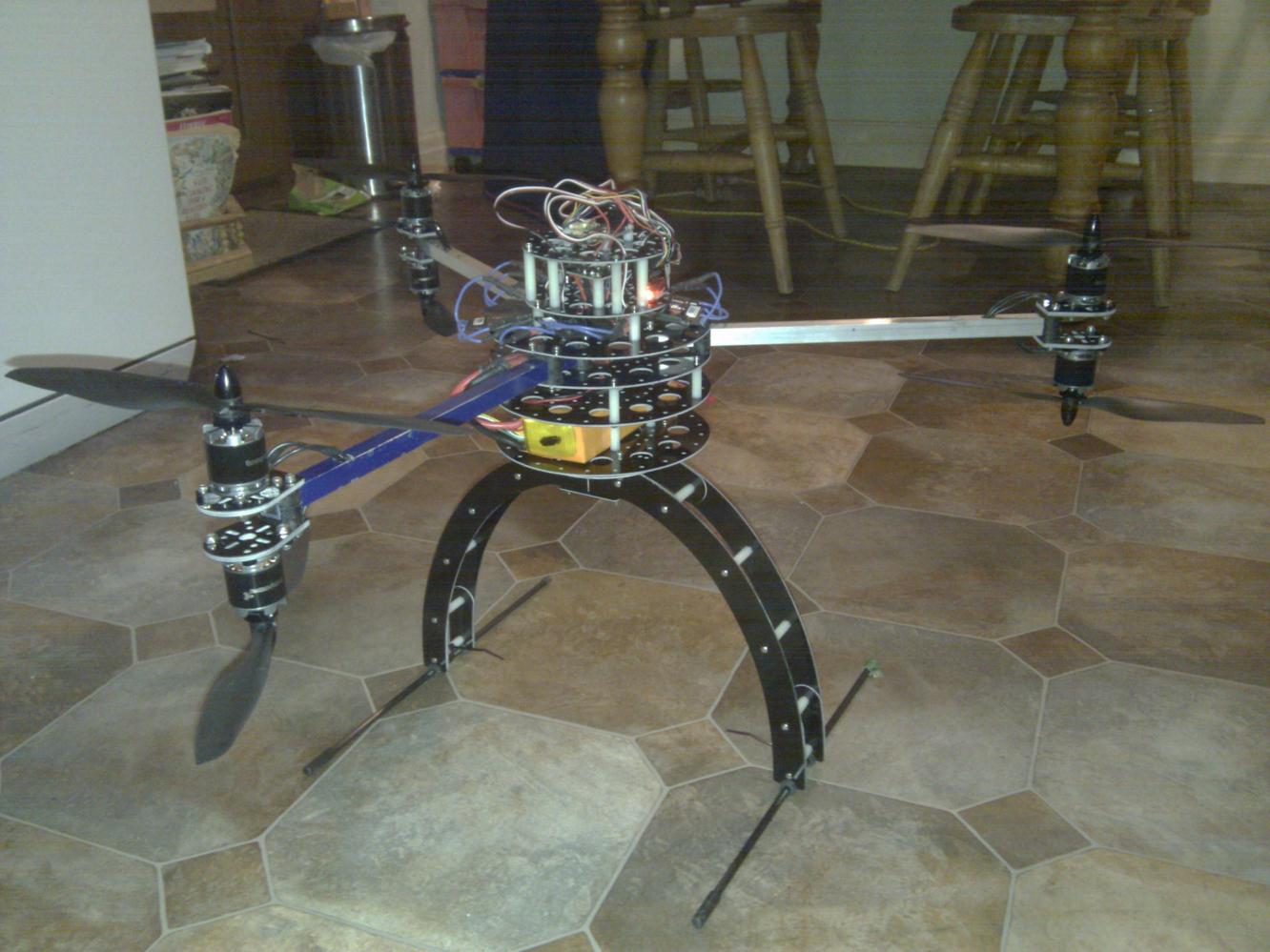

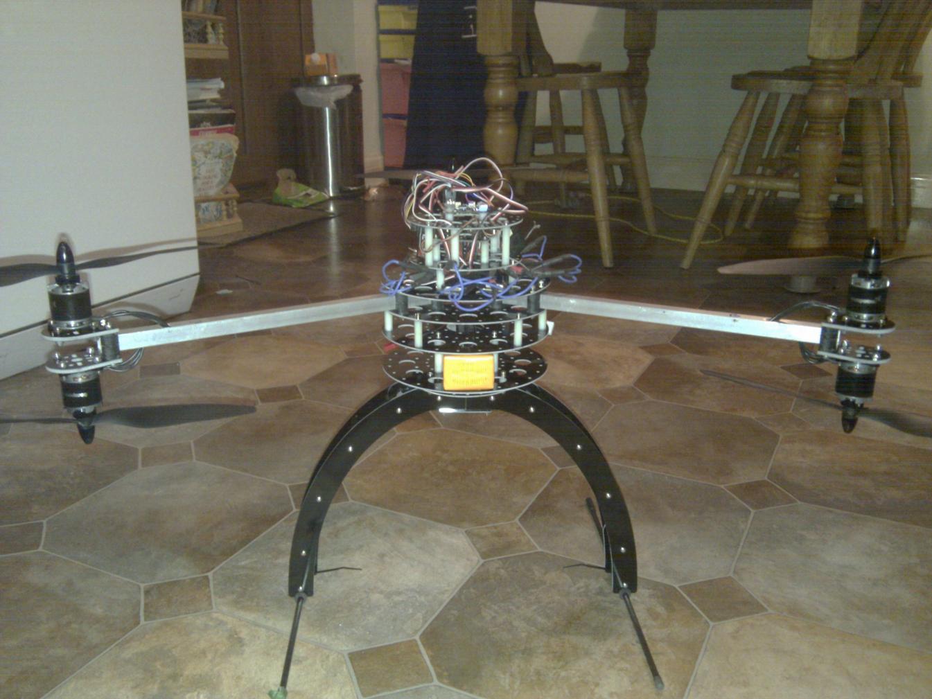

Just finished building my Y6.A bit of tidying up and finishing off to do.
Frame is a Rusty UAP-1,18 AMP esc,4s battery,with some cheapo 10" props for now ,as Electricwingman seems low on stock.
Weighs 1.63kg, 2.12kg with 1x 4s battery.
Not flown yet ,as it dark and windy outside.Hope those torxpowers are man enough ,it feels quite heavy(not weighed it).
View attachment 2047View attachment 2048View attachment 2049
Only spooled it up in the kitchen so far,the esc that carries ground and power seems quite warm.
Hopefully get some testing in over the weekend.

Looks very nice - ESP the wires in the arms
Please don't fly it like that.
The bec in the esc is rated at 2 amps with a 7.4 volt suppl on 14.8 volts it will get very hot and either shut down or catch fire, seen it happen
Please run a seperate battery or sbec for the electronics
