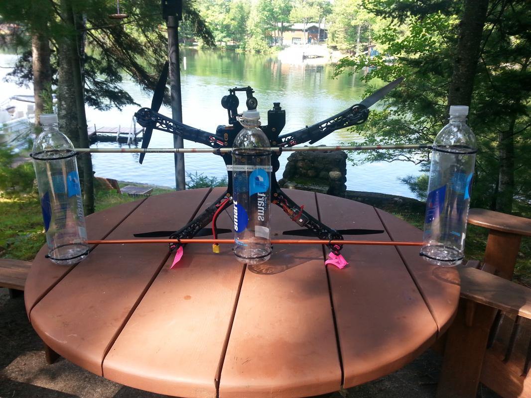

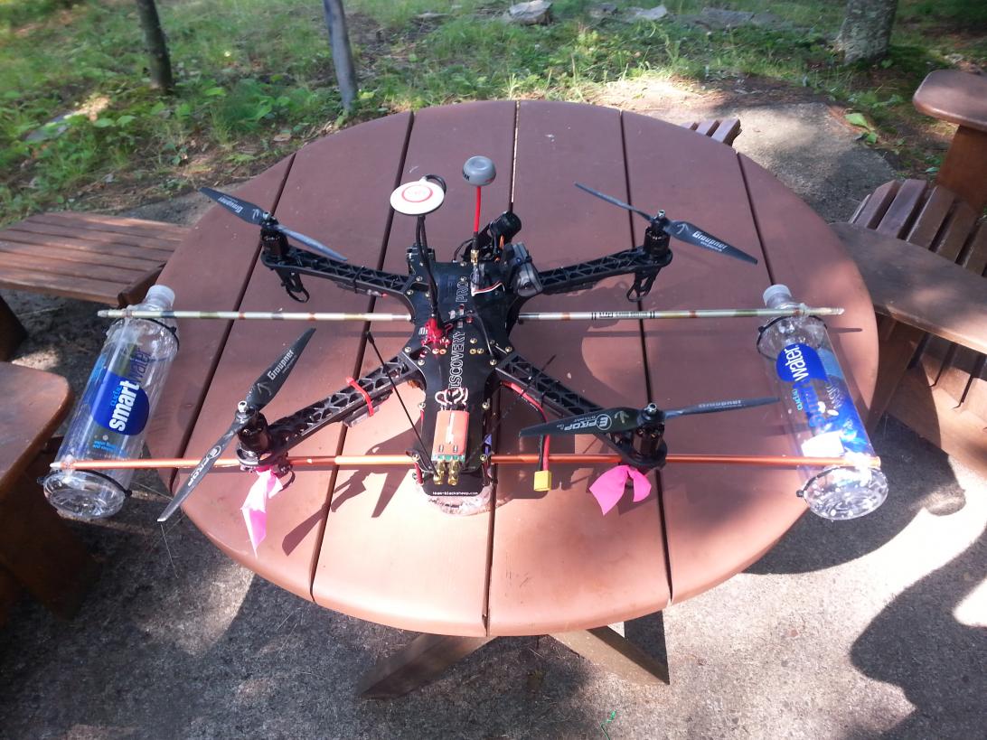

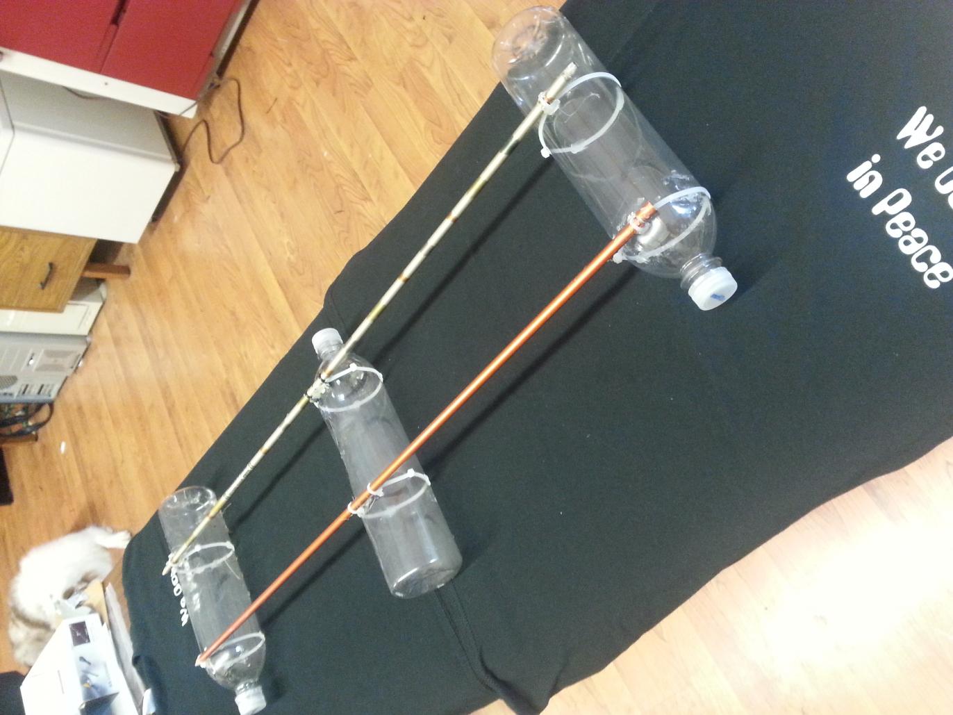

3 Water Bottles and 2 arrow shafts for you amusement:
attachment.php
attachment.php
attachment.php
attachment.php
FWIW - They work. I've used them twice.
Once when I was FPV and trying to get low enough to hide the sun behind some trees. My spotter's nose was in the ground station and he didn't warn me that I was landing on the water. Took off immediately, but I don't recommend it. When I brought it to the shore, there was water sprayed everywhere from the rotor wash. Liquid tape saved me from shorting.
Second time I flew out the battery and was trying to bring it back. Slow speed forward landing tipped it slightly on its nose and the GoPro was underwater when I got to there. 2 days packed in the rice! Everything works. Rice grains will get into the motors...

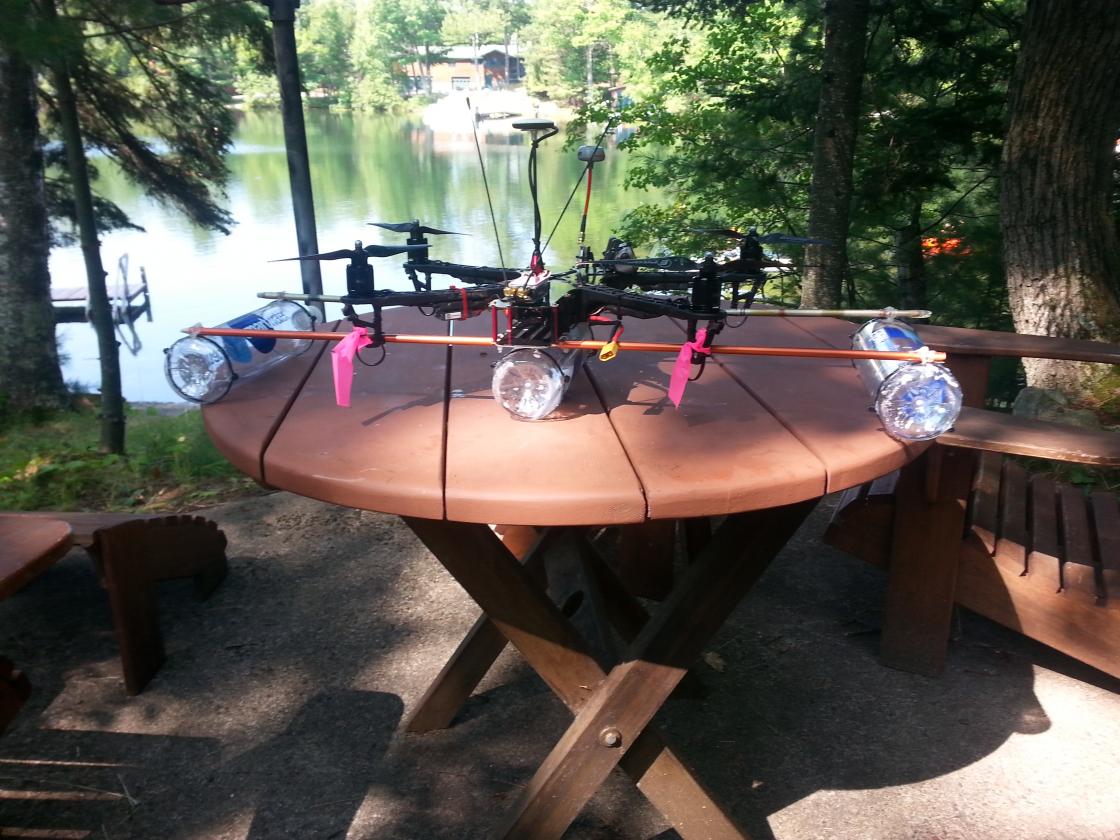

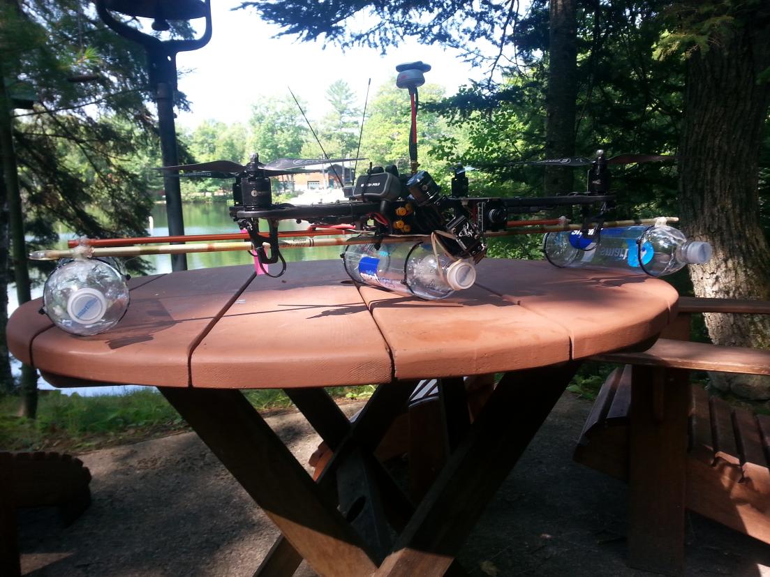

So I modified the layout to have more flotation out front:
attachment.php
6.3 Ounces, with the labels removed. 10 minutes flight time.
It flies fine and I think that the yaw movements are smoother with the gear attached.
