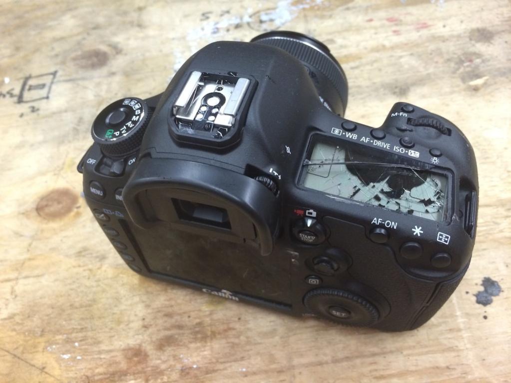

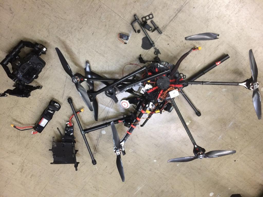

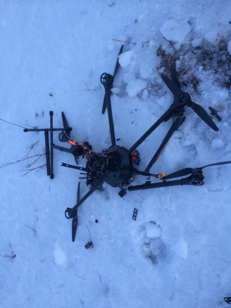

Let's just say the problem worked itself out today... Went out for one last sunset shot. I was about 750' away and 50' up and it started making the stuttery noise, tipped over and went straight down into snowy field. Bye, bye hex, Canon 5D, zen Gimbal and the rest of it. The A2, which ironically, was probably to blame may be salvaged. Maybe I'll take a break from flying for a little bit...
QUOTE]
OMG..that is not good at all, really sorry to see that, I am sure you are devastated.
Hopefully you can at least salvage your 5D somehow.

Tahoe Ed
View attachment 20407View attachment 20408View attachment 20409View attachment 20410View attachment 20411View attachment 20412
TeeCee,
I am sorry for your loss but you knew you had an issue with the gimbal and camera mounted and you continued to fly without a resolution to your problem. I did that once and destroyed a S800 and Zen15 with a Nex5N. If I am having issues I am grounded until I get a resolution. There are way too many dollars in the air to risk them. I really am sorry and do feel your pain.
Tahoe Ed
I will go back to my original observation that this is a motor/esc issue since it only occurs when the craft is under load with your gimbal and camera. Do the Maytec's have any recording functions where you can see what is going on with the esc?
