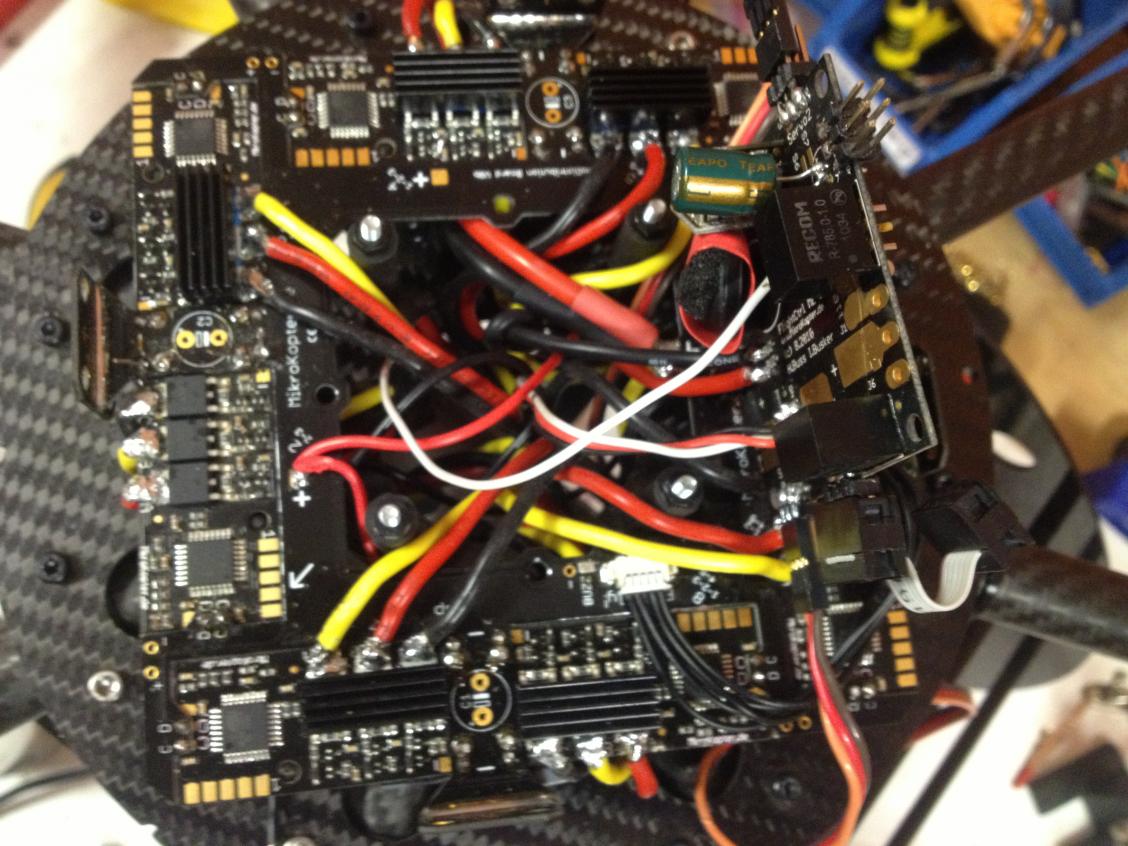

FINALLY finished my Okto XL after a long, long time in the workshop. Learned a lot along the way. Went for the maiden flight today and had some serious issues, followed by a crash. Luckily, no serious damage.
After take off the kopter began behaving incredibly erratically and I was unable to control it. It crashed a few seconds after it left the ground. I have checked the motors and the props as it seems like this should be the issue. Motors rotate the correct way (1, 3, 5, 7 CW). I calibrated the ACC but perhaps it was slightly off level but it couldn't have been by much. I also calibrated the GPS but was wondering the margin of error here. I tried to keep it rotating straight through the nick and then roll axis but maybe I was a bit off.
I've attached a pic of motors 1 & 8 in case I've made an obvious mistake with the props.
It seems like a prop or motor problem but I can't fault it.

Have you tried to recalibrate the ACC? Try and make sure the motors/props are all on a level plane. What are your PID settings? Are you taking off with the GPS activated?

Thanks for replying. I think I may have just realised the issue. The photo with the 2 motors showsy motor 1 on the right and motor 8 on the left. But they should be motors 1 & 2 shouldn't they as they are the 2 front arms?? Can't believe I missed that.
Could someone please confirm?
alexoki
Yes incorrect motor sequence setup will cause problems. Set them up as shown in the MK wiki instructions.

This morning I took it apart and replaced all the motor wires correctly. When I plugged it all back in to MK Tools, I got the error message "BL-Ctrl missing (check connections & mixer setup)" and intermittently "no receiver signal??" LED lights on the BL-Btrls are solid green and red. My receiver light is solid green as it should be. I thought maybe it was the molex connector. The cable did seem to have one wire a little loose so I swapped it out for the 5 pin GPS cable (is this ok?). Still the same errors. Have double checked all the motor wires. They seem to be good and in the right order.
