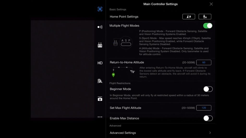

Hi, I’m new to all of this. Thank goodness I found this site because the DJI Forum Moderator refused to answer a simple question. I am hoping to learn to fly this drone good enough so that I can take it offshore fishing with me on my Jetski. My question is: my ski will always be moving; so return to home will not be an option...any idea if there is an option for the drone to return to the controller. How difficult will it be to fly this back to me and grab it while hovering? Thanks so much in advance!

In the home point settings, click on the little dude on the right. Your home point is now you/your controller
