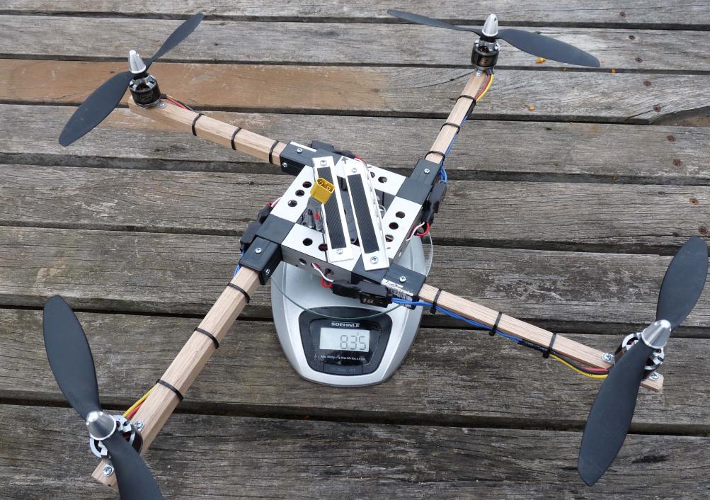

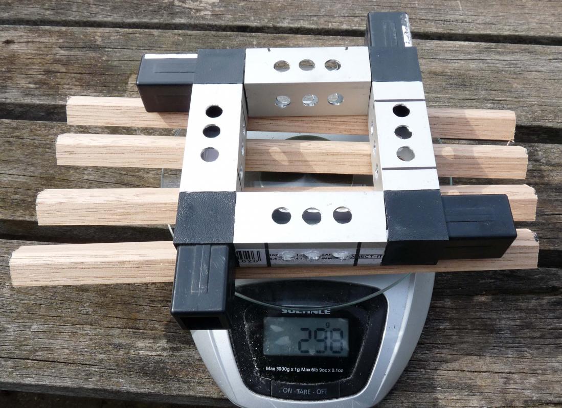

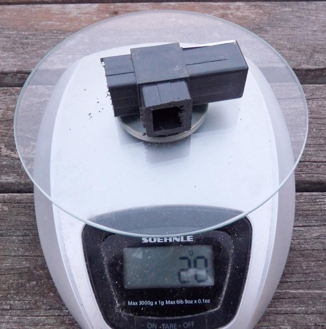

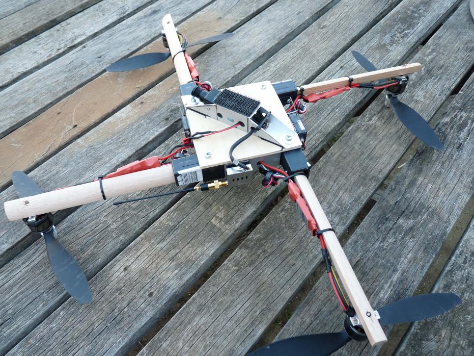

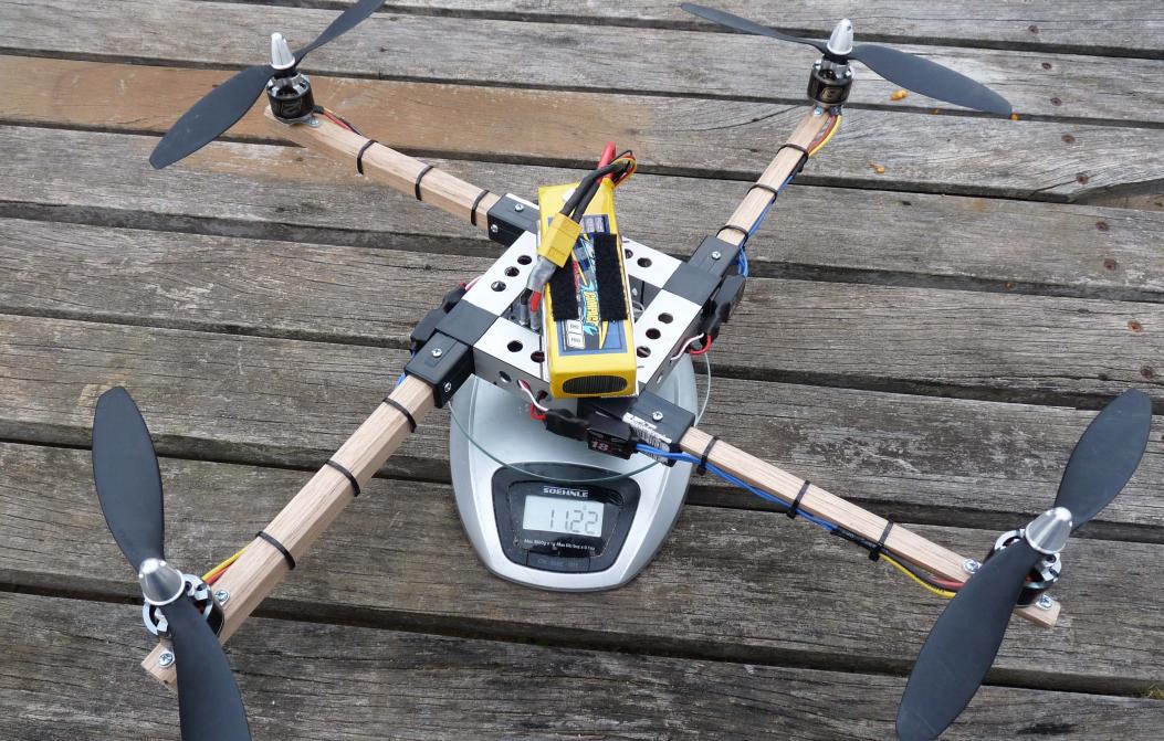

Another DIY project I've been working on:

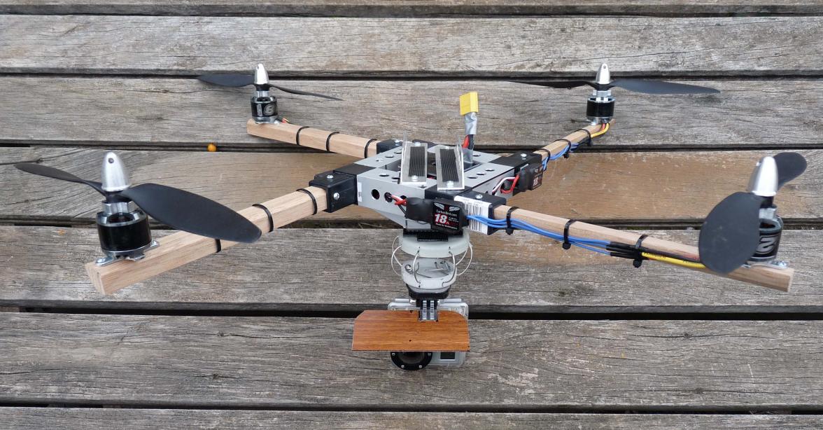

On this build I wanted to move the battery to the top for better balance.
And make the arms skinnier, for better efficiency.
Also to see if I could make it lighter.
Using:
"Connect It" components from www.rcr.com.au, for the main body
and

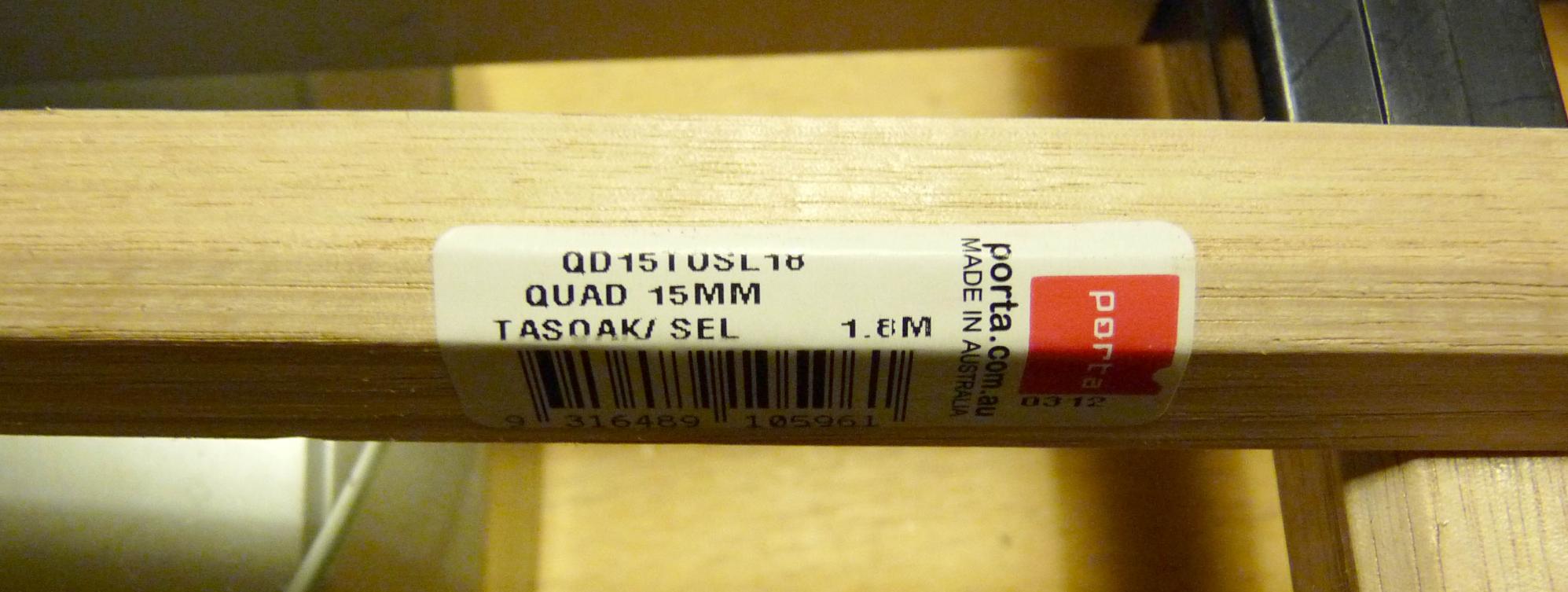

15mm "Quad" Tasmania Oak timber moulding, for the arms.
Electronics:
Flight Controller: DJI NAZA
Motors: Turnigy NTM 28-26 1200kv
ESC: Turnigy Plush 25a or Carbon Bird 18a
Battery: Zippy Compact 3s 4000mah 25c
Propellers: Gemfan 9x4.7

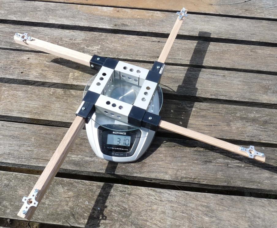

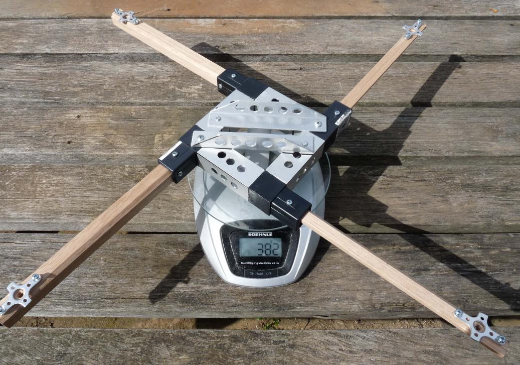

Frame weight 382 grams

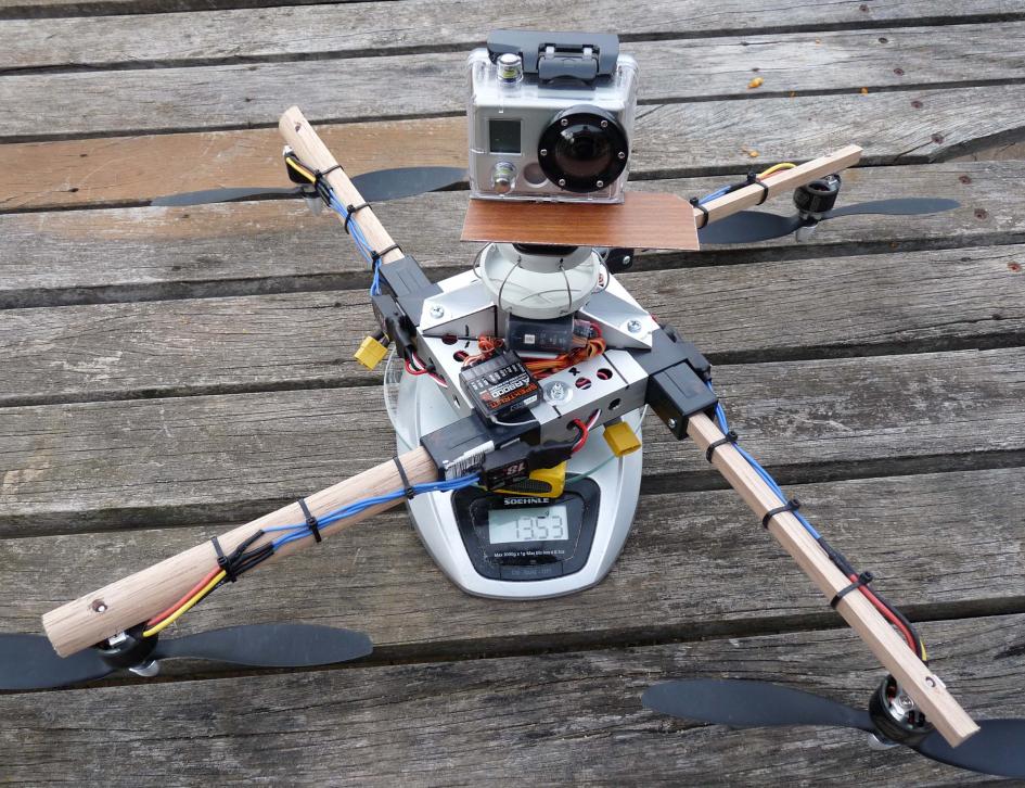

Frame weight with electronics 835 grams
Frame weight with Zippy compact 3s 4000mah battery 1122 grams

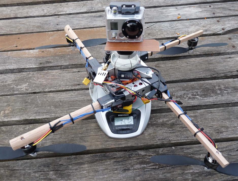

Frame weight with FPV, Gopro camera and Zippy Compact 3s 4000mah battery 1412 grams

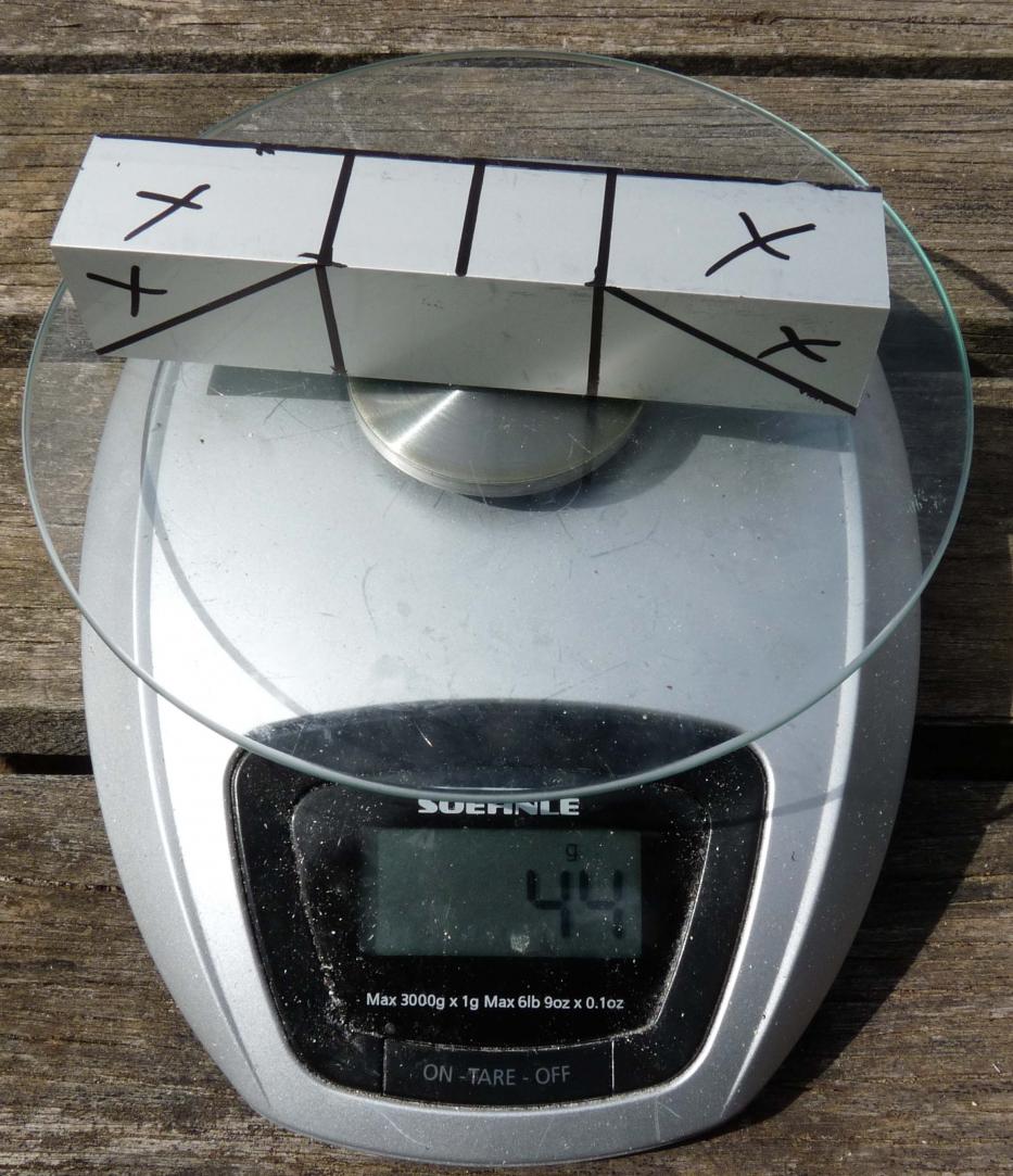

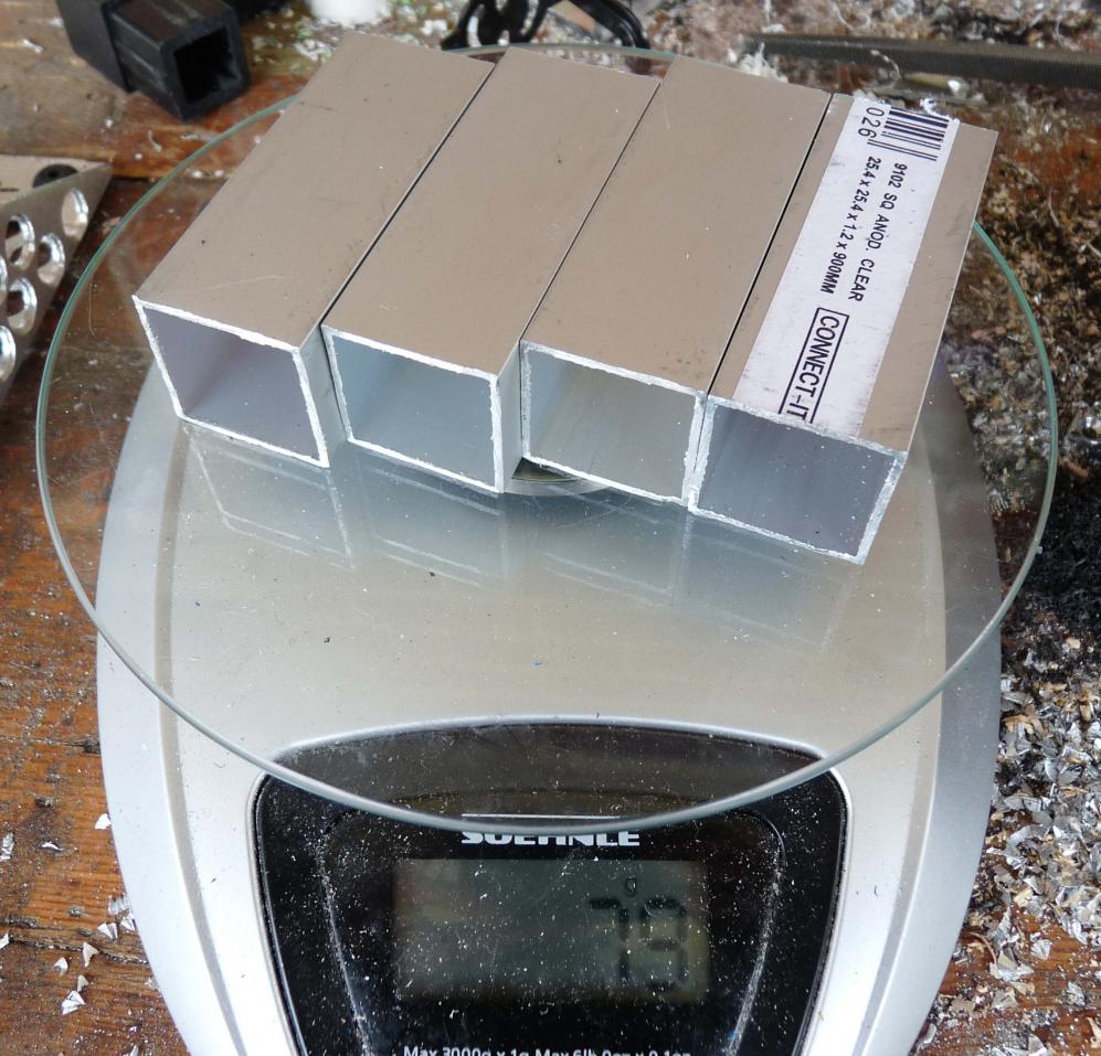

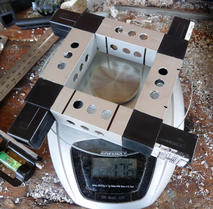

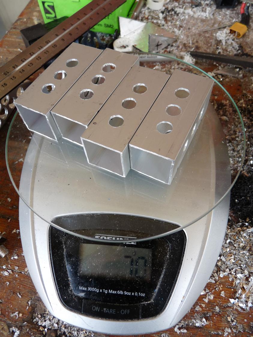

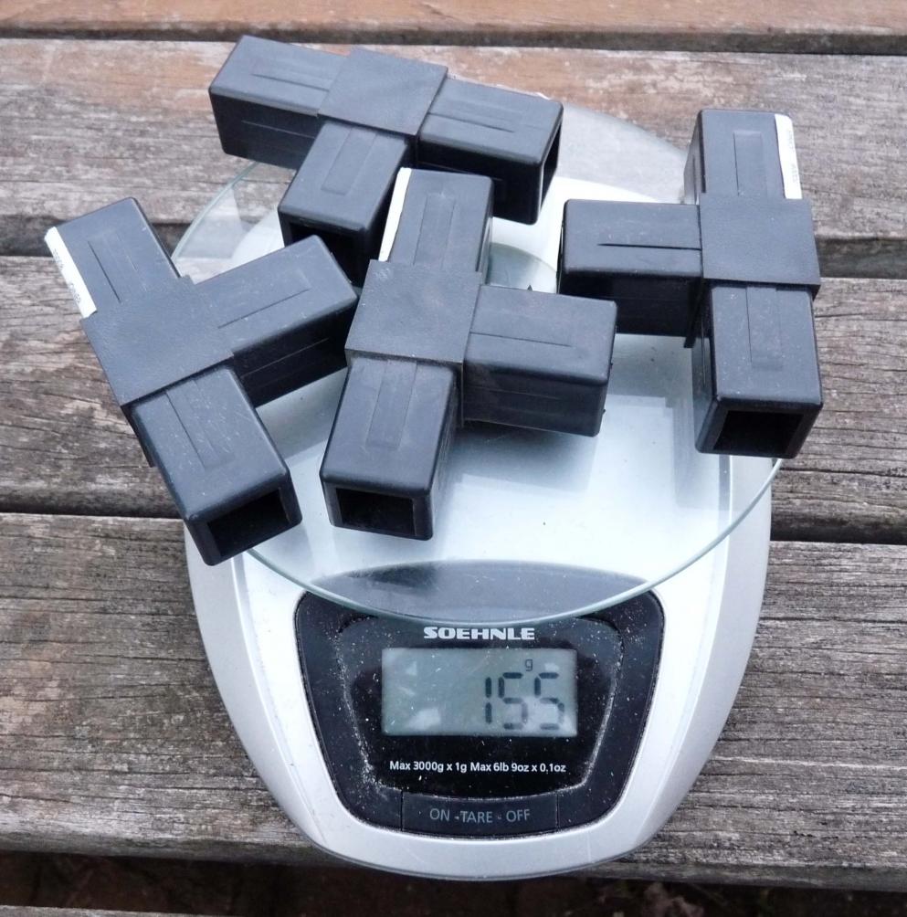

Main Body
View attachment 5850View attachment 5851View attachment 5856View attachment 5857View attachment 5858

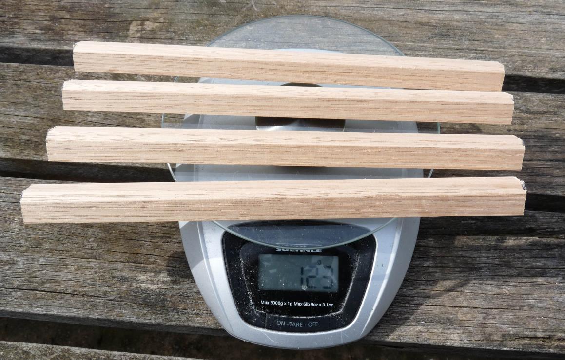

Arms
View attachment 5849View attachment 5859View attachment 5860View attachment 5861View attachment 5862

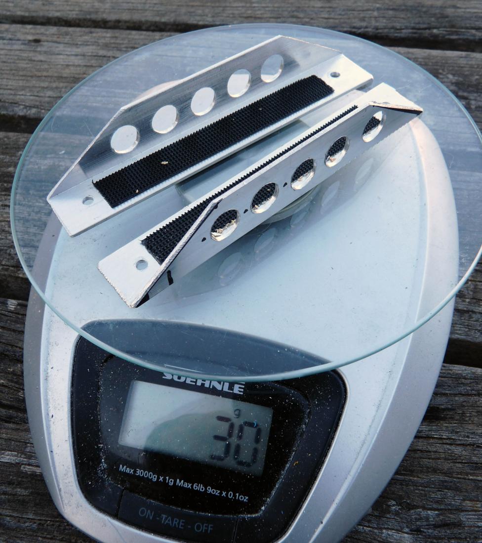

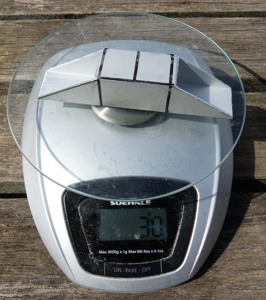

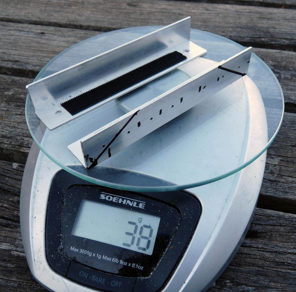

Battery Holder
View attachment 5852View attachment 5853

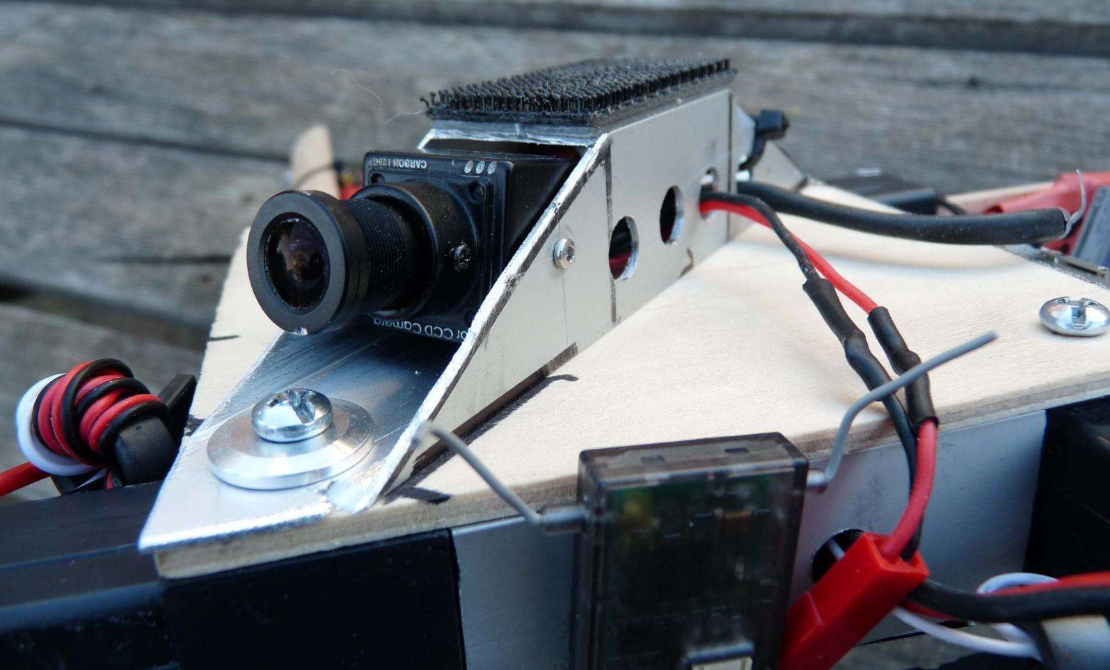

FPV Pod and Gopro Mount
View attachment 5863View attachment 5864View attachment 5854View attachment 5855

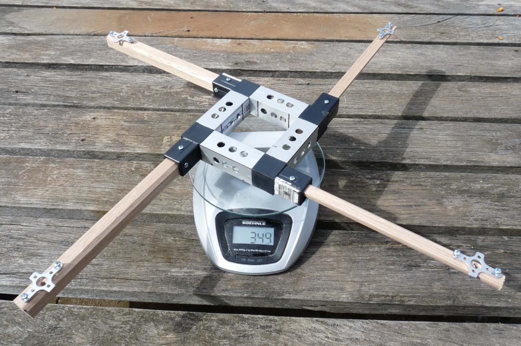

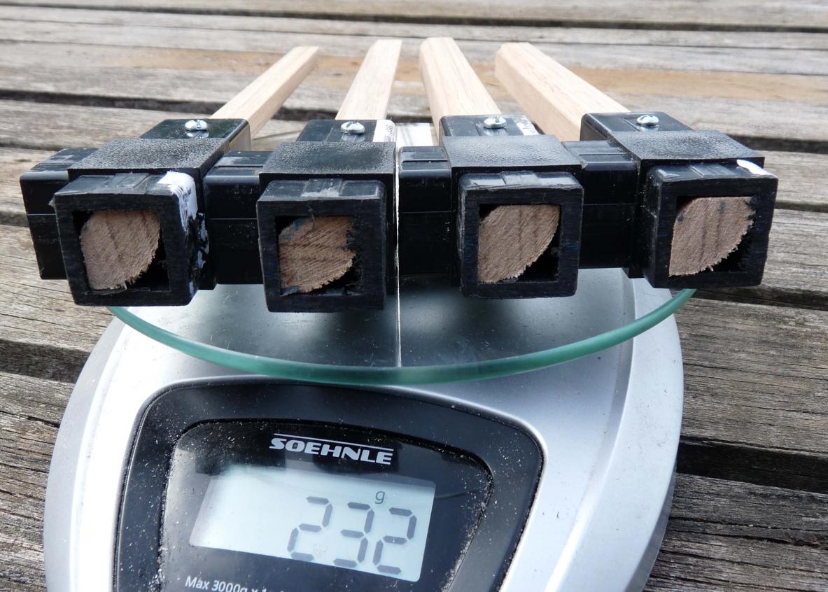

Frame Build Up
View attachment 5867View attachment 5866View attachment 5865View attachment 5869View attachment 5868View attachment 5870
View attachment 5871View attachment 5872View attachment 5873
