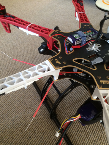

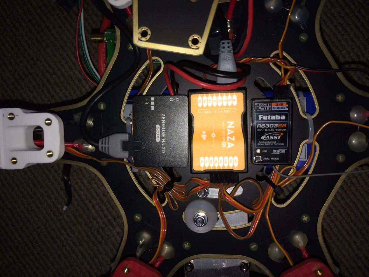

Here you go. The PMU sits on the top deck with the GPS. 1 RX antenna hangs out the bottom, and the other out the side.

For what it is worth I have mine right at the edge pointing out and one of the aerials running along the inside of each arm. The carbon fiber frame will block allot of signal. Definitely do a range check.

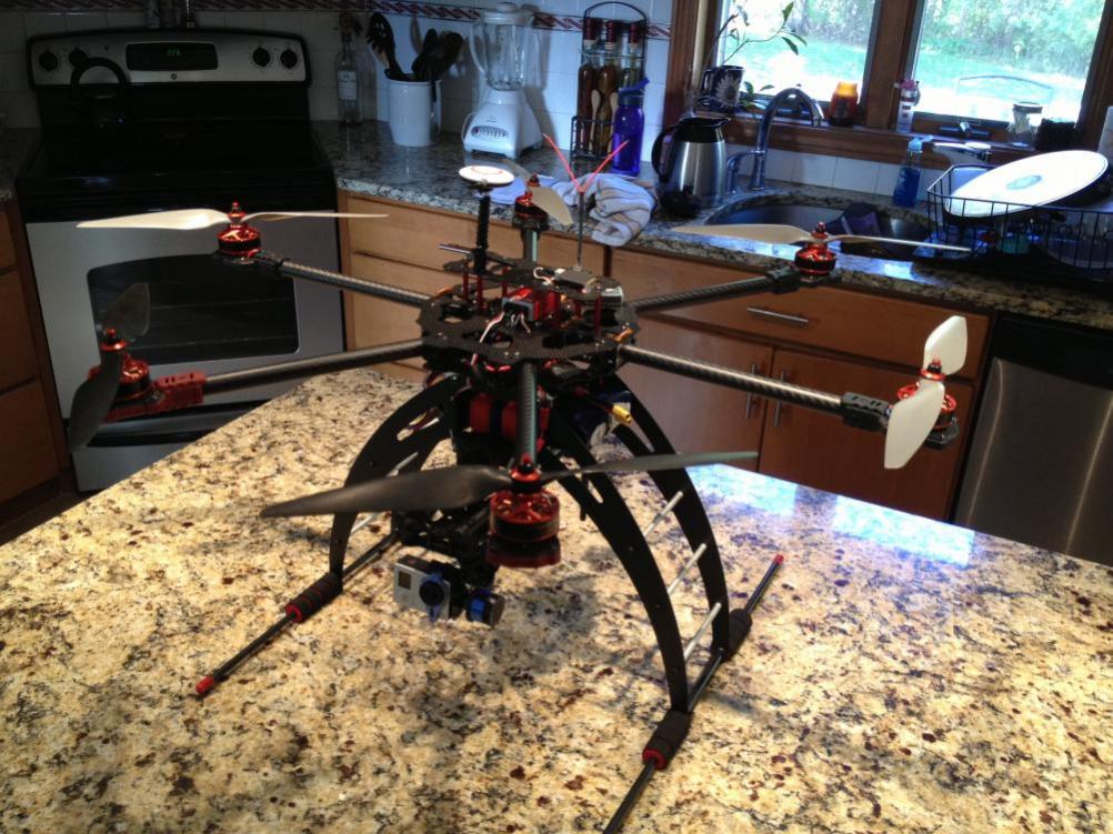

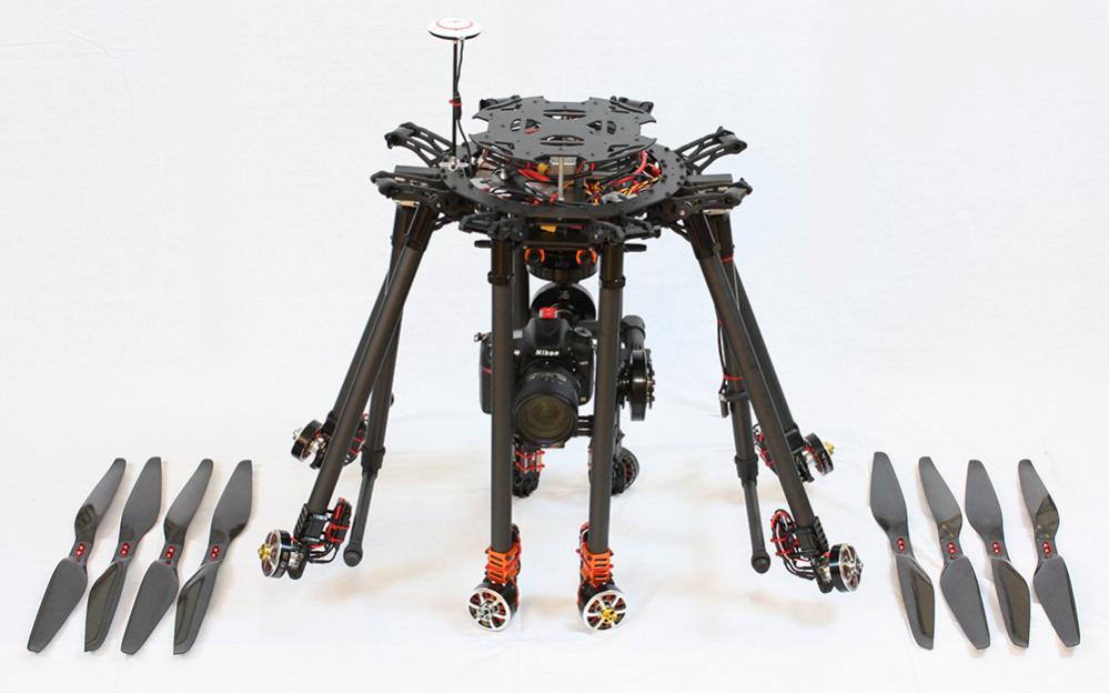

Anybody have pictures of their component layouts that they would be willing to share?

So it turns out I had a short. The lower plate which acts as the PDB for the DJI F550 had some paint removed in one area, exposing some of the inlaid copper. This was causing havoc with the receiver. Replaced the plate, and now I can now fly further than a couple of meters away. Yay :nevreness:
Glad you resolved this issue. However I recall reading somewhere, i.e., DJI or the Futaba documentation that the Receiver needs to be placed underneath and away from other components. So I located mine in between the top and bottom plate with the antennas hanging out the back of the MR. I get a range in excess of 2000 feet.
