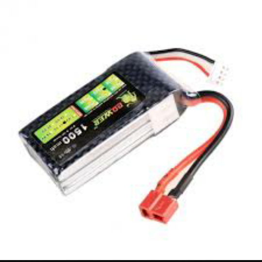

View attachment 26938What charger and plug combination is needed to charge a Lion 1500mAh 40c 11.1v? Thanks!

most all balance plugs are JST and that's a deans connector so probably any basic charger will do. if you had something in mind you could post a link and we could say for sure.

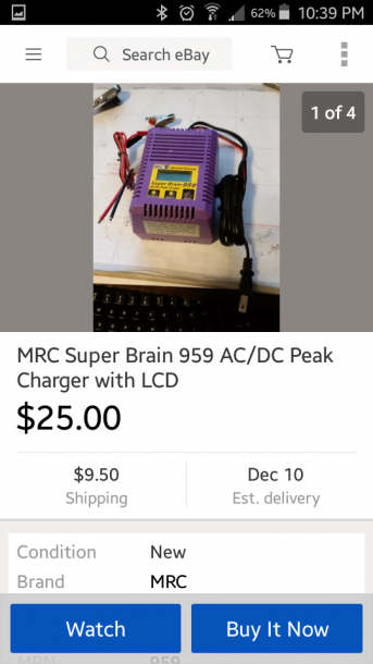

This one or any other one similar works pretty well. http://www.ebay.com/itm/Battery-Cha...633579?hash=item2a314b20ab:g:VWwAAOxyXVBSMXR4
When you charge LiPo you always want to use the balance charge setting. Full charge is at 4.20 v per cell. Storage for them is at 3.85 v per cell. Never discharge below 3.3 v per cell. Damage will occur if this is repeatedly done. Cells that drop below 3 volts will trigger a safety function preventing a charge. (There is a way around that though, too much info to post right now.)
