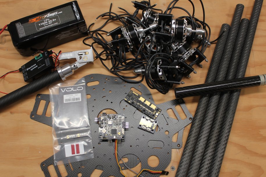

XY Format, 8 motors for a coaxial-quad configuration
Mikrokopter FC 2.5 running on dual 6S packs
Mikrokopter BL 3.0 speed controllers
KDE 4012XF motors
KDE three-blade props (i think but not sure yet)
Arris retracts (part of a product review that will be forthcoming :) )

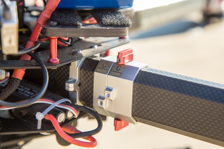

Telescoping arms for portability
Universal gimbal mount for Mōvi, my 2 axis servo drive gimbal (for photos), plus future use
Volo LED's (never tried them, SleepyC turned me onto them)
Just need to buy the remaining seven speed controllers and I'll be on my way.
