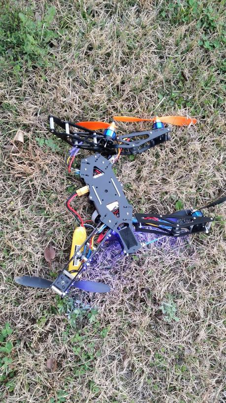

Well I figured out what I'm going to do, its all but guaranteed to resolve the problem...
x4: New Motors
x4: New ESC
x4: New Rotors
x3: New Arms
x1: New KK2.1
x1: New 4S 2200mAh Zippy
Max thrust in a rapid descent and either a motor or ESC failed = x3 motors full thrust, inverted into a railing (smashing battery, arm, rotor, FC (screen atleast) and the other arms were either at the same time or upon "landing".
I love having spares! Now I need to source ESC. HK has been out of the Afro's for awhile. I KNEW this thing was acting weird. And I am now paying for being lazy/not researching which ESC was acting up. Now I'm replacing everything vs. taking another chance. This thing is too much fun to leave alone! I'm just really hoping my Futaba RX survived. The case was split open when I got to it.
Now in the morning I get to research safely discharging a Lipo so I can dispose of my damaged battery :(
