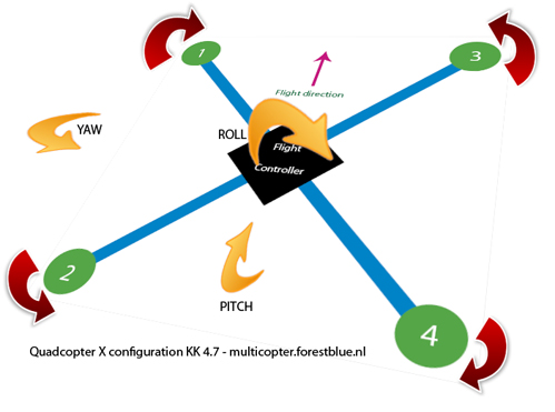

X or + ? I guess you are aware that the motor setup are different on the 4.7?
It should be with x setup:
jackmulti
Yes. I am aware. It's a + and I used the + version firmware, which actually flew but was really shaky and unstable. Went back to 4.5. It is not great but it works.
Jesper
One more thing, you might have to reverse the pots and gyros to get it to work like it should. All is explained in that thread :)
