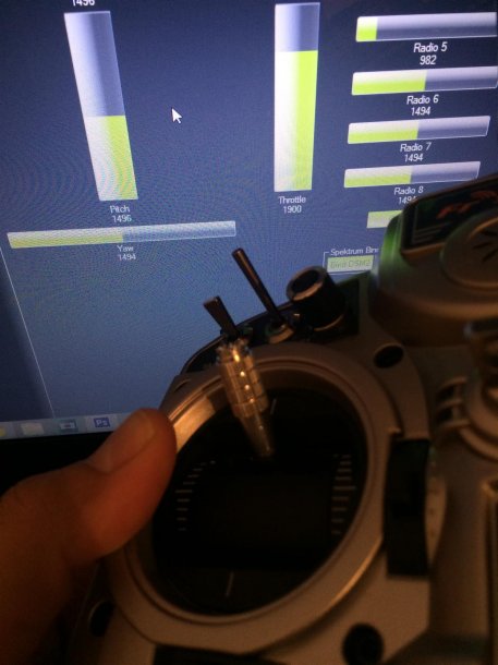

There's no reason the system would not be working, assuming the internal electronics are the same as the Pixhawk system (3DR uses our ESCs in their commercial-group as well), there is power being applied to the servo-rail to properly arm the OPTO-circuitry, and the programming on the TX and Mission Planner is correct.
I just received this from an alternate customer, who was having a similar problem with the motors running consistent, and it came down to proper calibration of the TX. I'm not a fan or user of the Taranis radio, purely by the build-quality and low-cost components inside, but hopefully this will help shed-light on the programming if this is the system being used:
Here's the quote from the e-mail:
"We solved the problem this way:
-on Taranis servo ch3 we put 1520 middle value -on mission planner radio calibration we moved the max and min from the Taranis until we reached 1100 min and 1900 max -then we entered calibration mode on the copter; powering it with the ch3 stick on high and esc 2 on parameter list in mission planner -now it works we have a correct the range."
View attachment 26404 View attachment 26405 View attachment 26406
Please let me know if this helps and if not, then I can help involve 3DR in this as well, to explain the proper calibration routine. Also, please test the ESC outside of the Flight Controller (via direct connection to a RX), which will rule out the ESC if possible (or potentially find a flaw in the ESC, works great to identify the root cause). We have an instructional video posted online to help with this:

FYI, similar PWM functions impact the E.T. Vector as well. I think many forget our transmitters base intent is for RC airplanes, where servos having large throw capability are frequently used to increase flight surface deflection. Any travel volume in excess of 100% is intended for driving a servo beyond a standard travel arc of 60*, not for ESC's.
For multirotors our "travel" range needs to be between -100 and +100, -1000 and +1000, or 1000-2000 depending on your type of transmitter. Essentially a PWM range of 1 to 2.
