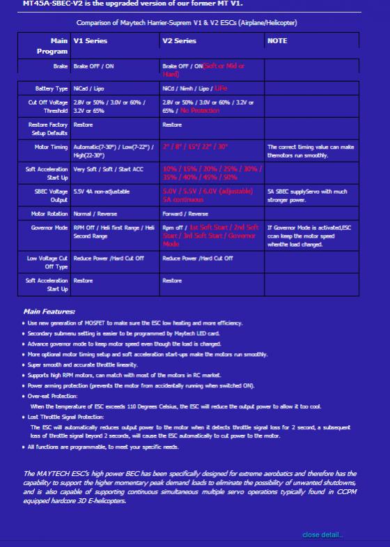

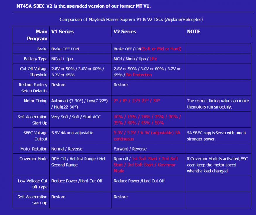

I too am interested in this. I have been looking into the 45amp Opto with the WKM. Has anyone tried the V2 Maytech ESC's? just wondering if they are any better than V1?
Are all you guys using the Maytech with the WKM?

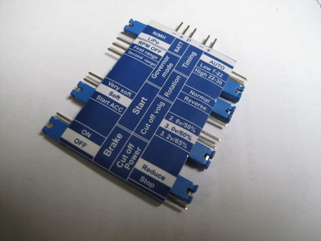

Okay here is how I programmed my Maytech, see the programming card in the image below - I also had to manually program in the 16Khz because that is not an option from the card (see the manual). I didn't bother with the flashy thingy because it just seemed too fidly for my liking and it was about that time that the bug was in the code. I don't know the difference between V1 and V2.
