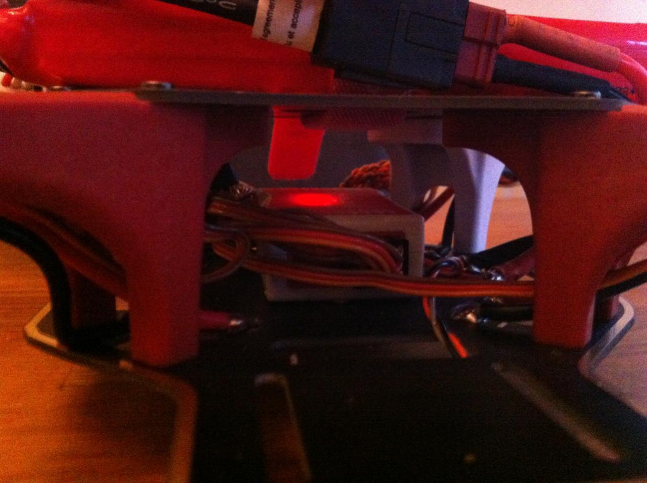

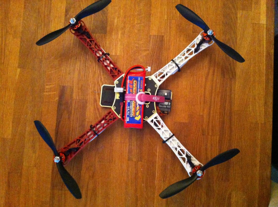

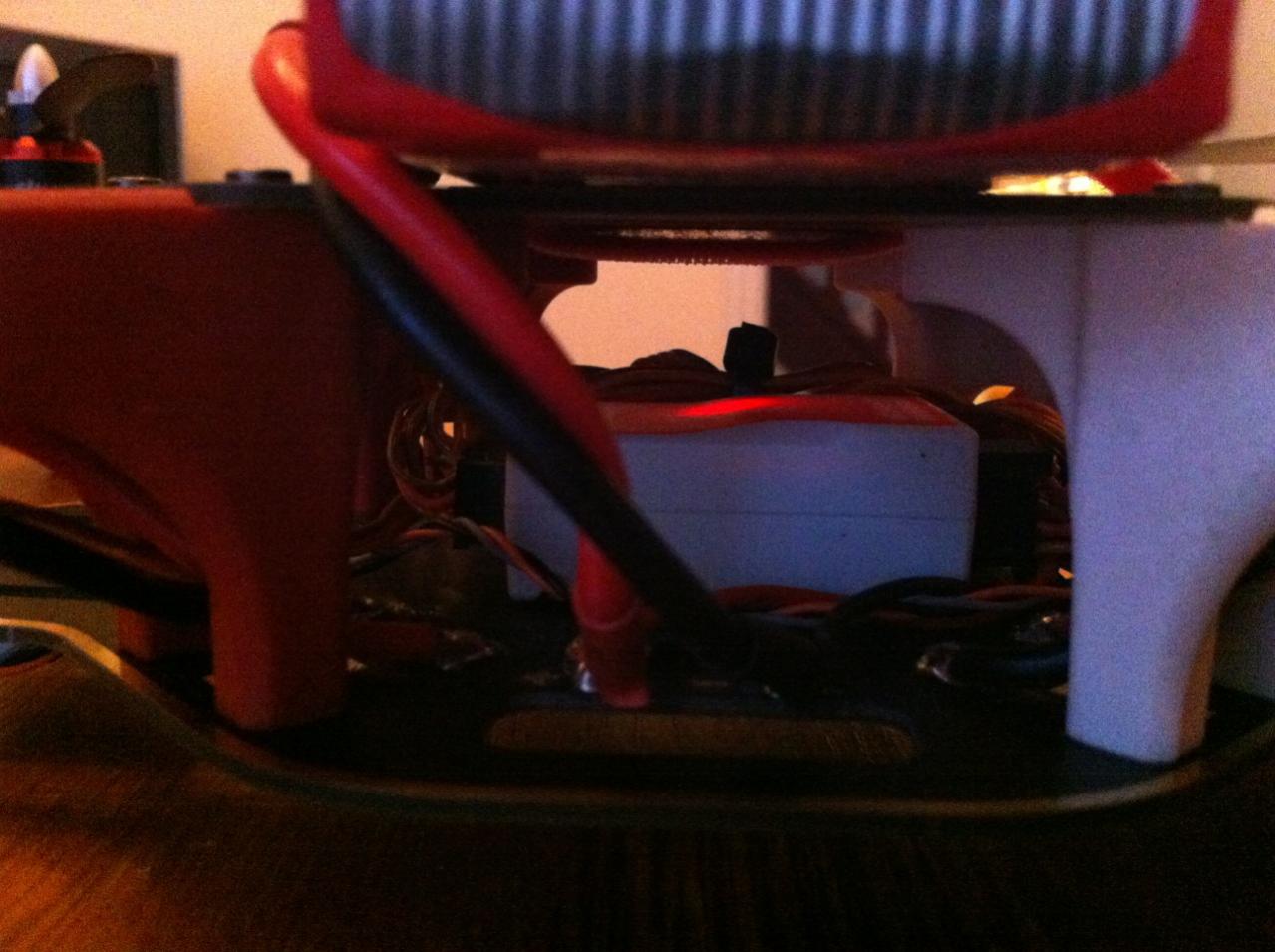

NAZA is flat and almost dead centre, just a few mm more towards the rear:
None of these have made any difference. It takes off and moves to the left and backwards.
I'm thinking faulty NAZA
Few photos, red arms are forward.
View attachment 5392View attachment 5393View attachment 5394
