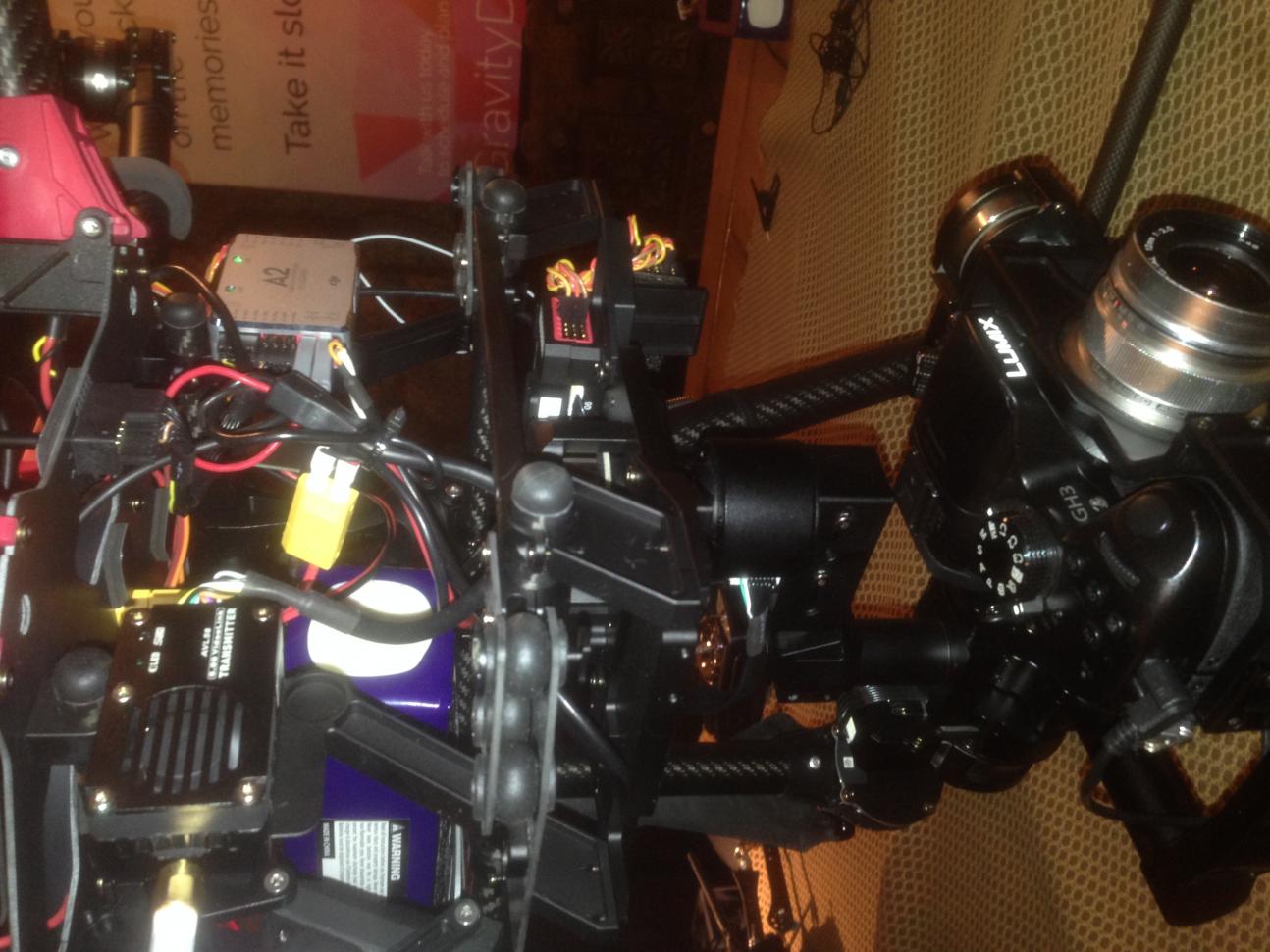

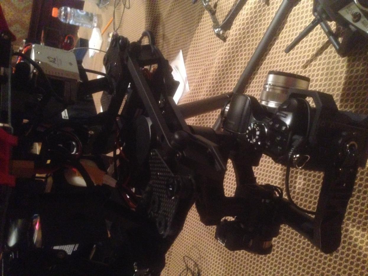

Do not use trim. Let the unit calibrate on a flat surface. Also did you mount the gimbal with the vibration isolation balls attached? If so please remove them. The top plate of the GH4 gimbal needs to be hard mounted to the mounts from the rails.
sguarch
What do you mean the top plate needs to be hard mounted? I have attached an image of what my set up currently looks like. Thanks!

sguarch

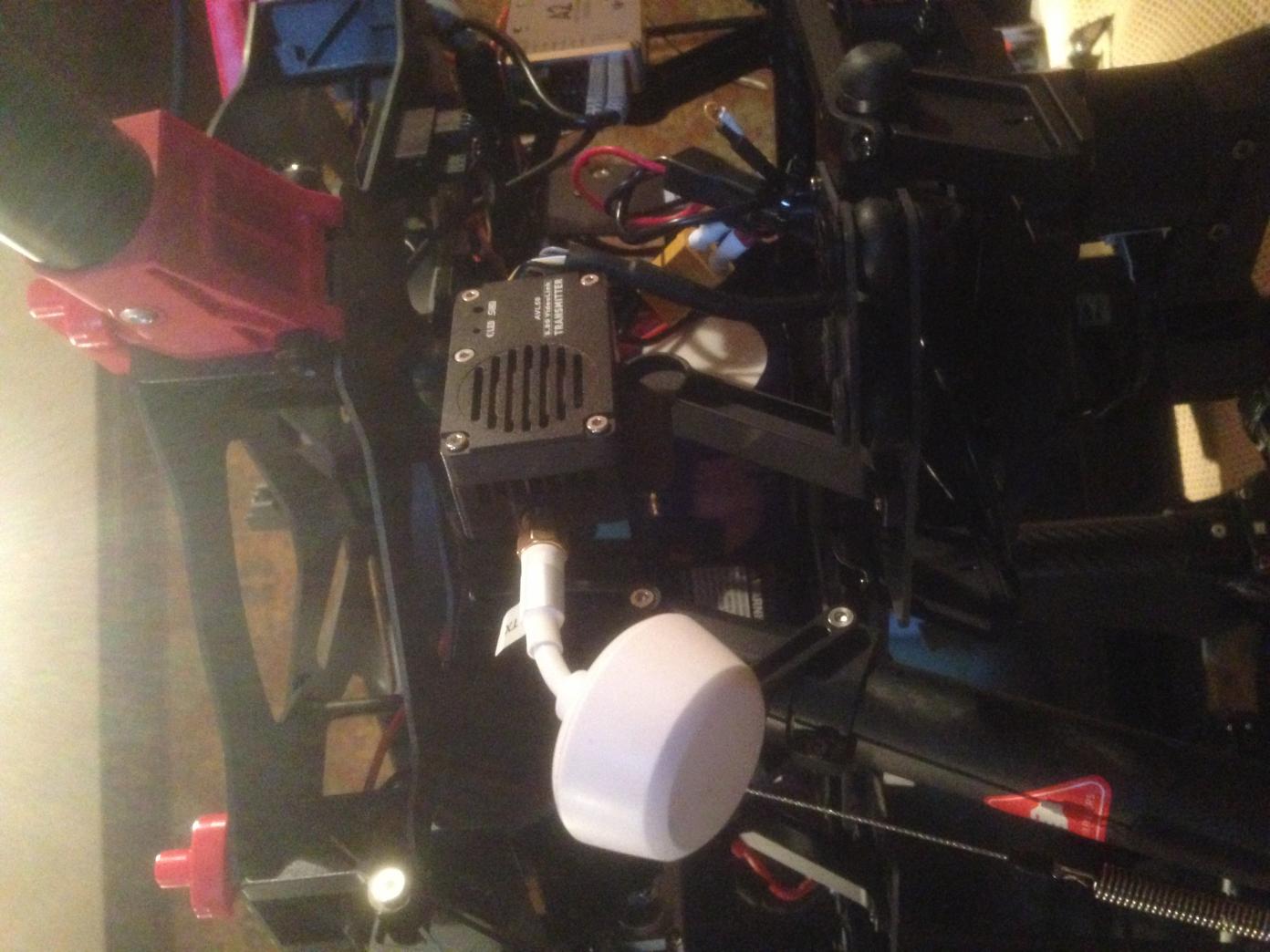

Sorry I have better lighting now. I have attached a new image. Also my video transmitter has a fan that seems to be emitting some vibrations would that have anything to do with it? I also posted a picture where that is located

sguarch
So I have been testing out the system. I have been able to eliminate the jello ( it seems to have been the video transmitter). I still have the issue with the horizon being uneven. I have attached a picture of my settings via DJI assistant, please note that we always fly in attitude mode.
