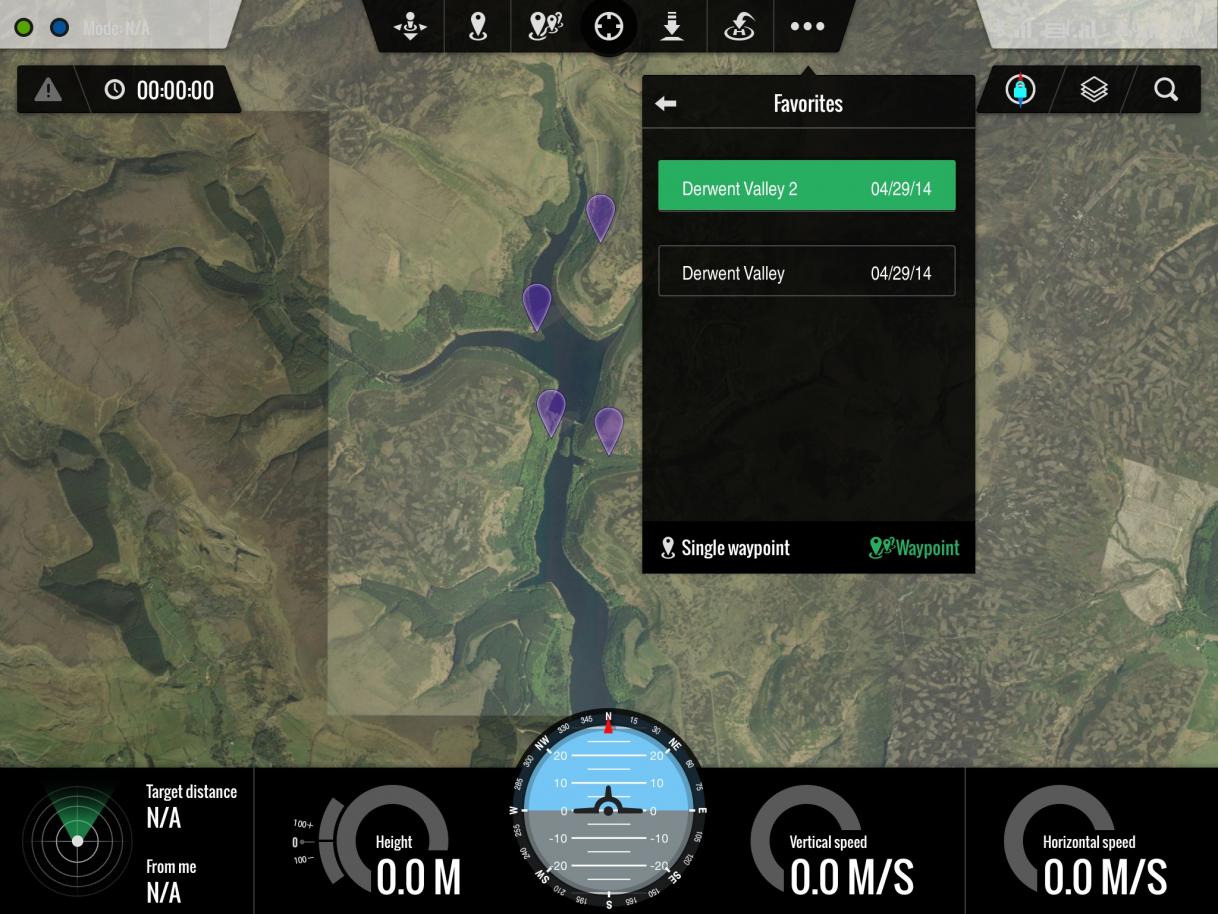

However I do have one problem, I can enter the waypoints and save but once I have closed the app I am unable to call back any flight routes I have saved as favourites when I open the app again. When I try to recall them the small white confirmation arrow which normally appears top right in the favourites window is not there.
To my knowledge nobody else has reported this problem so it must be me. What am I missing? Can anyone help?

John, thanks for your response. I had found a workaround but your answer explains the reason and solves the problem completely. As you say the interface contains a few bugs, but I must admit the app has impressed me on the few flights I have flown.

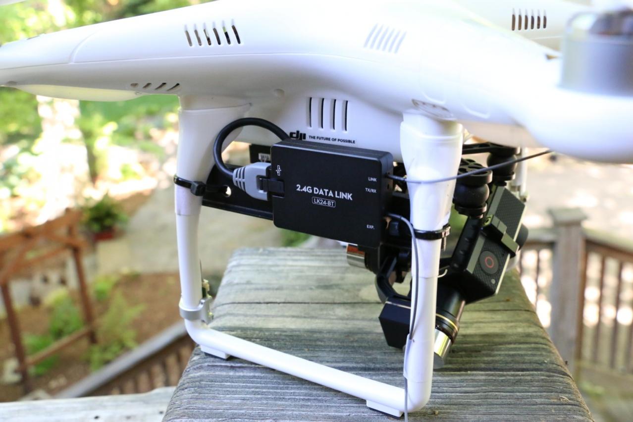

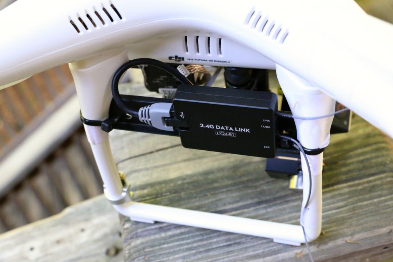

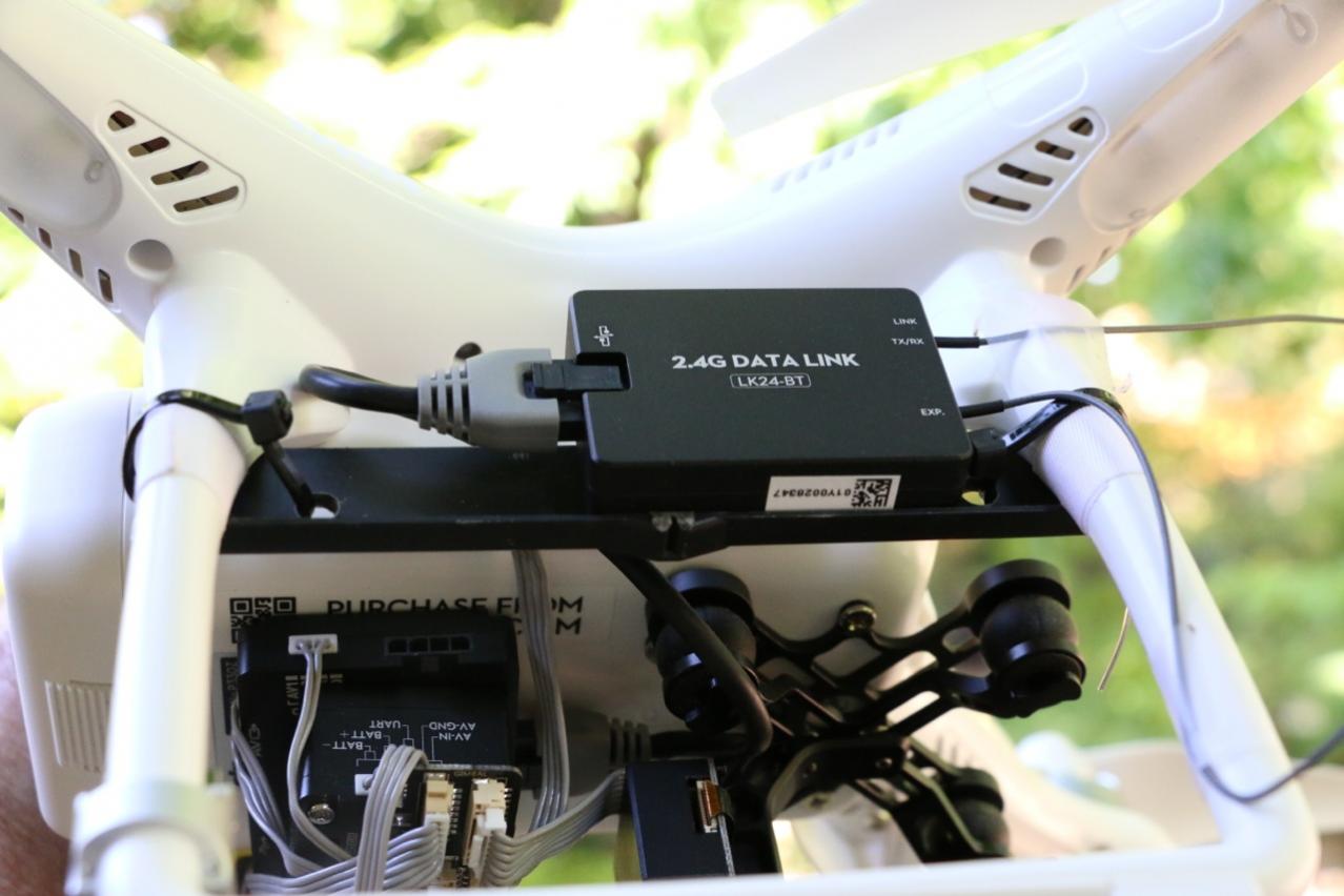

Pics of 2.4 Ghz Data Link mounted on Phantom 2
Eric,
Glad the video was helpful. I'm open to requests/suggestions for additional videos we could share to help people use the GS interface.
I've attached pics of the Data Link mounted on the legs of the Phantom 2 using a piece of scrap plastic channel. The Data Link is servo-taped to the channel and the channel is cable-tied to the legs.
John

That's a neat solution to the mounting problem John. I have placed the datalink centrally on the base of my P2 with my Immersion transmitter velcroed to it leaving no room for my iOSD. I think you have worked out a better solution and I will try to emulate.
