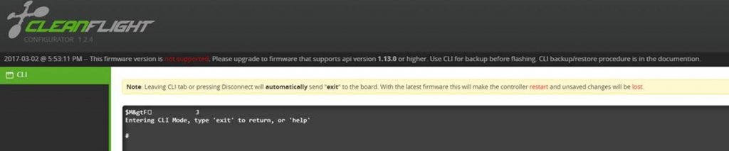

I just received my ImmersionRC Vortex 285 yesterday and Cleanflight gives me the following error. Anybody know how to fix this?

It's not an error, just a warning. You're in the CLI (command line interface) and it's telling you that if you make changes then leave the interface, the changes won't be saved. If you make changes and want to save them, you have to type in "save" at the box in the bottom and hit enter.
