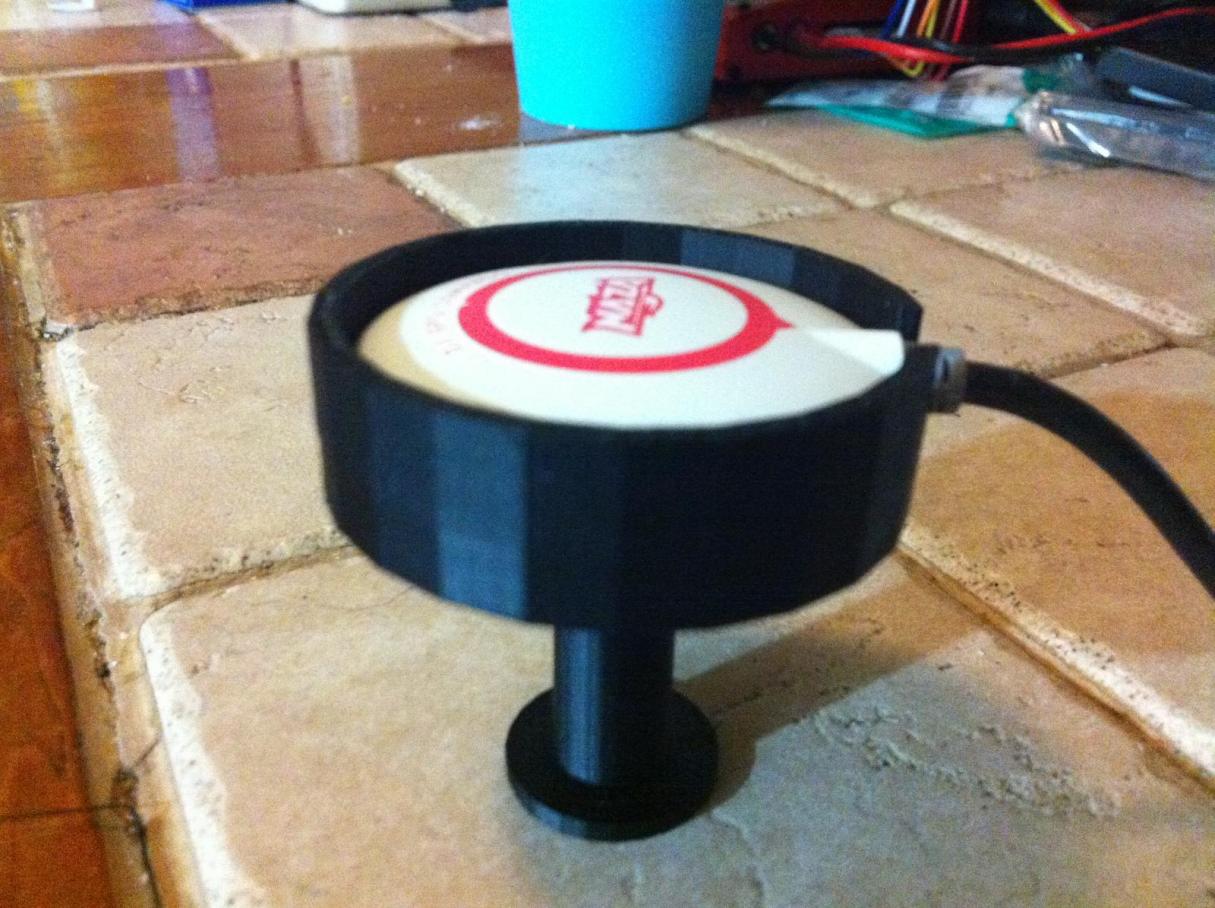

2. Search for a user "wdelarme" on RCgroups. He sells a replacment DJI GPS mount that is the best I have seen and completely affordable (pic below). I fly FPV, so I shield mine with copper tape and a ground drain.

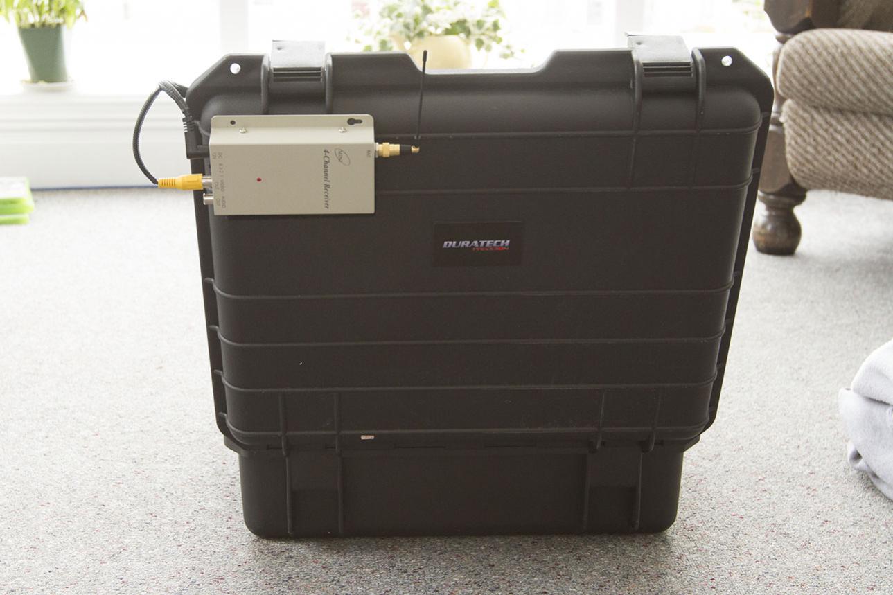

4. When using your ship for FPV, always use a seperate battery for your video downlink. Never use a tap to the main flight battery. If you are powering anything additional form the flight battery, use a good voltage regulator set to the proper voltage.
