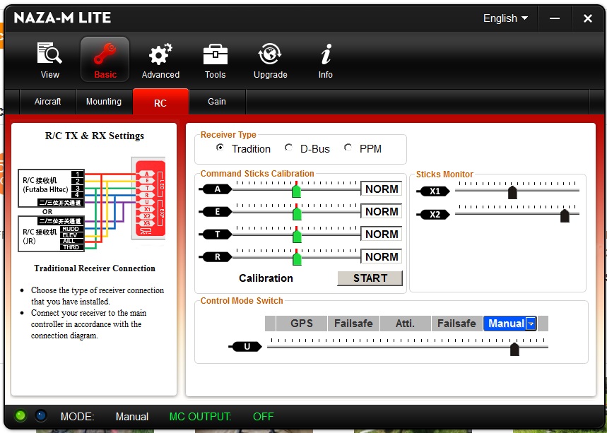

Radio CH5 to NAZA-M Lite U needs to be setup to a 3 position switch OR two or three 2 position switches, you do this with your PC.
You will need to able to select Manual mode, Atti mode, GPS mode and Failsafe mode with your radio switches.
CH6 to X2 for the IOC modes: Course Lock and Home Lock.
Power up Radio and power up NAZA-M Lite F/C and then connect USB to PC. then open the PC NAZA-M Lite program and wait for it to connect.
Should see different numbers when connected. You will need to calibrate your radio stick and make proper setting using your PC and radio setting to match each other.

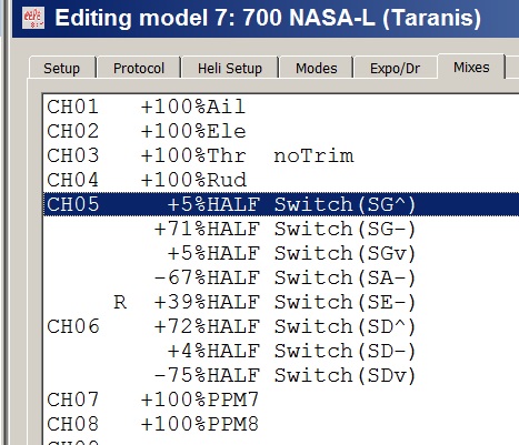

I use CH5 for U and use three, 3 position switches for Atti mode, GPS mode, Manual mode and Failsafe mode.
And then I use CH6 for X2 and use it for the the IOC modes: Course Lock and Home Lock.
The Radio I am using is the Taranis and I use erSky9x firmware on it.
The Taranis has mostly 3 position switches.
I am using the FrSky TX/RX which I using the 8 channel receiver.
CH5) Atti Mod, GPS Mode: on switch SG
CH5) Manual Mode: on switch SA
CH5) FailSafe (Home Return): on switch SE
CH6) Off, Course Lock Mode, Home Lock Mode: on switch SD
Channels 7 and 8 are being used for FPV Head Tracking.
