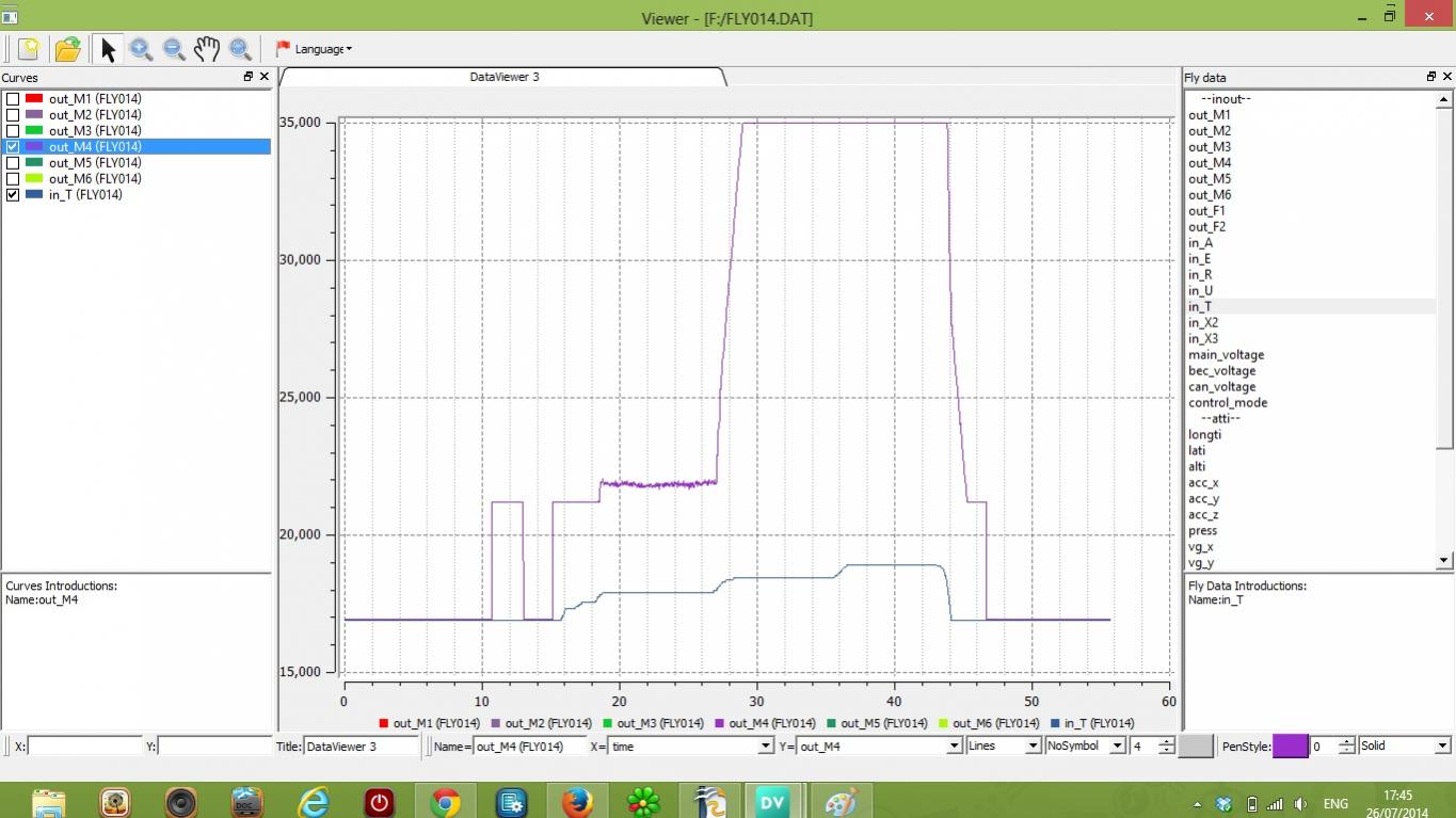

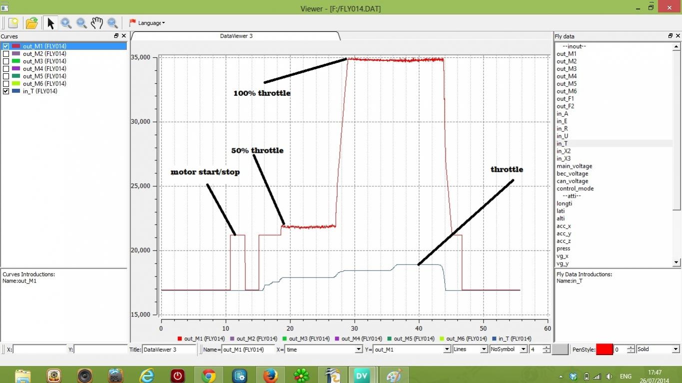

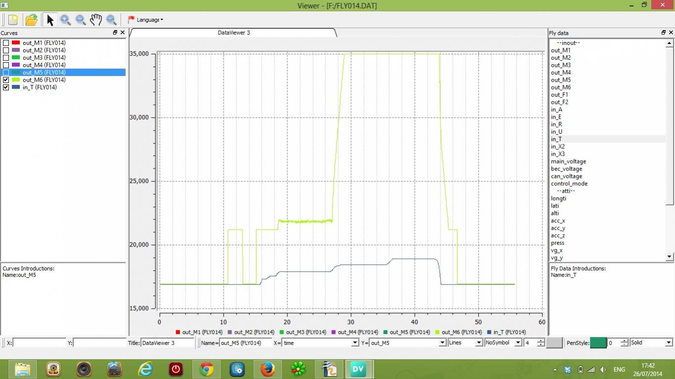

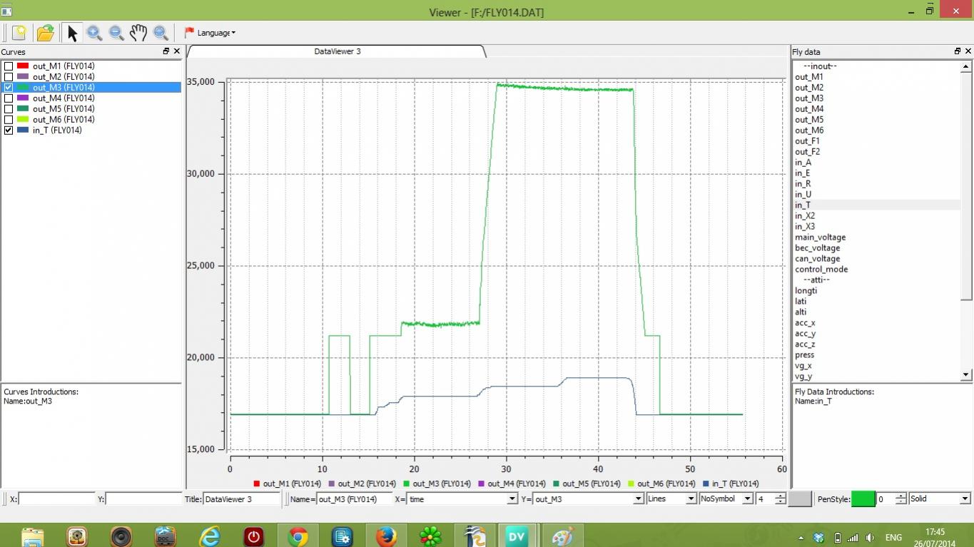

Right, was having a little play just on the bench and the IOSD and you can learn quite a bit from it actually.
Here are the images of the 6 motors at 50% throttle then going upto 100% (without props) and the throttle data.
Notice the CCW motors (M1,M3,M5) at 100% compared to the CW ones, wonder why that would be?

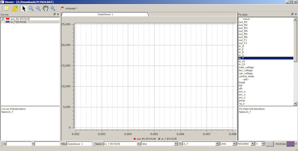

A question... are people running the IOSD assistant under Windows 7 or 8 and 32 bit or 64 bit. I'm running either 7( mac/Parallels) or 8(MS Surface Pro) but always 64bit, the X axis shows a very small number and data plots don't seem sensible. Putting a multiplier on the x axis makes no difference. This happens with my own files and the examples posted in this and other posts.
attachment.php
any ideas what to do? ... other than get another computer!

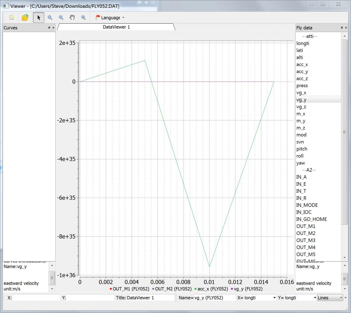

https://www.dropbox.com/s/8wrju3dh8jlg1w5/FLY052.DAT
Its a bit big at 60mb. Actually all the files are pretty big, it took several hours for them to download so big opportunity for corruption.

The good news is, you don't need a new computer.
The bad news is there is something wrong with your IOSD files.
I take it its the IOSD MK2 and not the mini or something.
I have read that it has an sd card built into them, so it may be bad or something.
How is it set up, you do have a canbus cable going from it into your GPS..right.
You are correct though there is something wrong with your x timeline it is only showing .016 when 1 is usually 1 second I think.
I see it is also the A2 which looks diffferent than the Wookong files.
Maybe TahoeEd could shed some help, but for sure you have a problem with your files and not your PC.

I was pretty sure it was the files. I'll check the iOSD connections but since we get the correct displays on screen I'd assume all is well there. Duff memory card is a possibility but I can't get any file to open correctly. The A2 started on v2.1, missed out v2.2 and is now v2.3. It doesn't matter what version the files were created under they act the same. A possibility was that the download thru the USB from the IOSD was bad. I did it on a Mac under Parallels which is usually OK. It was the first download and contained 4 months of data. The file sizes range from an average of around 50mb to a maximum of over 200mb. Not sure if there's any significance in that.
