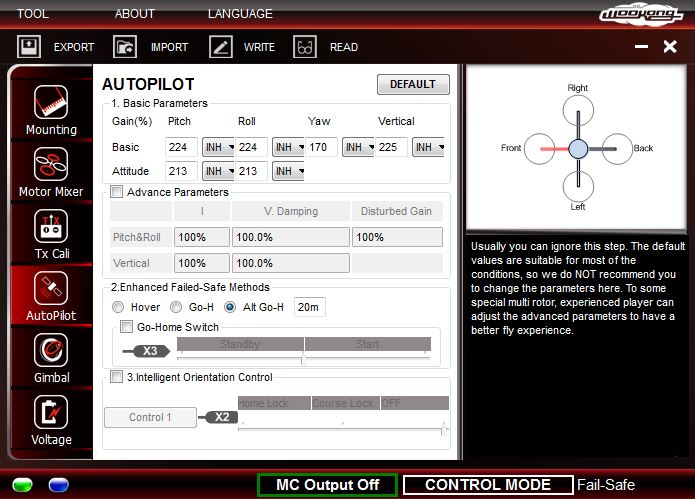

hate to be that guy here but im running out of ideas....i have a wookong m 5.20 on cinestar 6 frame with the quadrocopter engines hobbyking 30a esc simonk 14 in apc slow fly prop......i have dialed in my gains so that she sits solid as a rock in atti and gps ...but as soon as i get it moving she twitches very little bit once she has returned back to level ( not oscillating)...while in a glide...this happens alot too when some wind hits the frame... even light wind....while she does do her best to stay in her place in the sky...shes really finicky about it...gains are basic 190 190 220 120 atti 130 130...my cog is good i recheck it all the time..my compass has successful calibration everything else works fine...just in the wind shes twichty...and in atti mode once back to leveled flight and in a glide she twitches and sometimes she doesnt...if anyone has any ideas..they are greatly appreciated...im going to change my props tomorrow and see if that does it..... IMU is mounted so that nothing is touching it with vibration dampeners on the pillars so it cant be vibrations...anybody else having this issue?

For me your gains looks a bit high and props propably too big. Wkm has never been a good friend with slow flyers, have you tried different props? Xoar 12x6 or 13x6,5 would be better choise dependening your payload.
