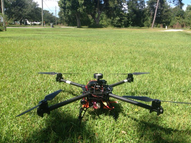

Having some trouble with a new quad oscillating and wobbling pretty heavy on descent. This is while descending straight down, and at an angle while moving. Wondering if anyone has any idea of how to solve. Below is my setup and possible ideas...
-Quadframes Carbon Fiber 770mm
-Tmotor 700kv U3
-12 Inch Cf Props
-30a ESC (SimonK)
-Naza v2
-Zenmuse
The naza is brand new just setup. Everything calibrated, the rig flies smooth in most directions. But when I descend at pretty much any speed I get some crazy wobbles, oscillation, and the copter sometimes will yaw on it's own.

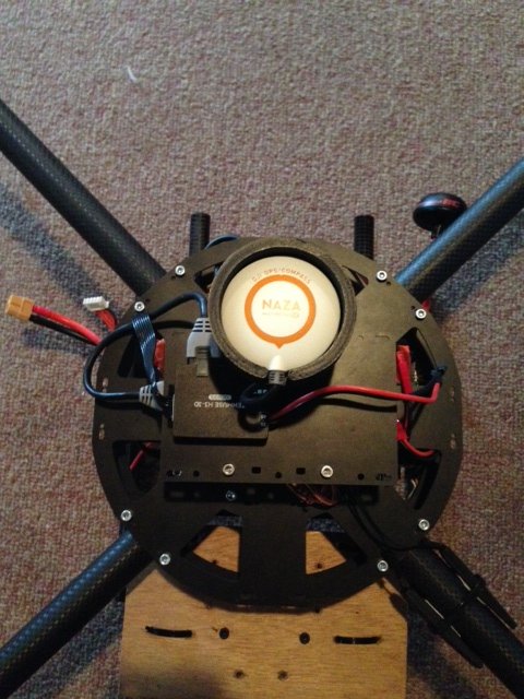

PCM, can you post a photo of your setup? I had a real issue when the Naza was too low on my centre of gravity. From that experience, I'd imagine that there would be similar issues if the Naza was mounted too far ABOVE the centre of gravity as well. It may be a positioning thing, and not a tuning thing.
Also - kind of goes without saying - but make sure your Naza is tied down tight. And that you don't have any other cables/etc lose that could be causing vibrations or shifts of mass.

Below I have pictures of my naza. It is mounted on the middle plate and I have my Zen GCU on the top. Along with the GPS. I have my Naza velcroed down but I'll try some 3M tape instead and see what happens.
My guess is I may be underweight and need a bit smaller frame & prop. Maybe 11" on a 650 frame. These motors seem to be asking for more. Wondering if that's causing this crazy tilting when I yaw
