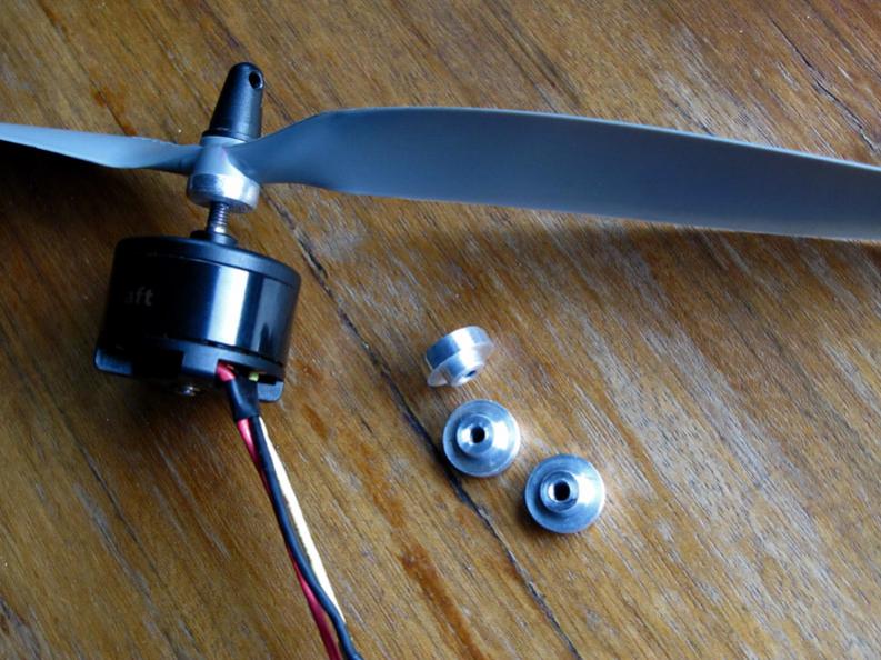

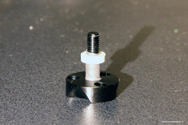

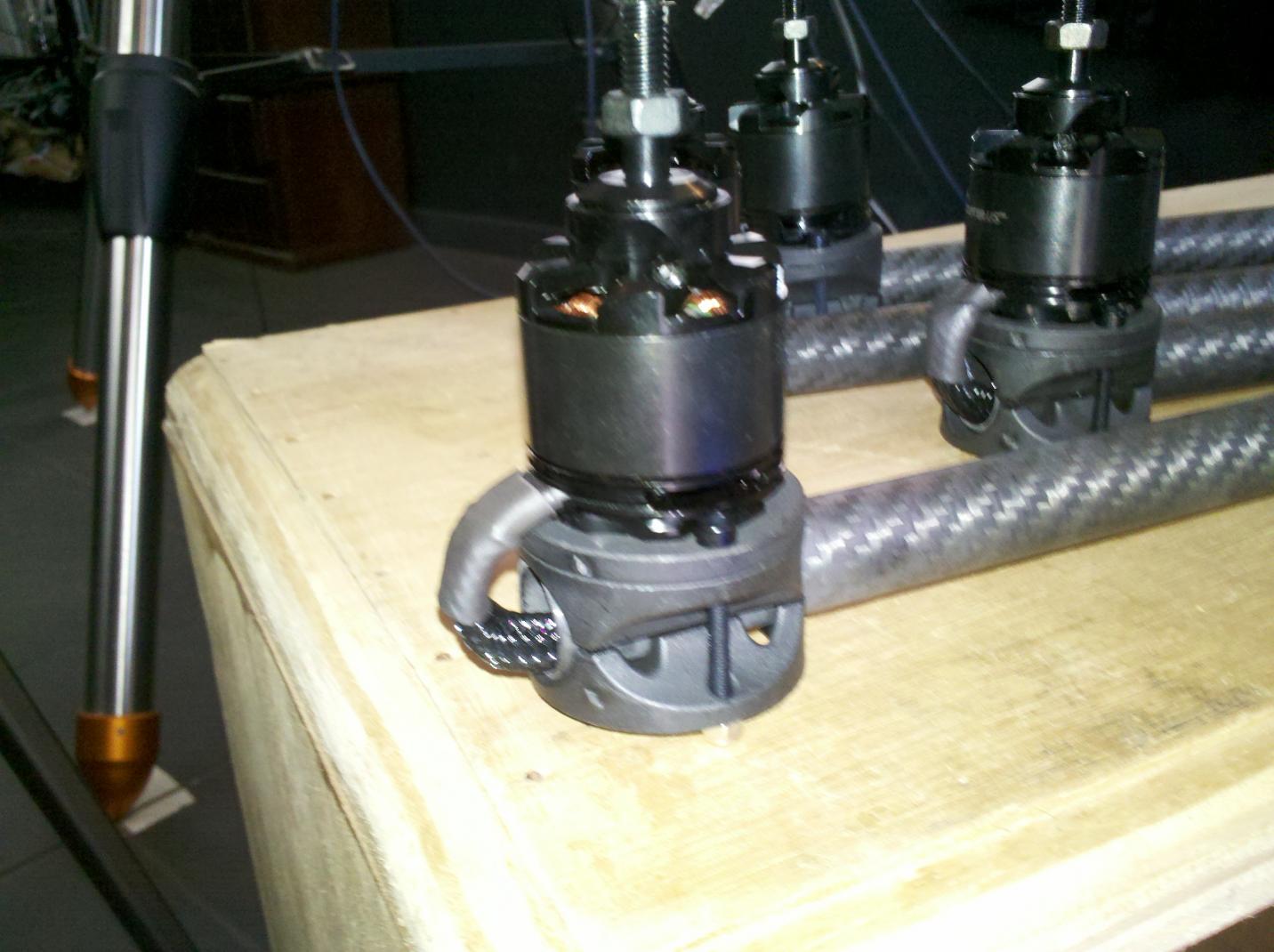

I wanted to mount ordinary props on the threaded shaft of xaircraft motors.
A dificult task. First I tested the common adapters, as you can see in first picture.
Not good. The prop fitted too high in the shaft and I believ that the adaptor sleeve would sooner or later damage the shaft thread.

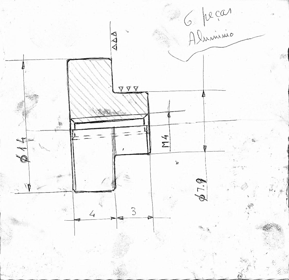

So I made this draw of my version of a good adaptor and had it made in a mechanical office.

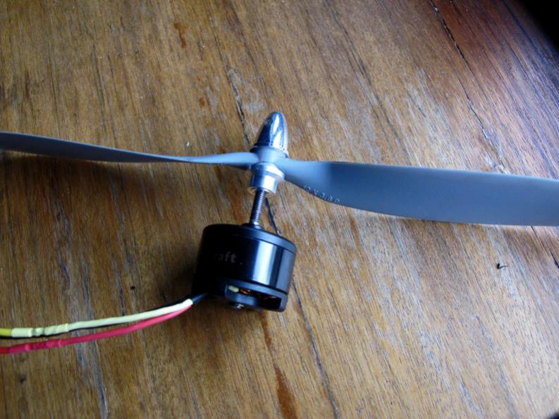

And see what I got.
2 grams adaptor. In the right place. And for less than 2 euros each.
Hope this helps someone.
C. Monteiro
