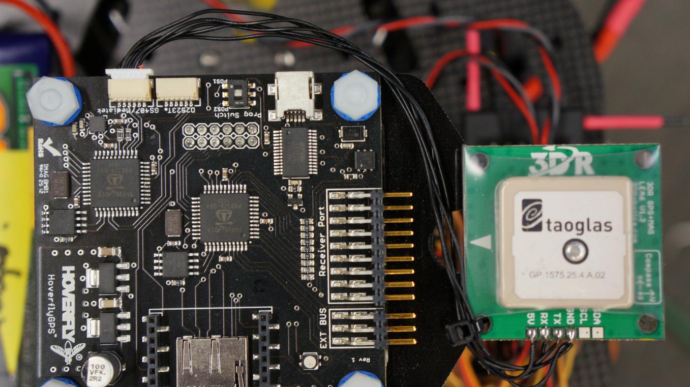

  • the modified Hoverfly PRO/GPS system is using the new LEA6 GPS antenna from 3DR, https://store.3drobotics.com/products/3dr-gps-ublox-with-compass
  • install the new antenna with the white arrow pointing forward and the square GPS receiver facing UP. the GPS board will automatically adjust for declination so there's no need to point the antenna anywhere other than straight forward.
  • a firmware update is required for both the PRO and the GPS (I think it was called ubloxBeta or something like that), both firmware updates are considered "Beta" to be used at your own risk (as is this review)
  • the HF PRO/GPS isn't using the magnetometer that is resident on the new GPS antenna so if you haven't done the external-mag modification, and if your wiring isn't very clean allowing for magnetic interference then you might still have issues with the HF GPS performance ( I still have some HF GPS mounting kits available that lift the GPS board 2" off the PRO board to help minimize interference from the surrounding electrical environment, it's an option instead of going the external-mag route)
  • compass calibration needs to be redone after doing the mod and installing the Beta firmware
  • the process of trimming and then setting the trim into the PRO (I forget what the procedure was referred to) needs to be done and done well. if the heli isn't trimmed just right then the non-centered heli will fight against the efforts of the GPS to hold position making it appear as it the GPS is at fault.
  • in the photos below you'll notice the red wire from the GPS was clipped and there are two wires going to the ground position on the new antenna

View attachment 16874View attachment 16875View attachment 16876
Bart
