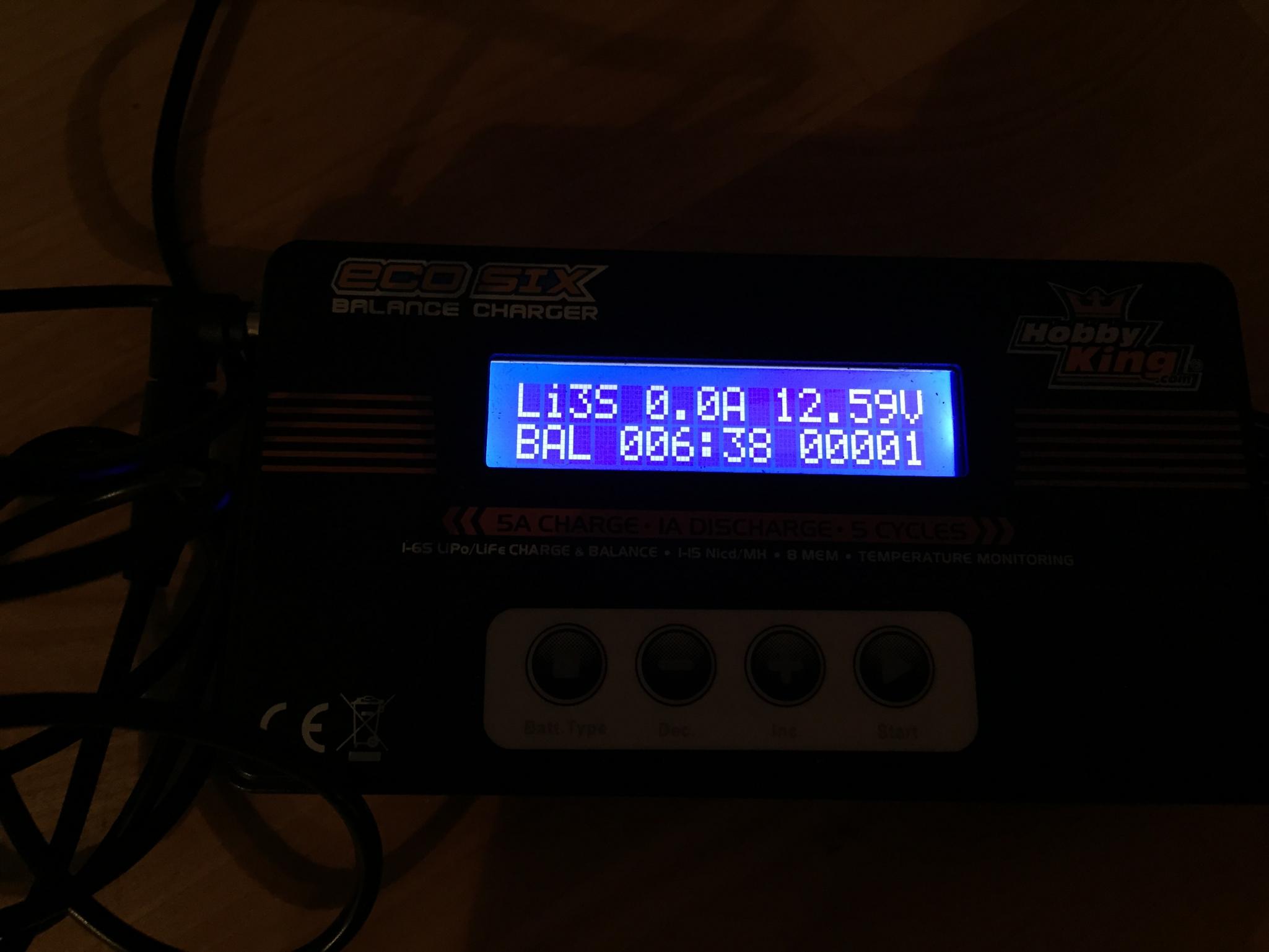

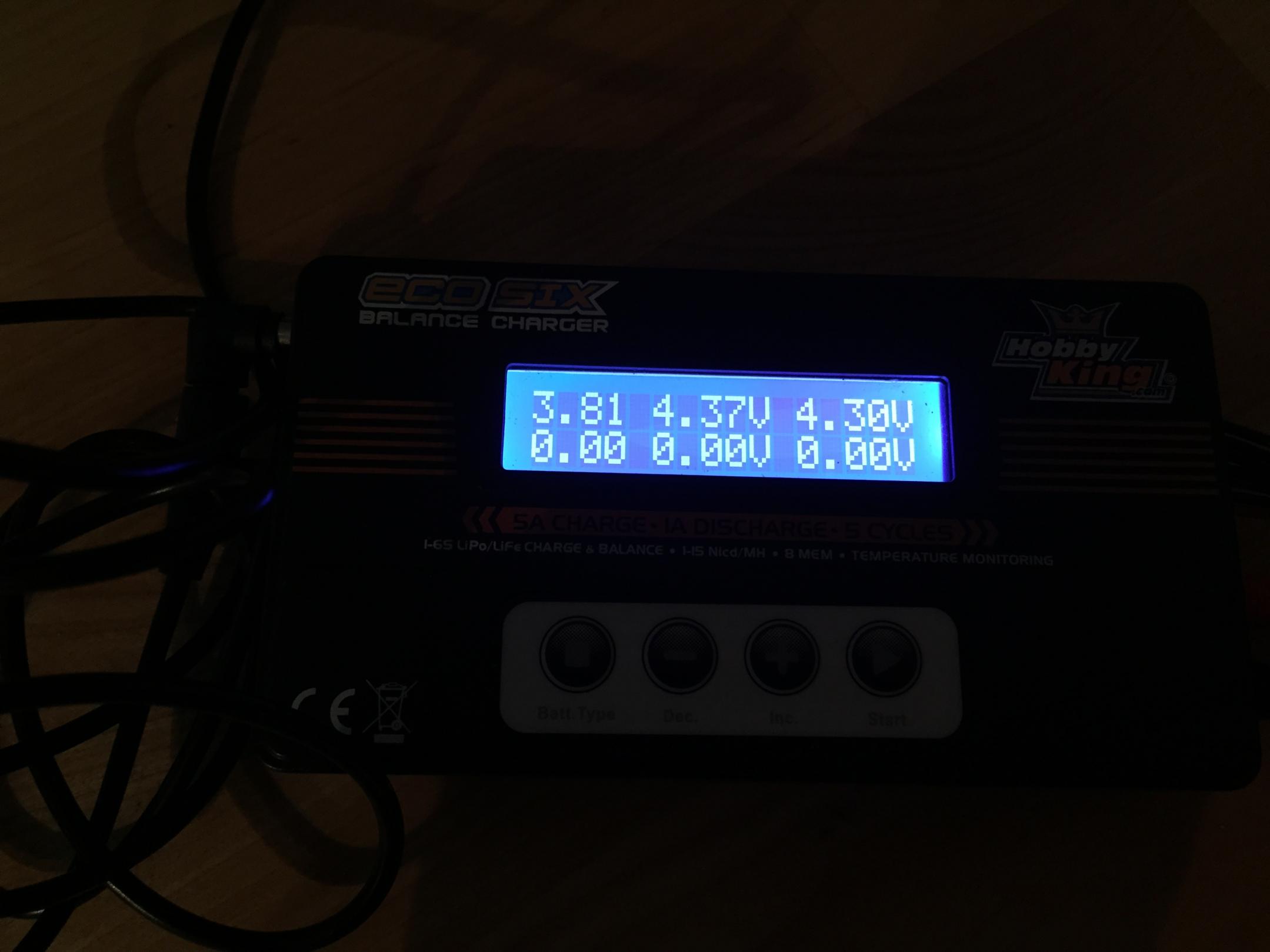

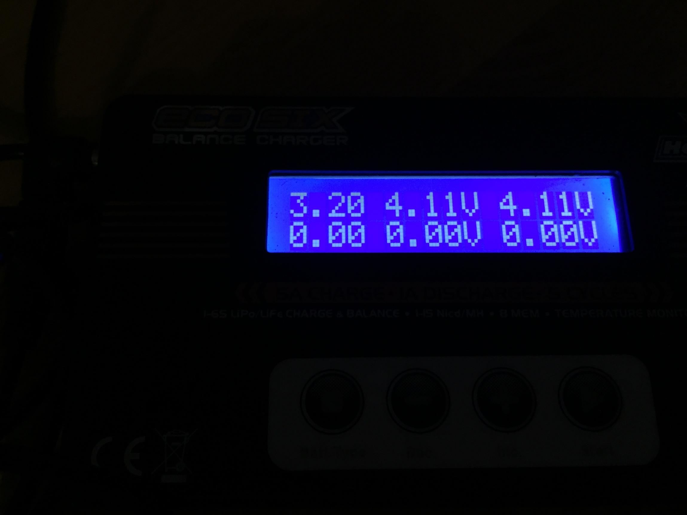

Thanks guys for your help. Im still trying to figure this out. I can't seem to change how much goes into the lipos, it just automatic. These 3 pics might help. One is right after the quad beeped and I was loosing powers (forward to keep it level i had to push all the way forward then even that didn't work...this was inches off the ground). If you count up the V is more like 11.4 left in the battery but the quad beeps at 10.5 and i felt the power dropping. The other two pics show the lipo at almost full charge. It balancing and one cell is catching up. This charger is a mystery to be honest. Its shutting off and beeping now when it says 12.09V and it charged from beeping quad to beeping charger in 7 1/2 mins!! Weird!

Isn't 4.37V way too high? I though they're all suppose to be 4.2V!
Im going to try to balance them all to 4.2 and then run the timer again to see if I get more that 3min 30secs flight time. The quad lost power when the cells read -
3.2 4.11 4.11
That does not look right to me!
Carapau
It looks like you have a goosed cell hence the probs. if you can't get all 3 to 4.2v on the charger then best to bin the battery and get a new one I reckon

For 40 mins now its been hanging around 3.76 4.20 4.21
Wont balance!
