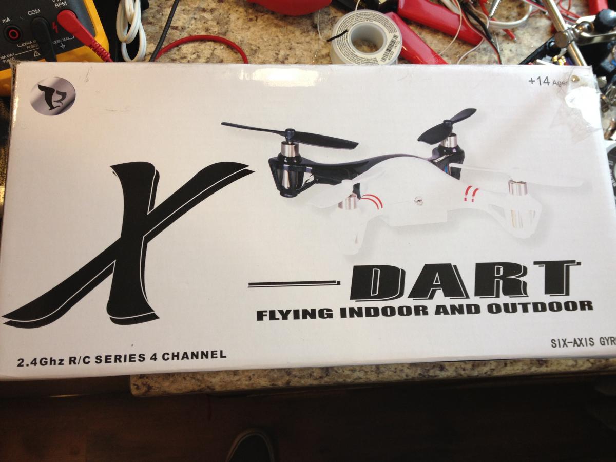

I bought one of these cheapo X-Dart quads from HobbyKing($19) and didn't realize it was a Mode 1 (throttle on the right). Since I have no intention of learning Mode 1, I decided to tear the transmitter apart. The Mode 2(throttle on the left) hack was actually fairly easy. This does require some soldering skills.
