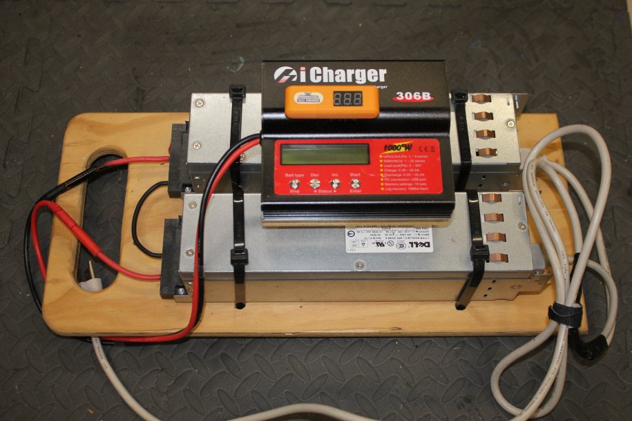

The best you can do when trying to save money on a charger, IMHO, is to save by using the computer server power supplies (available on eBay) while still buying a high quality brand name charger. Here's a pic of my set-up using two Dell power supplies in series to get 24 volts but with an iCharger 206B. Probably not what you wanted to hear but a low quality charger can destroy your expensive batteries and maybe cause a LiPo fire. I've heard of other HobbyKing chargers lasting only a few charge cycles. The iCharger 306B is about $160 and with the two power supplies it's around $180 depending on what you pay for the power supplies.
Probably not the reply you were looking for, sorry!
Mactadpole
Hey Bart,
I use those supplies for my cheap chargers now and I should just upgrade to a few of these more quality chargers for myself.
I really wanted to find some decent self-contained AC/DC chargers for the organization to take to them. At their two field stations all they will have access to is two truck batteries hooked up to a solar charger with inverter. Their other option is to walk 45 minutes into town and plug their charger(s) in at a local internet/phone cafe or tienda to charge the batteries. I'm try to find something that is small and self-contained to just make things easier. I might just go with two of the iMAX B680AC (AC/DC) and they will just have to deal with a slower charger cycle. One of these was my original charger and it has worked flawlessly for many years, even though its a slower charger.
Sorry for derailing the thread a little.:oops:
